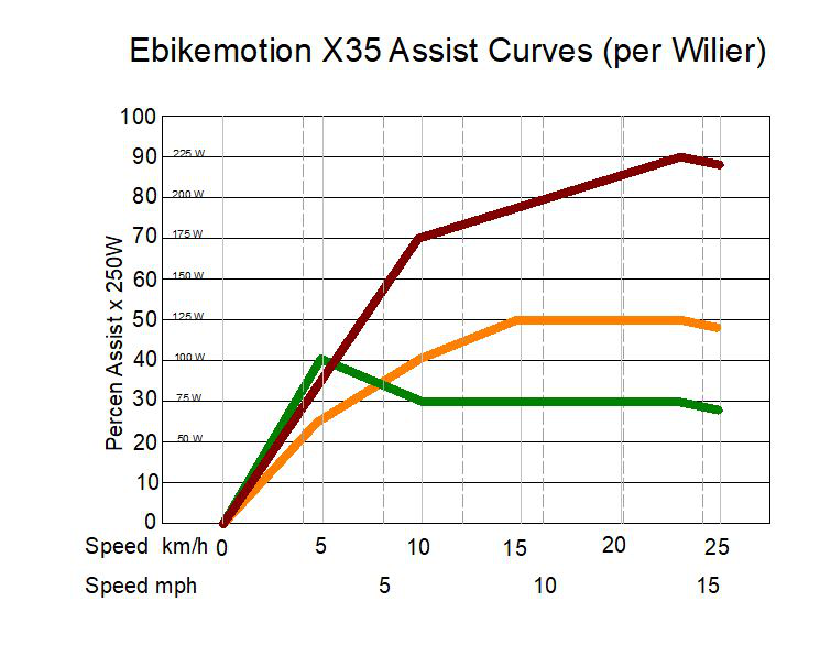

- X-35 – Relies on speed to determine the amount of assistance. (The chart is a reconstruction of that EBR member Wilier Trestina obtained from Wilier and posted on the EBR forum.)
Given that my climbing speeds can get down to the 4-6 mph (6-10 km/h) at 40-60 rpm, the X35 motor would boost my 125W by 100-175W at peak assistance.

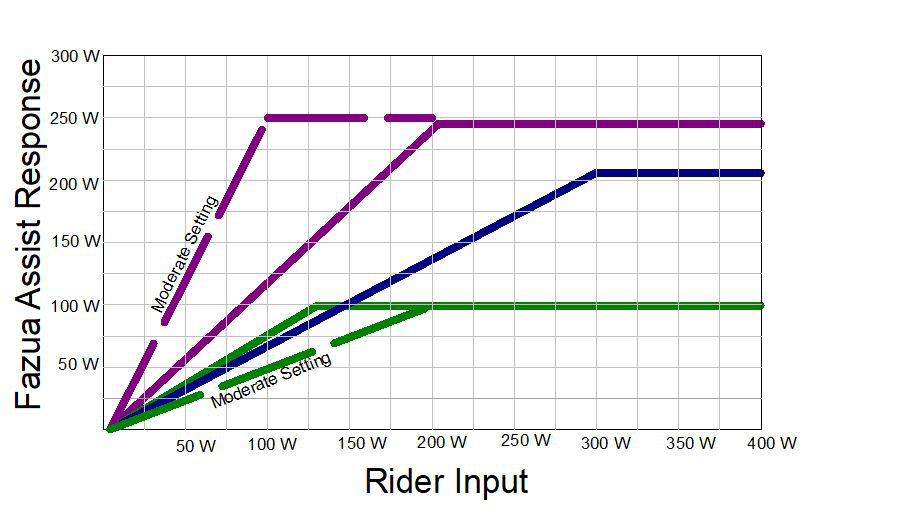

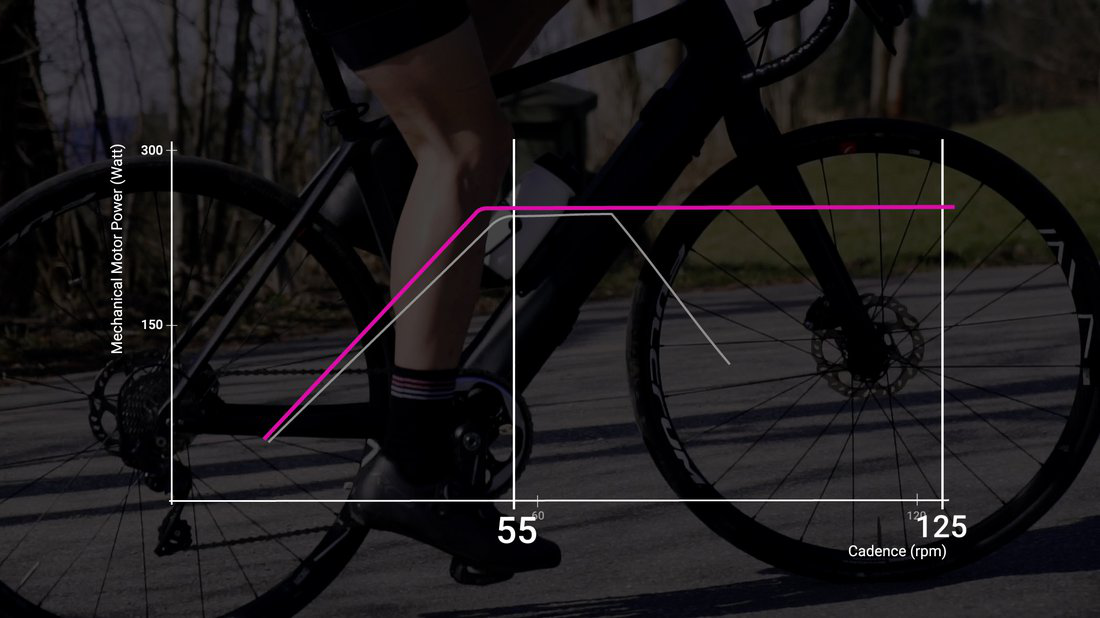

- Fazua Evation – Relies on cadence and rider power/torque input to determine amount of assistance. The charts were adapted from the Fazua site.
The Evation motor would boost my input by 150-250W based on cadence, fully 250W based on 100W of input.

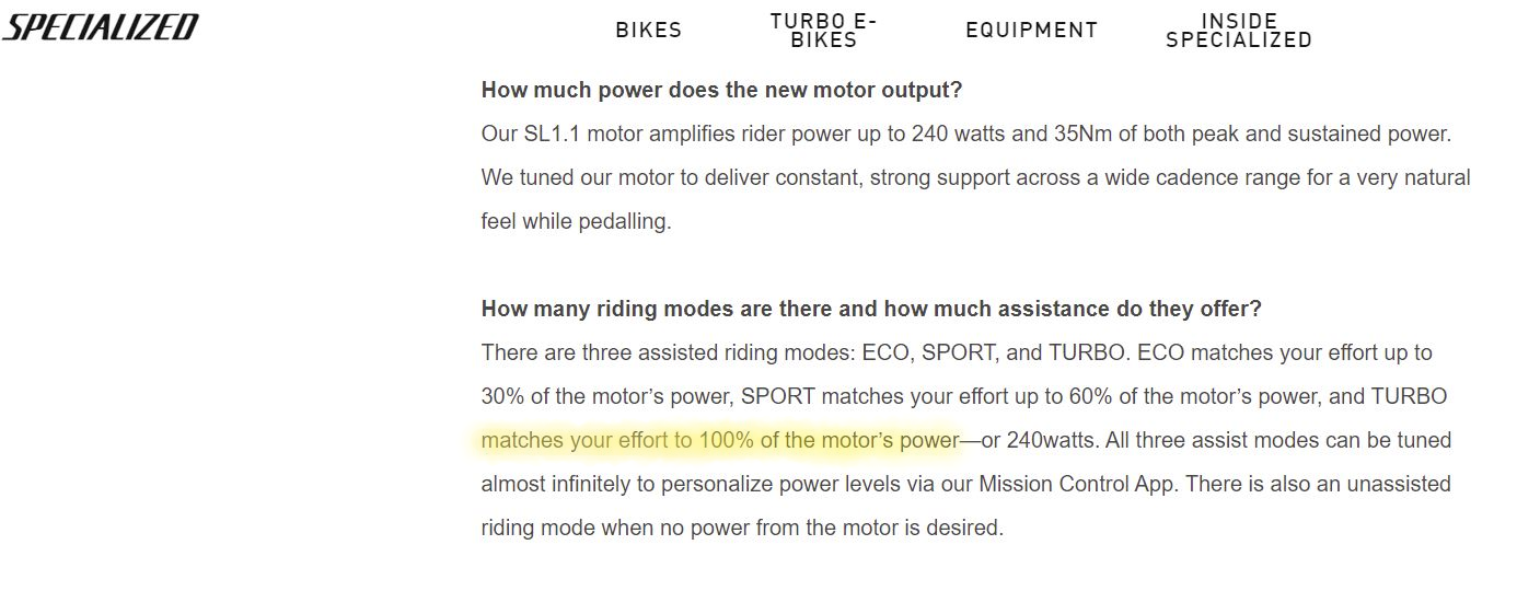

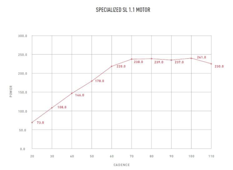

- Specialized SL1.1 – Relies on cadence, and rider power/torque input up to 100% assistance. The information was taken from sites dedicated to Specialized.
The SL1.1 would boost my 125W with a 100% match of 125W. Stronger riders would take better advantage, up to 240W at 70-100rpm.
