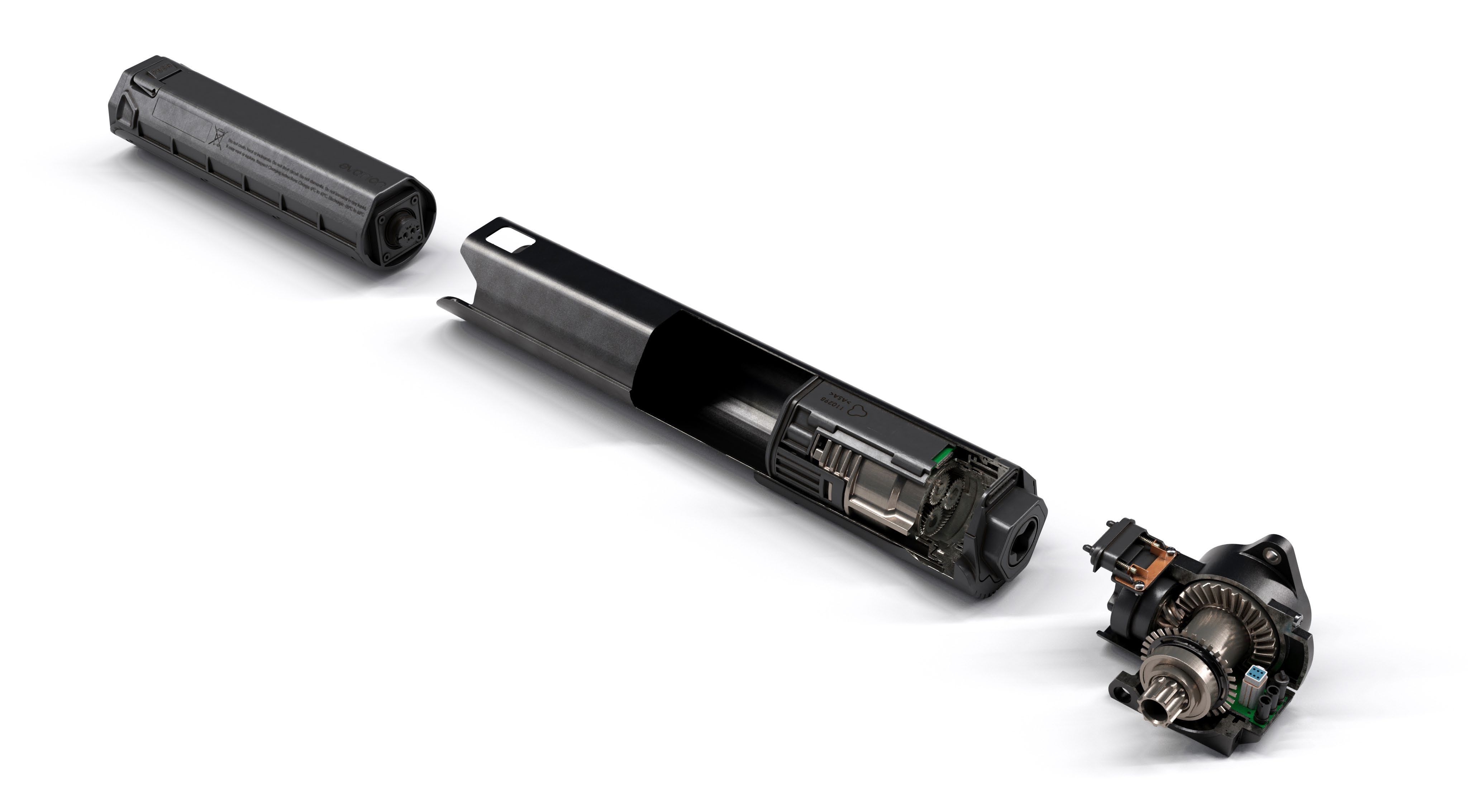

Fazua co-founder Fabian Reuter said Eurobike 2017 was when everything "exploded a little bit" for the company, as high profile brands like Focus highlighted the drive in concept bikes.
The Fazua motor fits neatly into the down tube.
"We decided to produce ten times more drive systems for [model year] 2019, which just started, than we had the year before," Reuter said. That led to a scramble for financing and employees. Reuter said production for MY2019 models began in May, and the company is delivering on time to customers.
"Right now — right in the middle of starting and producing our MY2019 orders — we are also preparing the upcoming model years 2020 and 2021, and we have to predict how many drive systems we think we can sell," Reuter said. "For this prediction, the U.S. market is a big thing for us."
But part of that depends on how quickly Fazua can receive approval from U.S. regulators for the drive system. The company also needs to find a U.S. partner to handle servicing for the Evation drive system. Reuter hopes to meet with potential service partners at Interbike, where it will have a booth.
"It would be best to have a very big partner, and service wherever you need it, and maybe a partner that everybody trusts," Reuter said.
One benefit for OEMs is that the Evation system mounts in minutes on an assembly line. The bottom bracket attaches with four screws, and there's only one cable that runs from the drive unit to the handlebar controller.
