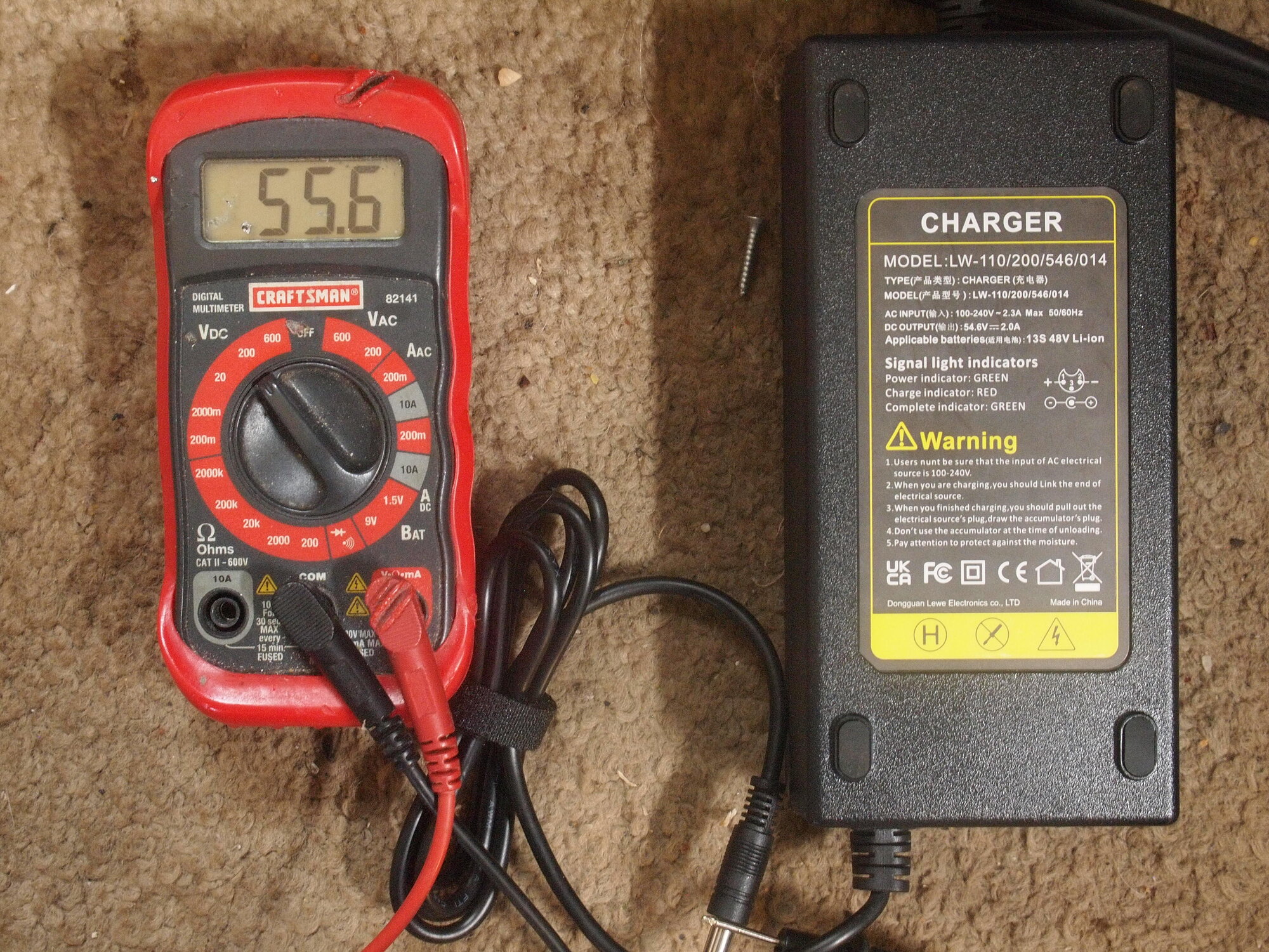

A friend brought me this charger, fresh off the ebay pipeline. It's over voltage at 55.6V, Gotta go back.
There's two things that protect against overcharge. One is the battery charger and the other is the battery BMS. If you take away the first safety factory, well that's not good and likely to be part of the reason NYC has so many fires/
No trim pots in the circuit. Can't adjust.
This is why I won't have anything to do with 'factory' chargers or replacement chargers purchased from... anyone. With the sole exception being the Grin Satiator but that is a $300 buy-in.
Actually its only half the reason why. The other half is the failure rate of these things. Which you can change pretty much to zero by stepping off the path.
