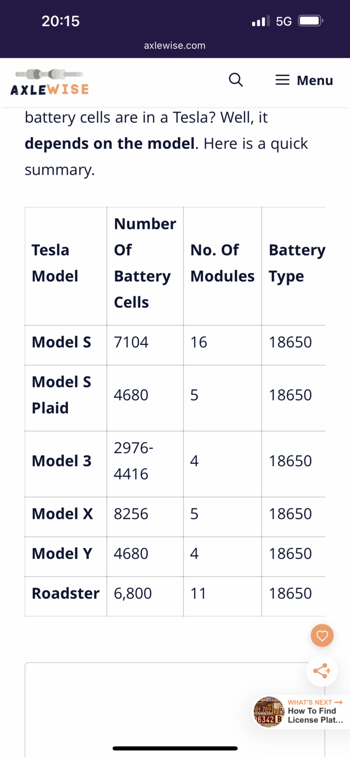

I agree, the prixe is right . Let's round it up to 2000$/800wh.
One top EV battery pack of 81 kwh has 4680 of 18650 cells @3.7v, 15 amps discharge, 4500mahs and it costs 9-10k.
U do themath.
Letmehelpuoutboomer:
It comes out to 123.45679$/KWH
Did we got punked by the Ebike conglomerate industry ?
Will u still click buy on that Giant 800wh pack for only 2000$ ??
Rmbr. i rounded up the price for ur safety and a flawless transaction.
U do themath.
