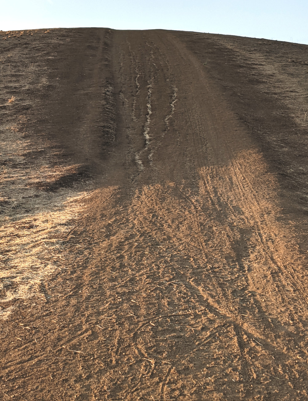

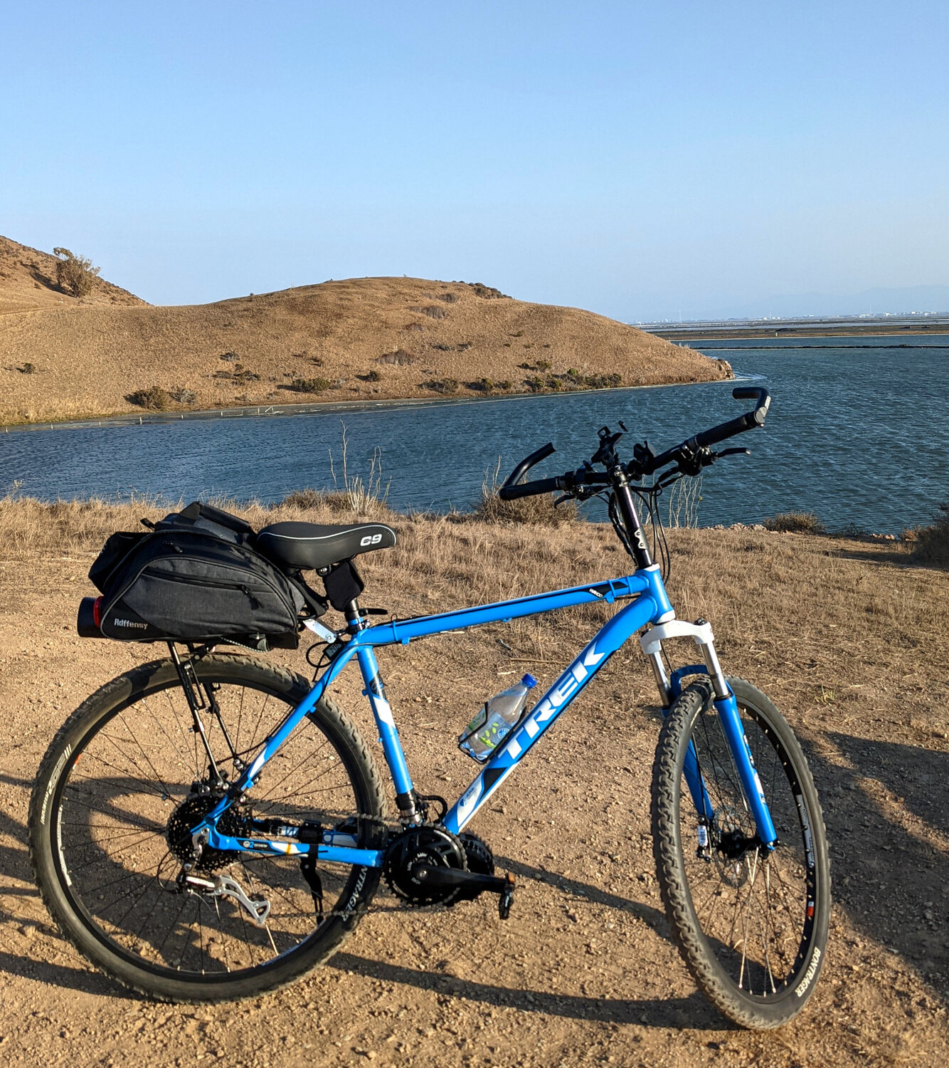

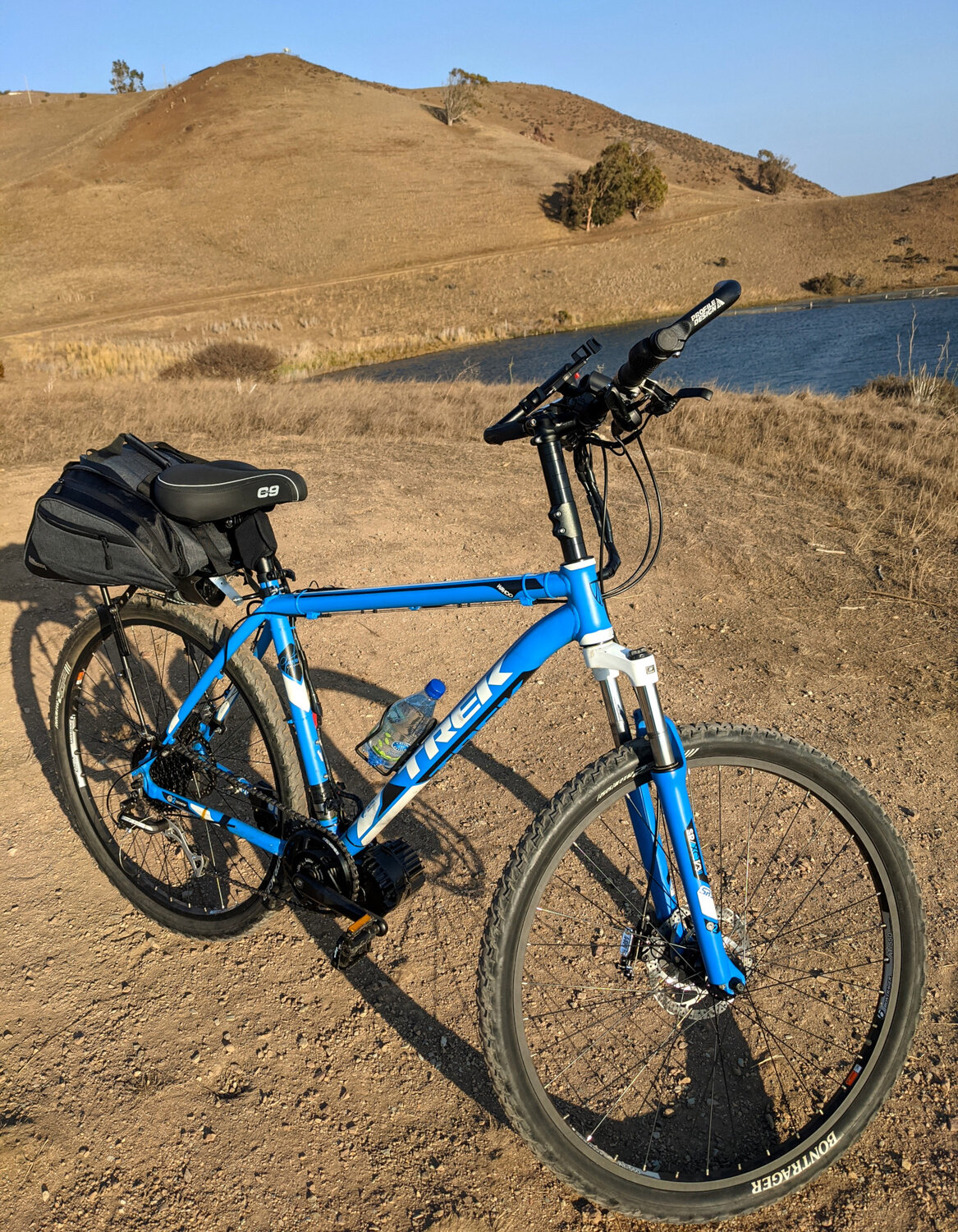

2012 Trek Wahoo MTB (Large frame, 29" wheels, 2.1" tires
- BBSHD mid-drive motor.
- Eggrider v2 display.
- 48v 14Ah Reention Eel pro battery from another ebike (mounted under rear rack).
- Sunrace 8 speed cassette 11-40T.
- Lekkie 42T narrow-wide chainring.
- Original Shimano deraileur and 8 speed shifter.
- Deraileur hanger extender.
- 180mm front rotor, 160mm rear.
- TRP Hy/Rd front brake (hydraulic, but actuated by cable).
- Tektro mechanical rear brake.
- Suspension seatpost, stem riser, kickstand.
I tested it on some hills (photo attached) in a local park yesterday. Very impressive even with "moderate power" programming.
