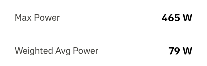

I had to do several very short but very steep climbs up the Vistula embankments yesterday. It was my 240 W peak power Vado SL in 42-51T gearing.
At such high cadence...
with such maximum leg power compared to the average. Trust me, I was maxing the motor out! 😃

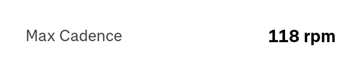

Stephans Mike, 118 is quite the high cadence! Even though I average around 90, and can spin 120 for a very short time, I'm still a bit of a diesel rider. I will grind power at a lower cadence, or gear up but still spin 90, if I want to go fast for a while. My lungs tend to give up before my legs give up 🙂
I usually stay a little above 80 rpm, and my mid-motor e-bikes appreciate that :) The 118 was a burst as I needed to climb a river embankment for several times. Such embankments are very steep but you only need to climb several metres up. Low gearing and high cadence made that possible, especially with the leg power burst and maxing a low power mid-drive motor out. It would be very difficult to do such a climb by grinding.
