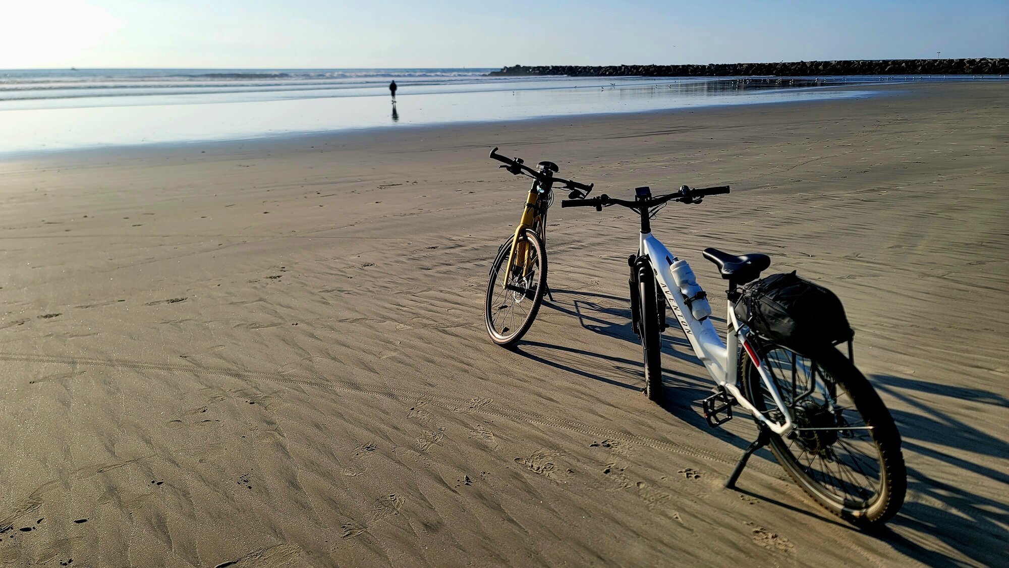

Regarding fat tires: They certainly have their uses, and they do look cool. But they're by no means necessary for many offroad purposes.
Yesterday's low-tide beach ride in Oceanside, CA with my friend's white Level.2 at lower right. He's running 2.3" hybrid tires here, and I'm on 1.5" hybrids.
That's him riding ahead with our tracks in the foreground. So little sinkage that I rode the whole 3 miles with my motor off. It's all about picking your sand. If it had been loose and dry, 4" tires might not have been enough.
Meant to tell you nice pics! Jealous!
