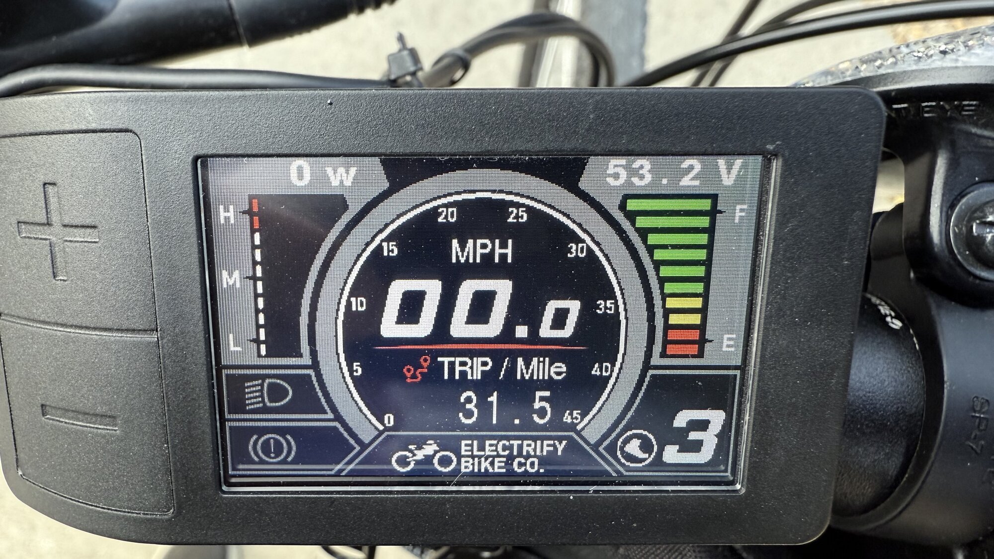

Here is photo after 31.5 mile ride...53.2 Volts and no change to the meter.
It's a lot of screen "real estate" for a meter that is completely worthless....just trying to make sure that I am not missing something in settings, etc.

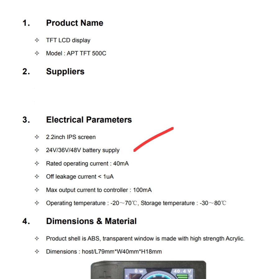

And are you sure it is set up for a 52v battery in the display settings... if it even has that feature as there could be different firmware versions.

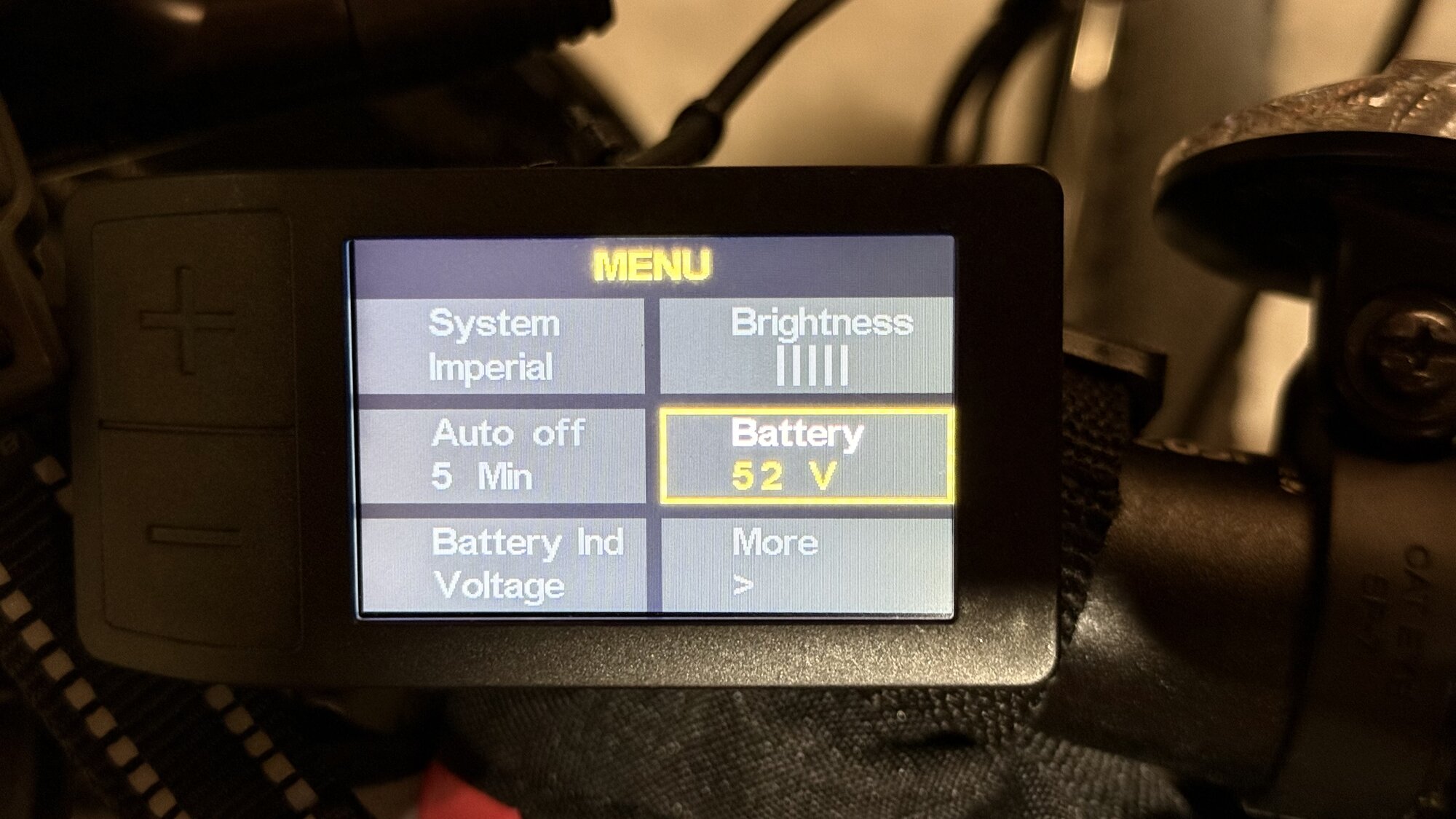

"....And are you sure it is set up for a 52v battery in the display settings".
Yes, here is photo of screen...definitely an option and has been set to 52v since I installed.

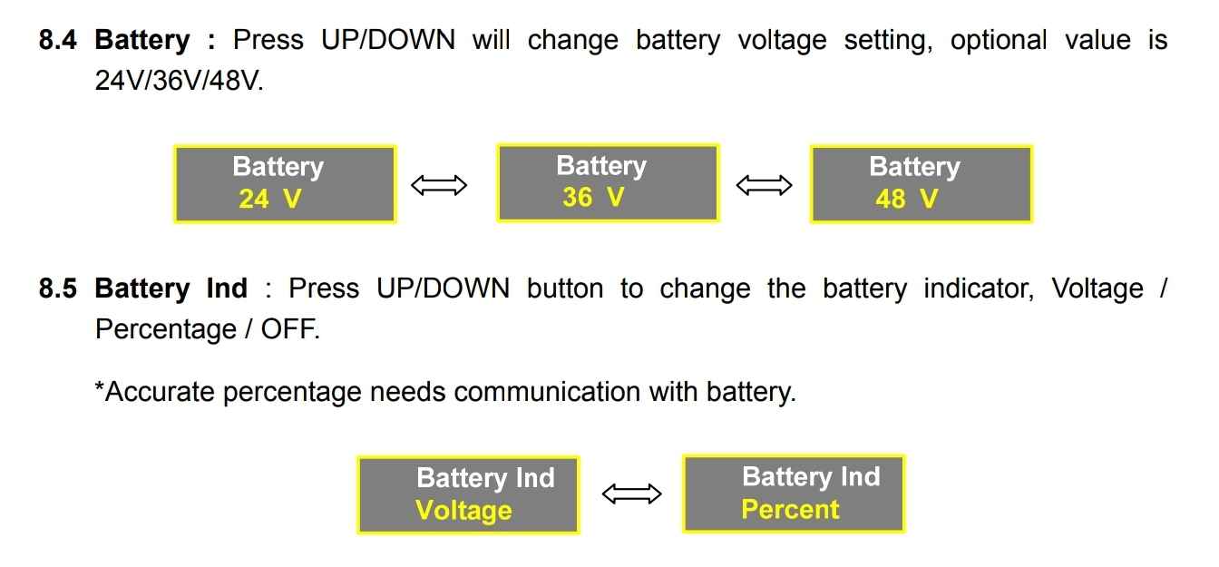

There is no calibration for them other than setting the correct nominal voltage.

In my conversation with APT the manufacture of the 500c and the 860c that I'm fond of... The information is coming from the controller and the display is just that, only a display.
So Ananda may be doing a better job with the controller and 3rd party batteries since they don't manufacture batteries themselves.
Speculating here, but..it seems as though the setting within the display to change voltages does not change the scale of the meter. To me, this is a software bug. Anyone know of any alternative firmware releases that work with this display? Or, any place where I can engage with Bafang (or, Luna as they use the same display)?
