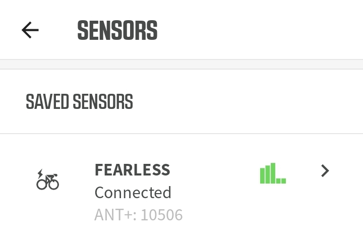

Extreme, can you see something similar in the ELEMNT App?
It should be one sensor, not three. If there are as many as three sensors (Cadence, Power, E-bike) please 'forget' all of them and start over. Wahoo is sometimes tricky in the beginning!
These three sensors are being 'folded' by Wahoo into a single item. It is different from Garmin, where three different sensors are displayed.
Marts is of course right.
Yes, I saw that. It was just one sensor, but everything I need came up on the Bolt screen. We’ll see how the mileage looks after I ride it for a few mikes to see if the Auto wheel circumference is accurate.
