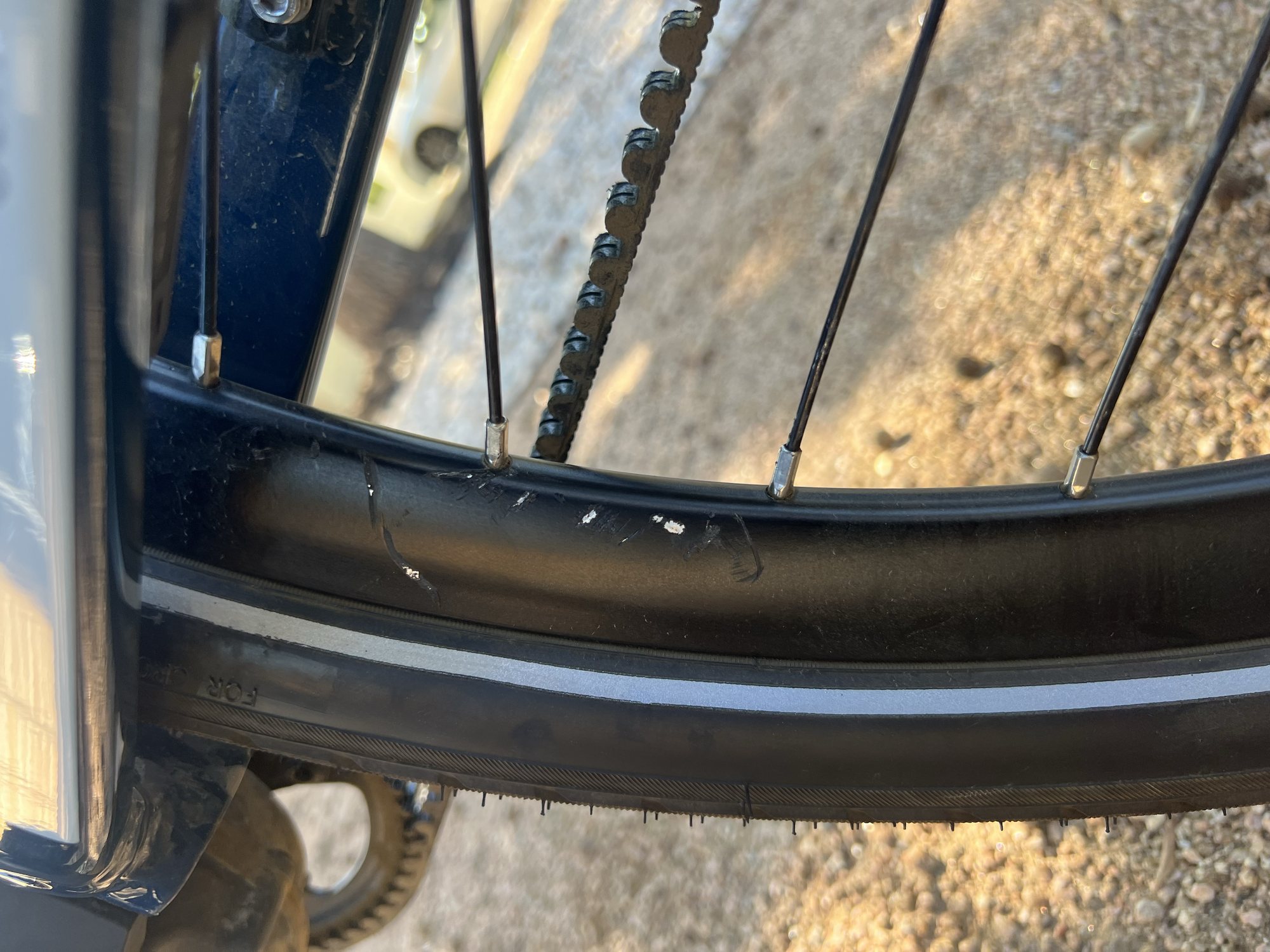

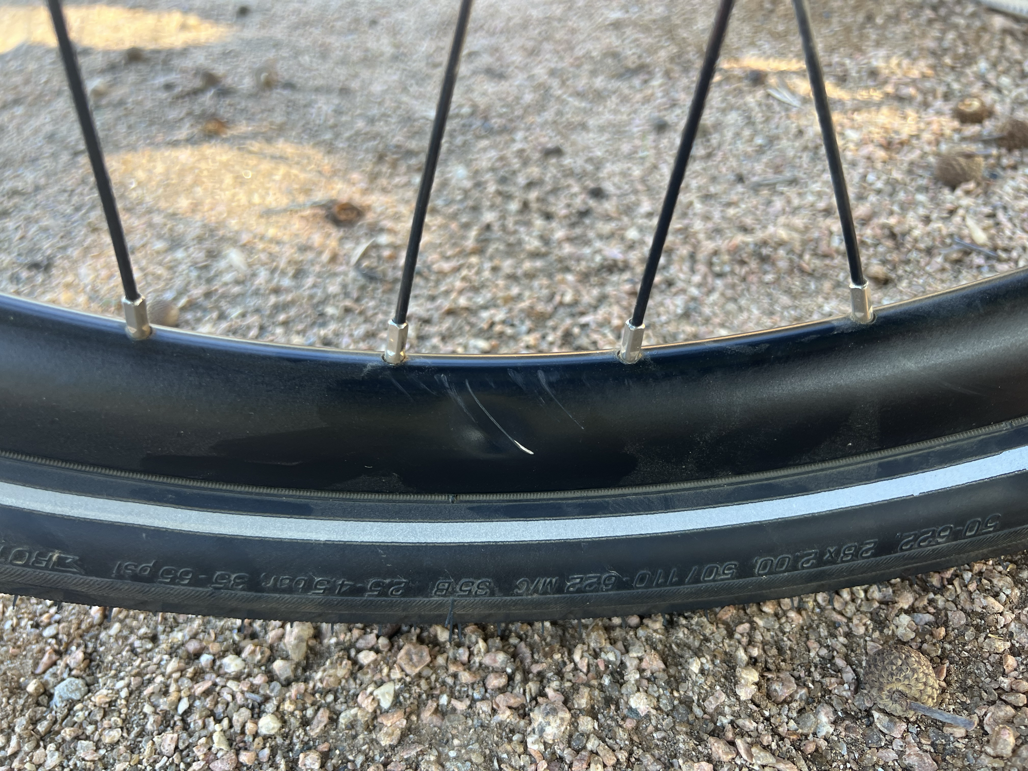

Here are two photos. It doesn't look like much, but I can't say how bad it really is.
The movers insisted they were professionals with moving bikes, and against my better judgement I let them do it. I found that they basically flopped them on one another in the truck. Broke both front lights but the extent of the damage. They agreed to pay for repairs, and given how careless the one mover was with just about everything I plan to take them up on the offer.
My buyer noticed the wheel damage (I didn't see it), and got a price from REI. ~$200, but 4 weeks lead time on the wheel!
Does this look safe? It rides like normal.

I'm guessing that's about 90% cosmetic damage with no sort of safety concern.
I'd ride ride on it, but I don't really care what my ebike looks like as long as it's functional and safe.
Maybe just accept the money from the movers and reduce your asking price by that amount?
I'd pull the wheel, remove the tire and check the inside of the rim. It looks cosmetic to me BUT I'd still check the inside. You should see my rims. They are all nicked up. I'm with PCeBiker as I could care less about cosmetic damage and Im also with Stefan Mikes in verifying the rim is 100% safe before riding. I've had a seam split on a bmx wheel. It hurt really bad when the rim folded.
