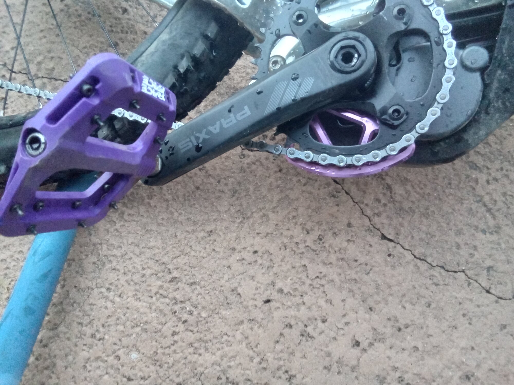

I whacked my Chainring pretty hard last weekend on Rock Garden trail. Nothing was damaged but I suspect it might be a matter of time. Anyone have a recommendation? I don't think an ICGS-05 guard will fit and probably need to use one that bolts to the Chainring?

I ordered one of eBay a week ago in Purple and it finally shipped today. I think ICGS-05 will fit, when I posted above it was dark in my garage and I didn't see the mount points. Once installed Ill report back.
Looking at this today. the ICGS-05 comes in many variants.
Do you have a link to the one you got?
most I have seen only go up to 34T.
Our bikes list a PRAXIS 36T online.
This is the one I bought, put it on and it fits and doesn't rub but I had to install over the chain guide on one end. Picked this one because it's Purple and 34T - 36T:
cheaper one off Amazon:
To confirm, you had to remove a chain guide to install it?
I like that bash guard....its $70 cheaper than the ones I was looking at haha
No I didn't remove the chain guide, just 1 bolt and used it to bolt the bash guard on over that part of the chain guide. It's clears the chain and sprocket, I was worried it might rub. Use loctite. Will field test this weekend with a ride, but think it will be fine. My old shock pump seal gave out after pumping up my son's Moro, we have 3, so I upgraded to the Rockshox 600lb pump for ~$30? It's a high capacity pump that raises pressure faster per pump. My old Pump I was pumping a long time to get up to pressure, once. Next bike, it lost pressure each stroke. Rear travel is 150mm and don't forget to select ebike and Lbs instead of KG, and don't exceed max pressure.
