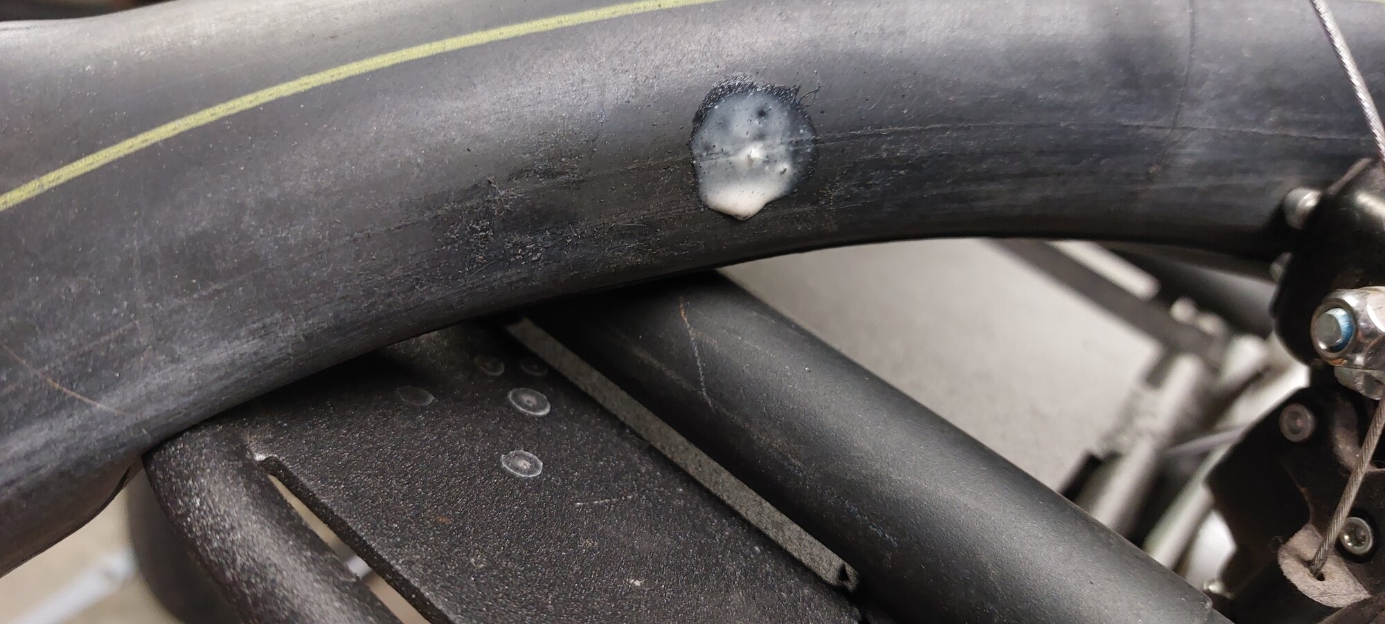

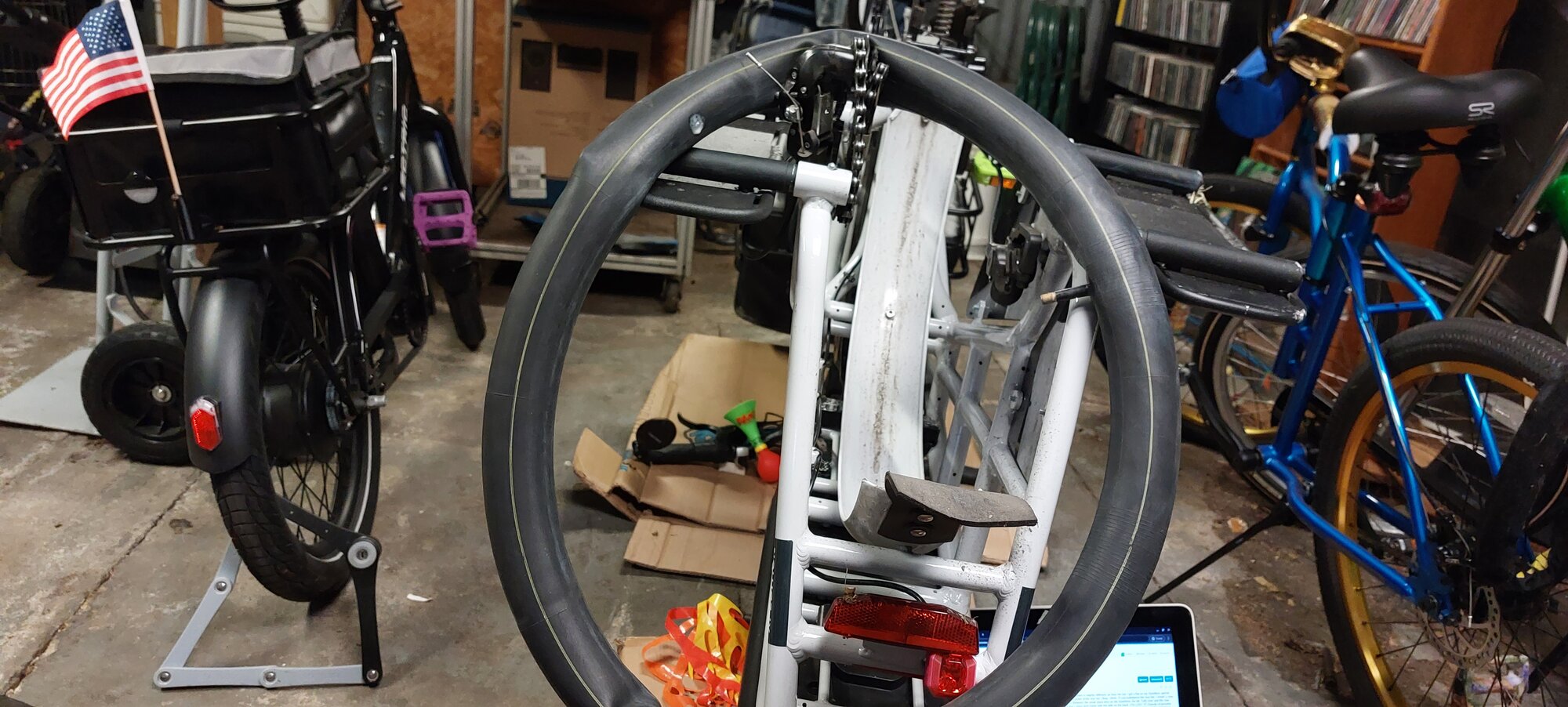

Yes, I'm going to throw some gas on the never ending discussion about flats. But my complaint is slightly different, so hear me out. I got a flat on my Xpedition awhile back, forcing my wife and I to walk home. It appeared that something got me right in the center of the rear tire. Okay, I think, I'll just bulletproof the rear tire. I install a new Lectric branded inner tube and a slightly larger (a 3 and a half to 4") Mr. Tuffy tire liner. Between the weak stock tires on the Xpedition, the Mr. Tuffy liner and the new tube with it's white milk like sealant I should be good. Well, I got a surprise today. A flat 2 miles from home with the wife on the back. I f'in LOST IT! Outside of possibly needing a whole new rear wheel from a poor temper check I get home and pull it apart. Nothing got to the tube from the outside. The Mr. Tuffy didn't chaff a pinhole in the tube. The cheap inner tube split on a seam! Yes, the cheap Lectric branded inner tube split at a seam! So I'm asking anyone in the know. Who makes a GOOD quality 20x3" inner tube?
Picture to follow to show you what happened.....
I think you can see the seam mentioned. I was running 30psi and didn't cause a pinch flat. This is a weak seam.

While my preference is nowadays to go tubeless, I do carry a Schwalbe tube as a spare. I have had on occasion over the years a tube split at the seam. I never thought of it as being a product failure, just what it was, a tube failure.
This tube that split along the seam only had around 20 miles on it. Plus the sealant doesn't do anything except seep out and make a milky white mess. I feel that Lectric just found the cheapest vendor for their inner tubes and just has someone add either milk or Slime to each tube and charge way more money. When I rode bmx I've had many a tube fail along a seam until we found a good quality brand (cannot recall the brand) but Kmart sold them. I'm currently on the prowl for a better tube. I might try the one fooferdoggie linked, or a Specialized tube.
