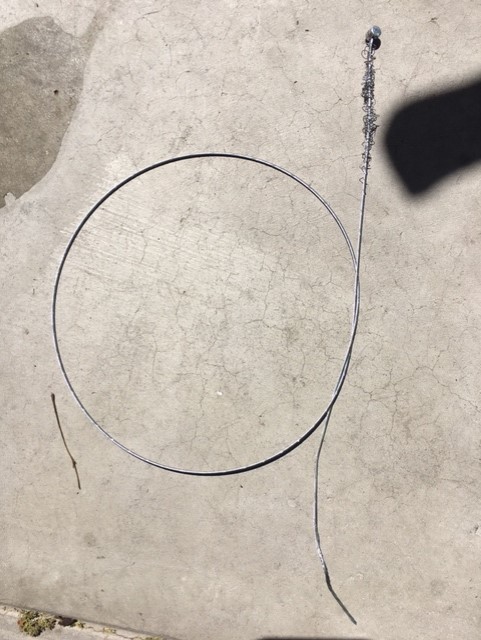

This is what my original Rad brake cable looked like before I changed it our to Spyke TRP brakes and Jagwire MTB coated brake cables. The 5-6 inches of coiled up broken strands were jammed into the 1.5 inch space of the brake handle and causing the motor cut off to active intermittent. No fun riding up an 2 mile steep incline during summer with a headwind and the motor cuts out. Never seen this before and haven't had this issue with my other Rad Power ebikes with the standard brake cables.

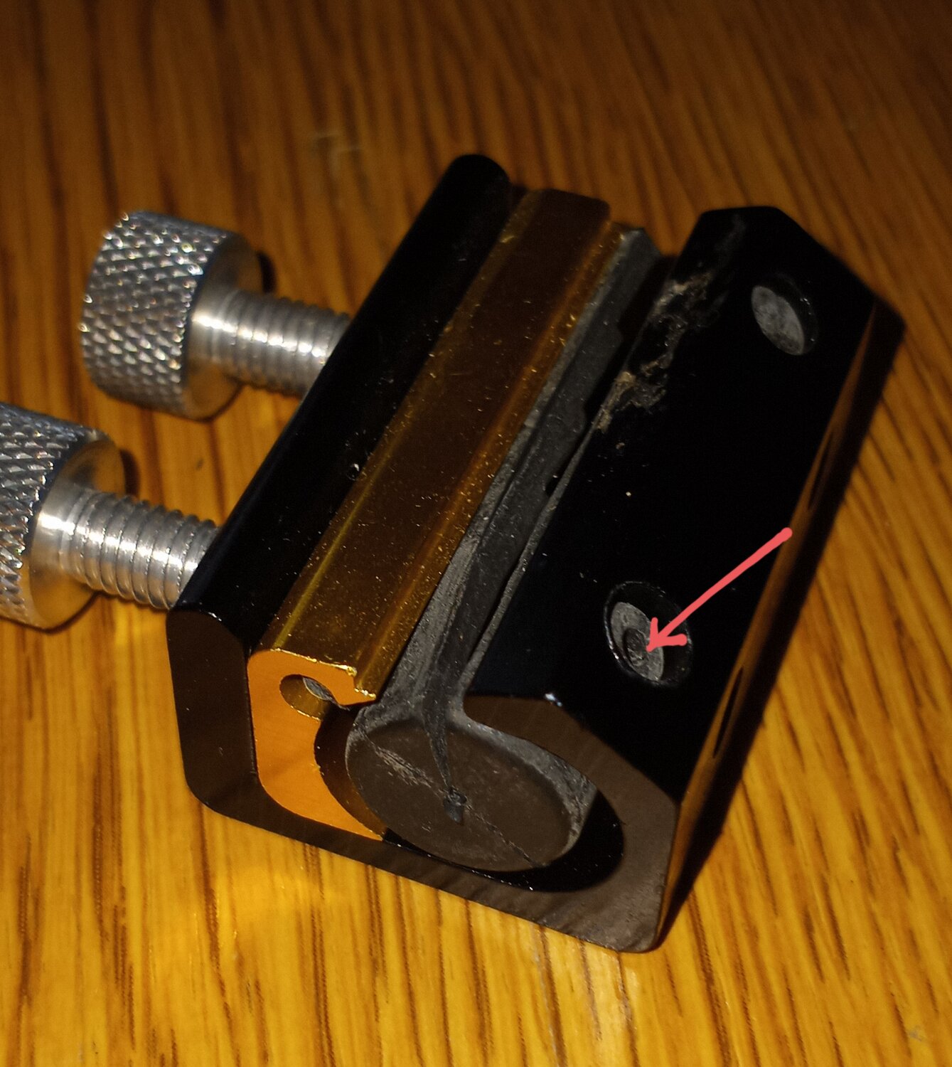

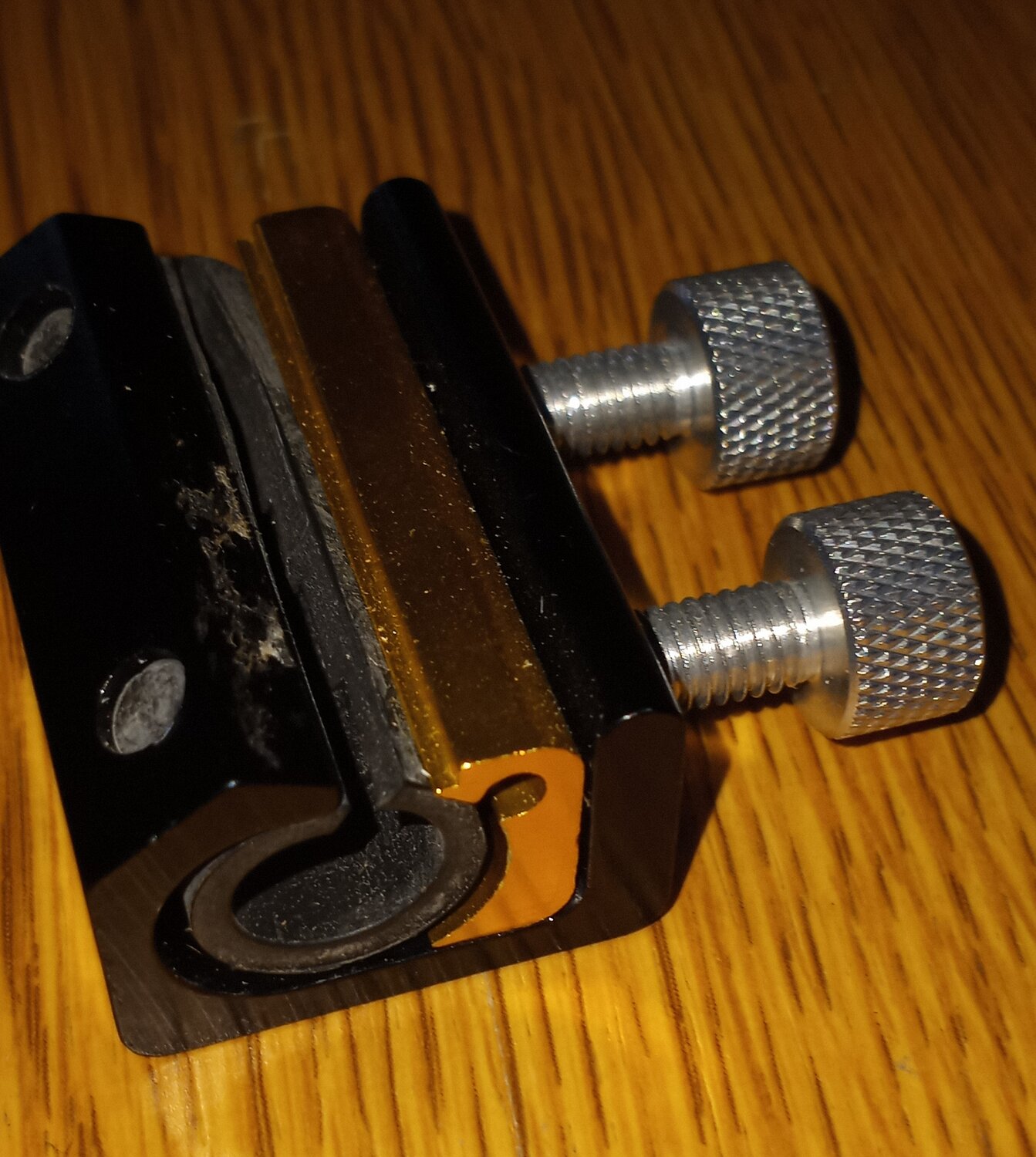

I've got this cool tool for injecting oil into an installed cable,..
You insert the spray tube from your spray can into the injector port.
It's sized for automotive cables though, so it's too big for my bike cables.

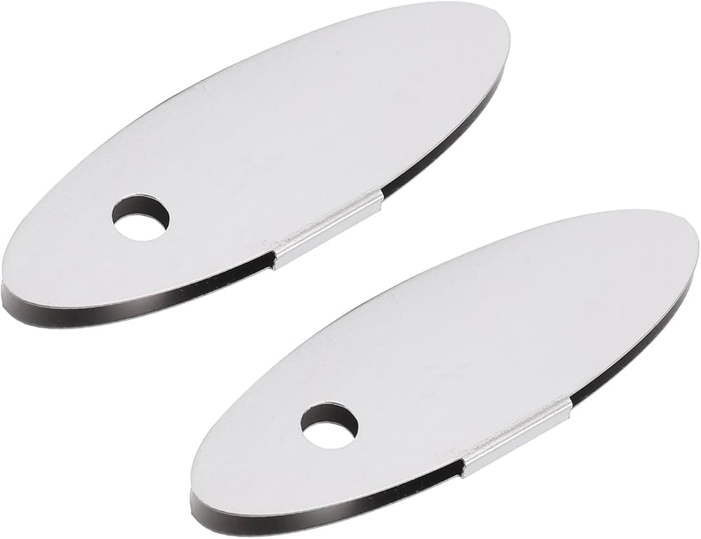

I also like stainless pad alighnment tools. They are half the thickness or less of a business card. If tightening always pulls only one way then that is when I will use a business card. I like the 'crank inside and outside all the way' as a centering technique, then I can back off to a bare whisper of rub at the start of a long ride for maximum tightness. I will guess that about half of the kids riding MacFox style moped bikes cannot stop because of brakes requiring service.

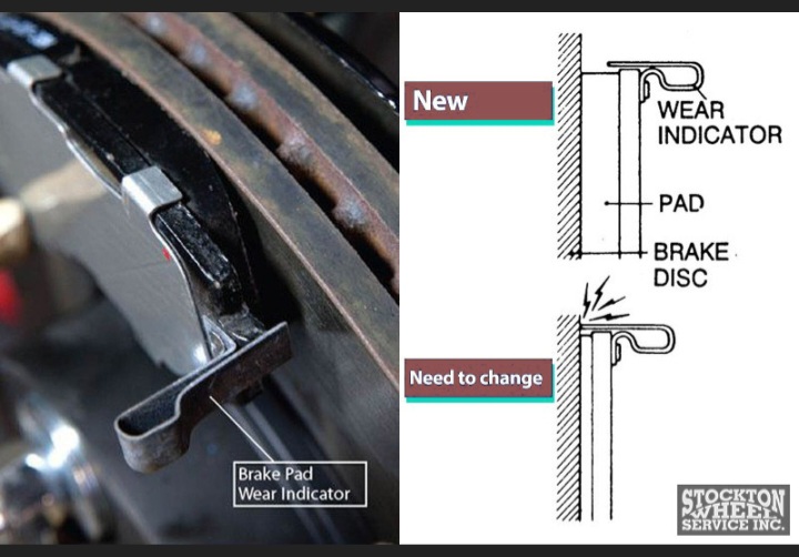

Edit: I just did it on a stainless pad spring expansion clip. I slightly curved in the ends of two legs, using a needle-nose vice-grip, one on each side about 1.3mm on a new set of pads as a wear indicator. It will scream like a cat trailing a fire from its tail! Should that be the leading or trailing edge? I suspect leading will make the most noise. I will run it by the guys at work in the morning. See, productive stuff can come from EBR.

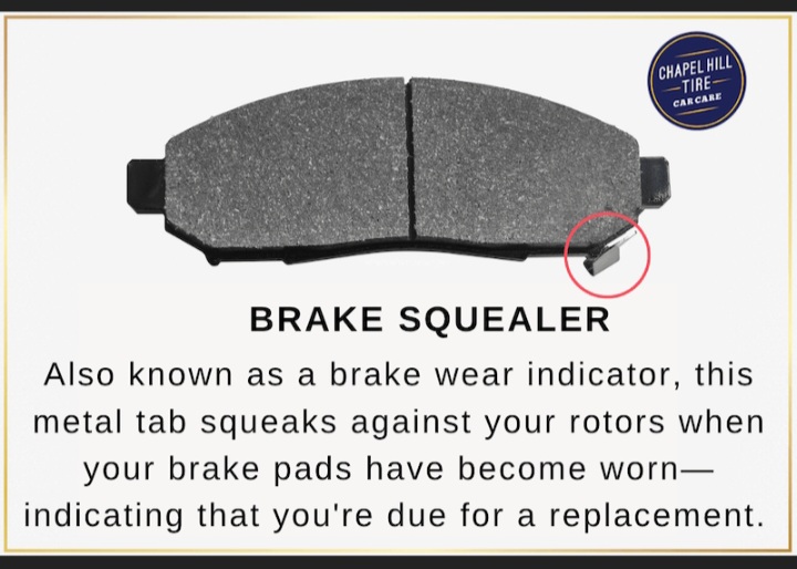

,.. Someone should invent a stainless return spring clip with a 1.2mm gauge that screams when it touches the rotor
Some replacement brake pads for my different cars had squealer tabs like that,..
Each pair of pads had one pad with a squealer.
I remember wondering about leading or trailing.
I think I ended up with one of each because the squealer tabbed pad had to go on the inside of the caliper, so it was leading on one side of the car and trailing on the other?
I think trailing would have more of a fingernails on a chalkboard effect? 😂
