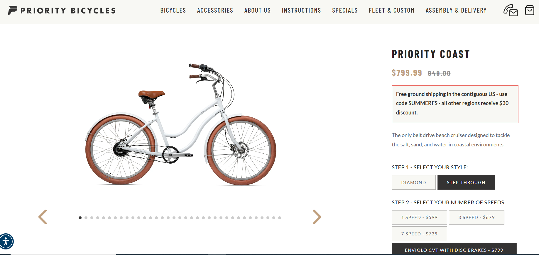

If it were me, I'd consider the Priority Coast with the disk brake option:
I'm spending your money here and It's twice the price of the Trek, but it would make a great conversion.

As for the brakes, I wasn't sure which way to go.
The better half is NOT a fast rider maybe 15 mph max,
she is afraid of speed/heights or anything else above walking speed.
I'll read the spec's and check things out. Not sure about a belt drive out here in all the dust/grit 24/7.
