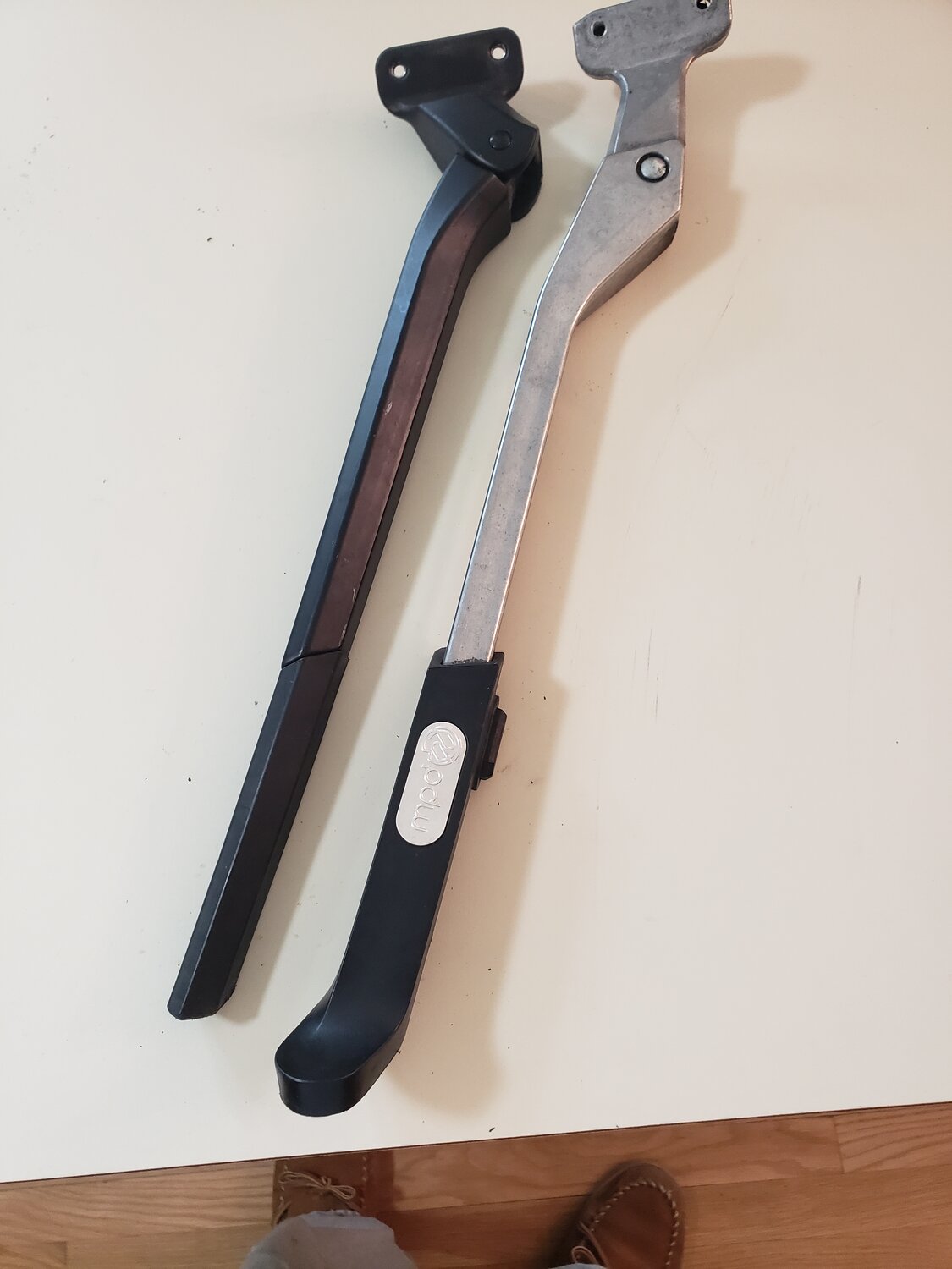

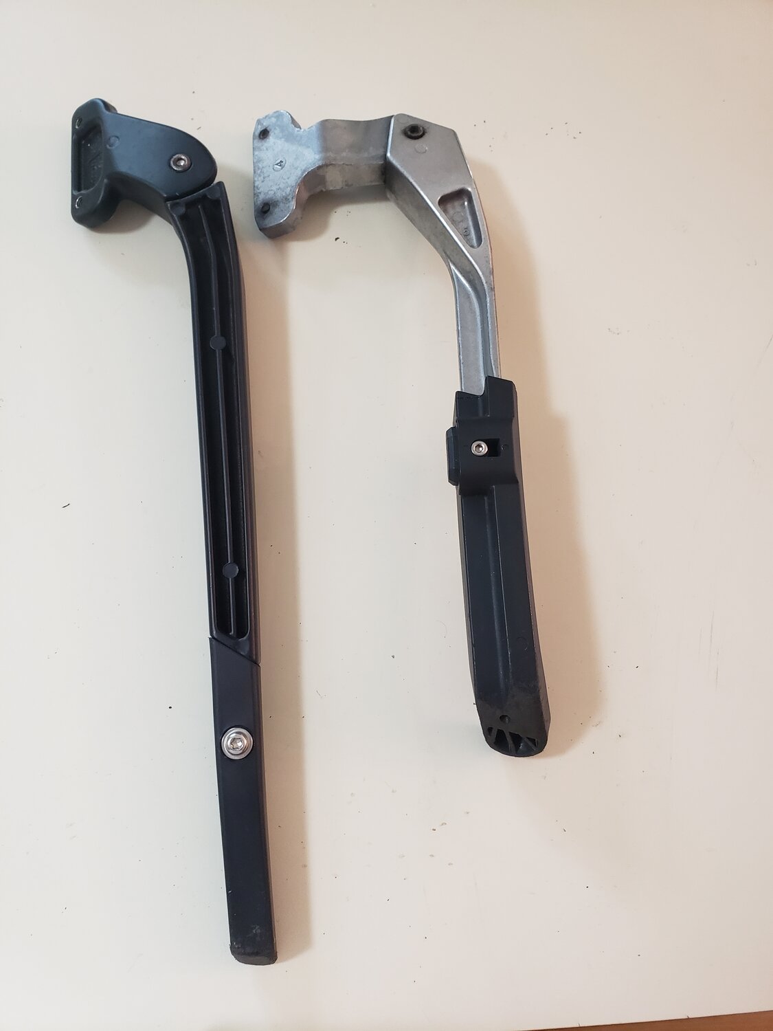

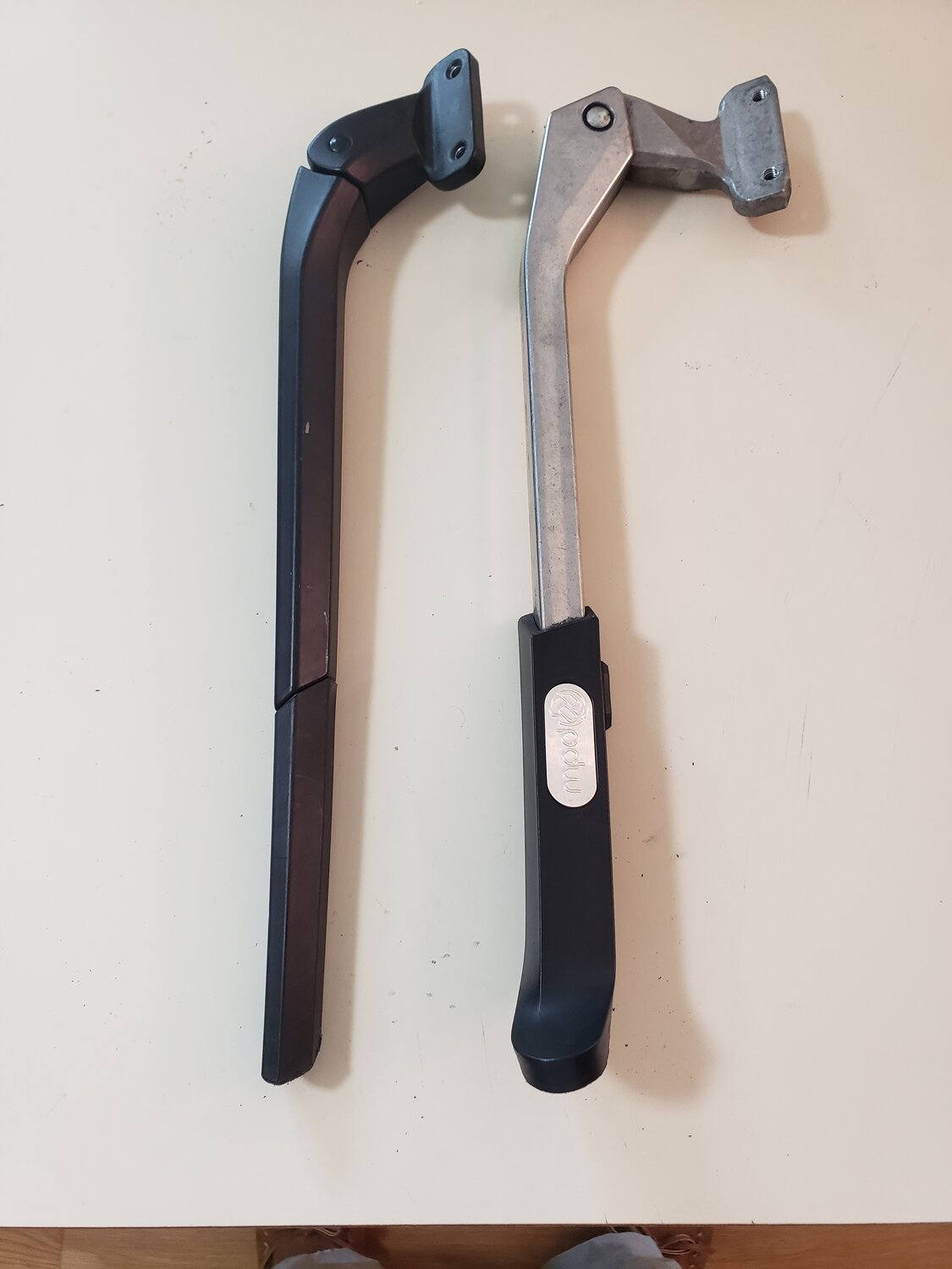

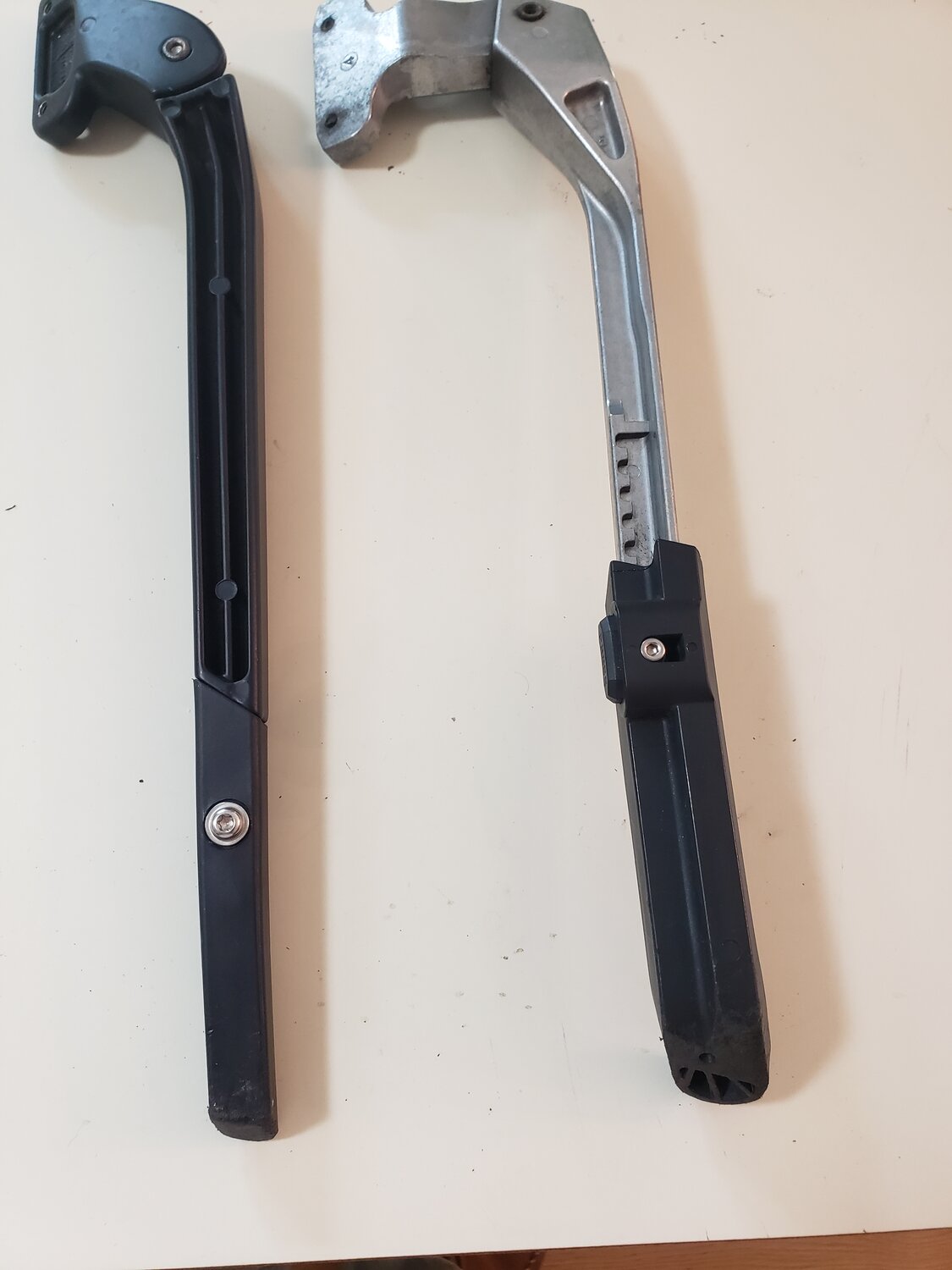

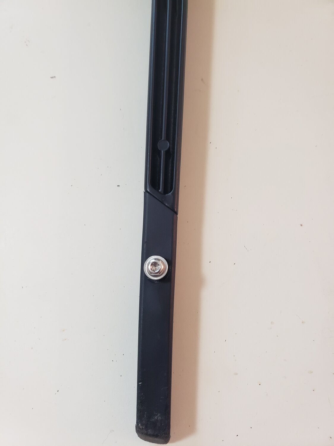

I bought the Power Stance Bicycle Kickstand through Amazon. They have it is either black or silver. I bought the black for my wife's Como and the silver for my Tero. The black version costs more for whatever reason.
The stock Como kickstand has an allen screw on the back but it looks like it is just to replace the tip. The PDW stand has a wide range of adjustment plus a slightly larger footprint, both of which help solve the stability issue.

Grab a hacksaw and trim a bit off the bottom of the kickstand - can't remember how much I took off, but it wasn't much (maybe 2-3cm?) and the instability is gone. Bonus points for cutting it properly so it sits flat when deployed.
The other thing that drove me nuts w/ the Vado kickstand is mine kept loosening at the chainstay. This contributed to instability when in use. I finally put some lock washers on the 2 bolts that secure the kickstand, problem solved.

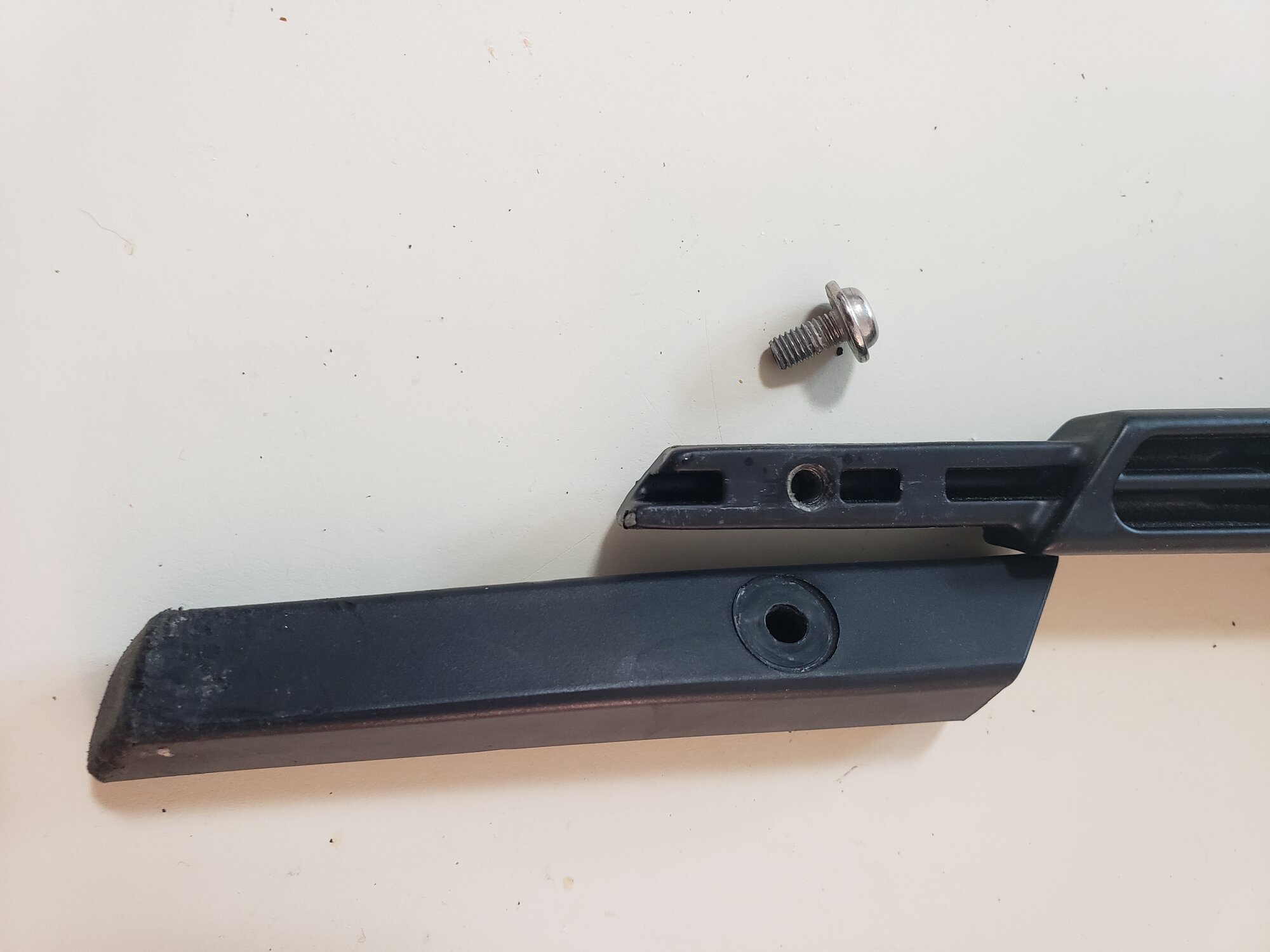

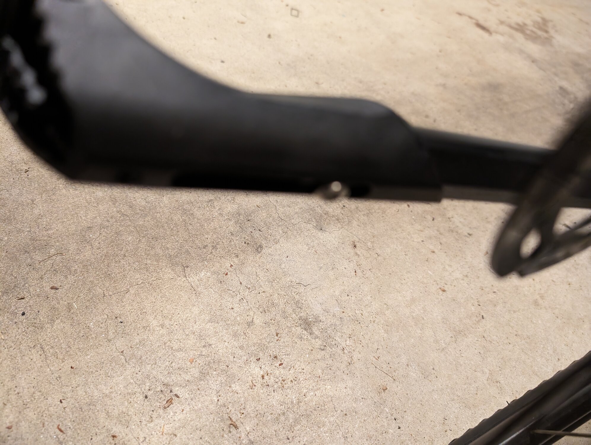

Adjustable or not?
There are 2 holes in the frame to attach the kickstand. I don't see what would be adjustable.
Edit: I just read another thread. Looks like the kickstand needs a trim.
Edit2: I found a screw that could be loosened to adjust the length. Thanks again, Stefan!
