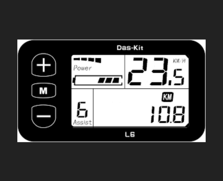

Your Moscow Plus is from 2021, so it might have the L6 or L7 display,..?
If your both your battery bar graph, and your power bar graph are showing 2 or 3 bars,. when you start up a hill, your power will surge which may cause the battery bar graph to drop to zero and your controller cuts power to the motor.

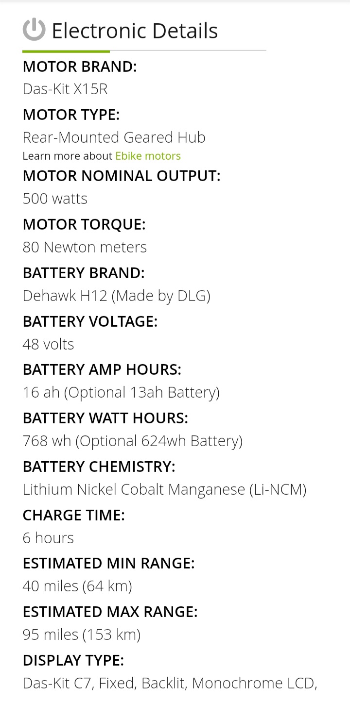

This is a link to the EBR review of the Moscow Plus,..
It lists the minimum range as 64 km with a maximum range of 153 km.

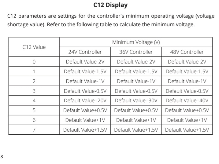

I could have entered my settings and turned down my cut-off voltage, but I didn't want to fry my battery.
I set my cutoff voltage to 41.5 volts to help protect my battery. I could have turned it down to 38 volts, but I didn't want to completely drain my battery, and I didn't have too far to go to get back home.

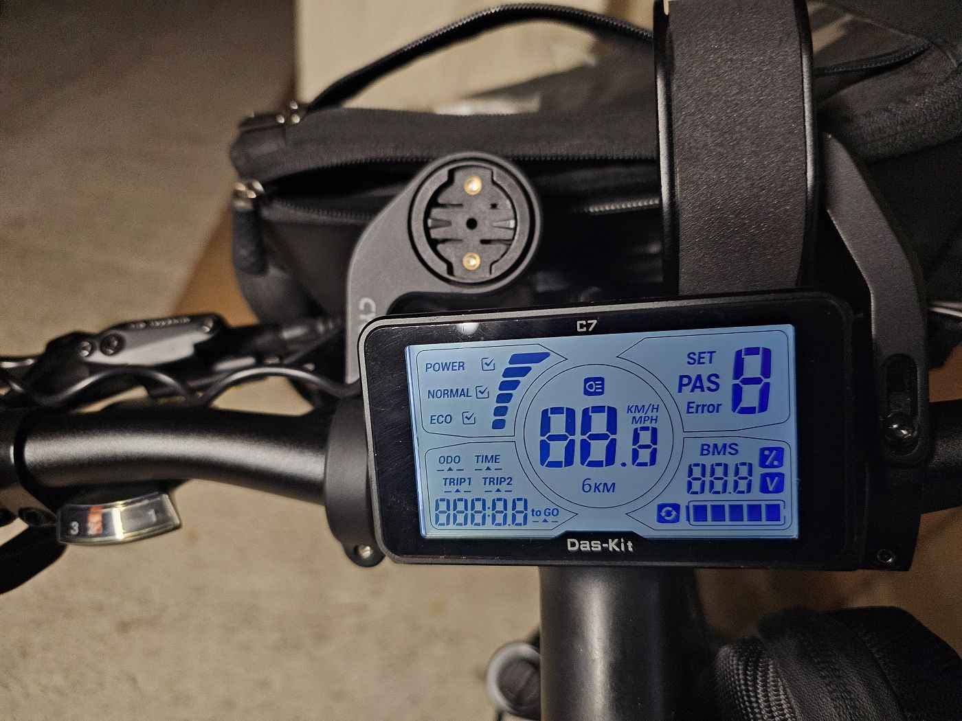

Now to answer your questions, I have a European Das-Kit C7 display (electrical assistance limited to 25 Km/H)

Concerning the battery it is a 48 Volt 16 Ah 768 wh, on the Moscow and on the MilanoNo

How to adjust the cut-off voltage?

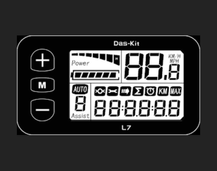

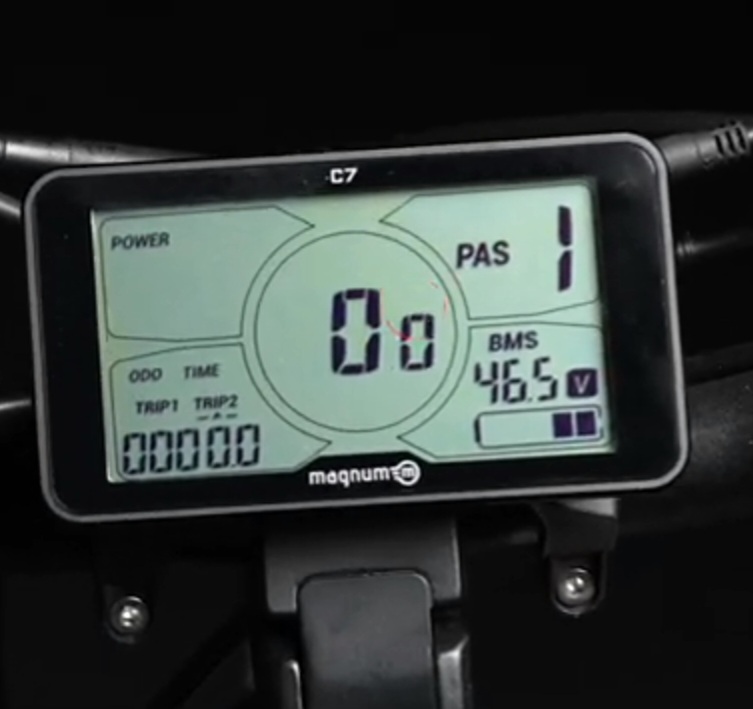

I have attached the photo of my display when it is switched on, so that you can see all the symbols, but of course I do not have an error message (number) when the fault occurs.

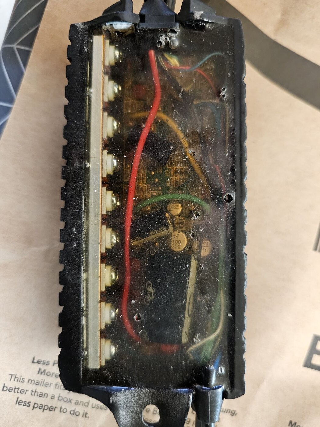

Hello guys I'm back, so I received a new controller (under warranty) and installed it.
The bike is working perfectly again, hopefully it will last.

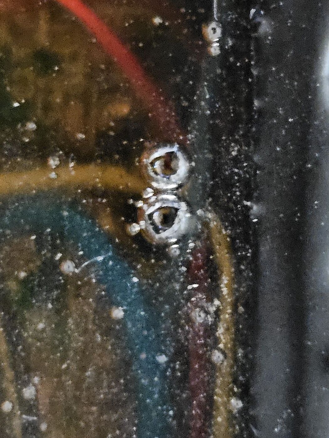

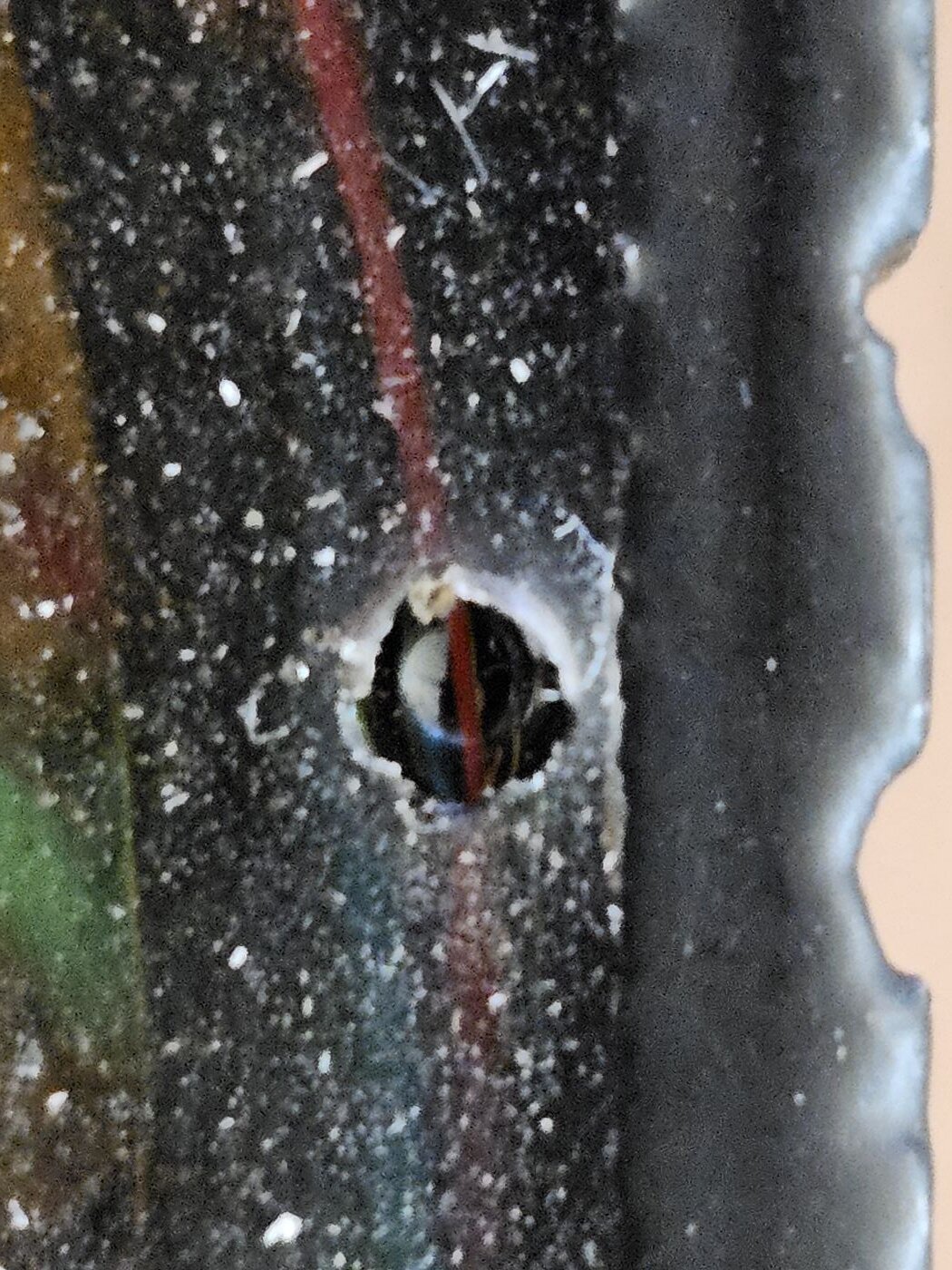

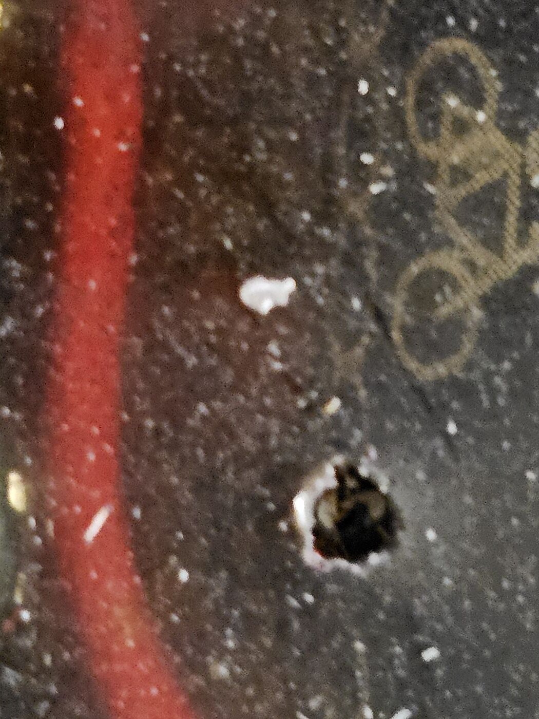

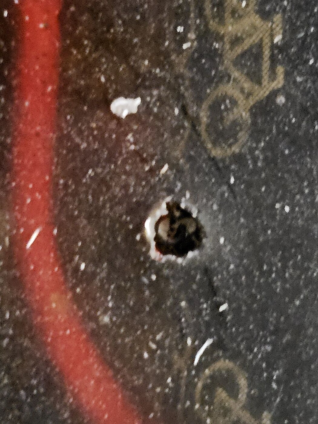

Before assembling the controller I examined it carefully and although it is cast in resin, there are several small holes (going through to the plate), I wonder if this is not the reason for the problems .
Especially since the same holes appear on the other 2 controllers.

PCeBiker, you offered me your C7 display but won't there be a problem with my bike given that the European display limits it to 15 amps while yours will limit it to 18 amps (my battery is only 16 amps?
