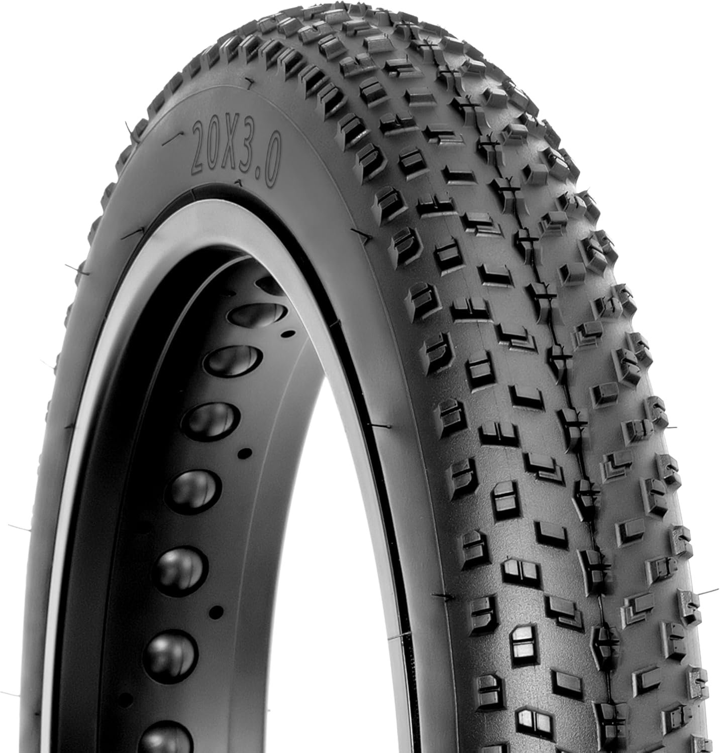

I use these in a cargo application and they are heavy-duty, with a super strong casing (30 tpi) but fast-rolling. They are very good on everything and the best at nothing. Think of them as an XC capable tire so good for doubletrack dirt and gravel roads, or flat pavement. Wet or dry.
The tread is a shrunk-down version of one of the many flavors of Chaoyang Big Daddy tire that is sold under the Arisun, Panasonic and Origin8 labels, among others.
I am actually quite a fan of this tire. I have been using Big Daddys or one of their clones for many years. You can get as much as 6000 miles out of one in the 26x4.8 size. You can find the same tread in 26x4 and 20x4 but those are all full size. Look at this one side by side with the others and it looks like a big tire that got hit by a shrink ray given the smaller knobs.
