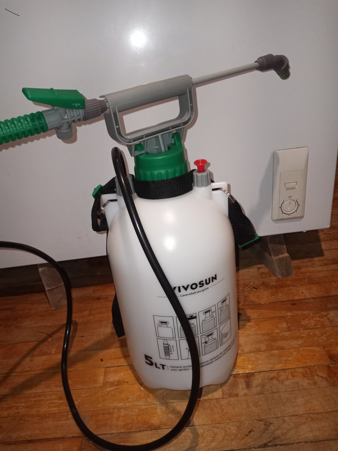

Learned from member @m@Robertson to use a garden sprayer with plain water after turning off the bike. The fan spray setting applies plenty of water power with surgical precision. Just avoid the battey and other sensitive electricals.
Might need a wet rag to loosen stubborn stuff, but no real need to dry. Great results in over a year in my sandy, salty coastal setting with no bike rust to speak of. (Meanwhile, the tools in my garage are rusting all on their own from the salt air.)

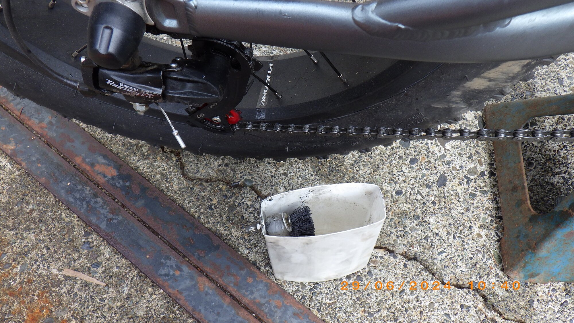

Well I was able to hose most of the Dust off and used a soft Brush as well, no Soap this time. The Chain I will do once I get back home to my Shop where I have my self made Chain cleaning setup which makes Chain cleaning and relubricating a breeze. Thanks UC
We're gonna wanna know more about that setup.
Meanwhile, I also use the garden sprayer to rinse salt and sand off my drivetrain between lubes — which I don't do very often because it's anything but a breeze in our current house. (The price one pays for downsizing 60% to live 5 min from the beach by bike.)
Never dry afterwards. Works well.
When you say garden sprayer, is this like a garden hose with a nozzle on the end? Aussie trying to learn American English :) Something like this?

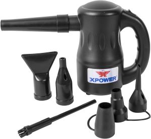

I hand wash my cars with ceramic soaps, microfiber wash mitts or microfiber towels, and air blower to finish up. I use the same for my 5 ebikes. I clean the chain on the ebike with the Park Tool chain cleaner and Pedro's Oranj bike chain degreaser. I also use the scrub brush that comes with the Park Tool to clean the gears if I have any build-up. I use the garden hose and lightly spray to wet the tires only. I use the same soft bristle brush in a bucket with car ceramic soap for my car tires on my ebike fat tires. Lightly spray with garden hose to remove soap. I use a soapy damp microfiber towel to wipe any dust, dirt, or mud splatters off the frame, seat, seat post, handle bars, or Topeak MTX rack bag.
My secret weapon I love to use is my Xpower A-2 electric air blower ($40, Amazon). Lots of places for water to hide and sit with my ebikes (spokes, gears, F/R brakes, pedals, F/R suspension points, around screws, around electrical connections, etc...). I also use the air blower on the chain to make sure chain degreaser and water is reduced before adding lubricant. I also use the blower if caught out in the rain and I want to dry the ebike a bit before I get a chance to wash. Also helpful if my ebikes are just dusty and I want to do a quick dusting before riding.
