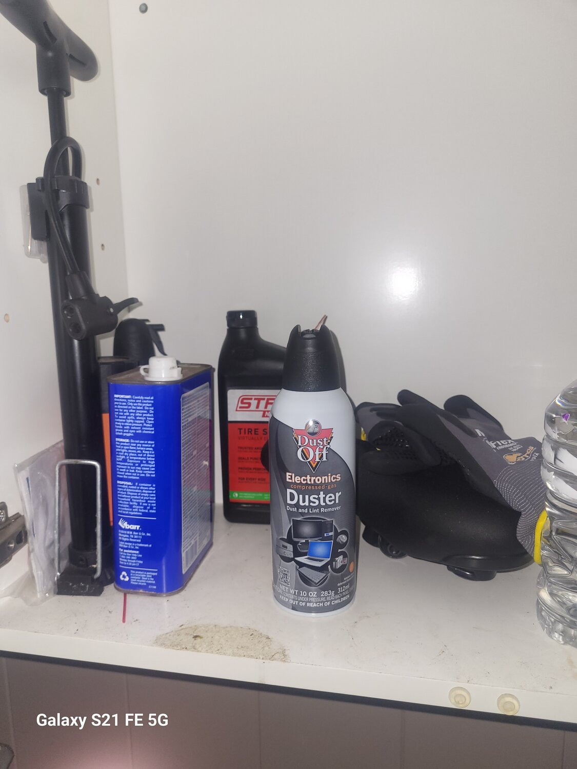

I have steady supply of electronic cleaning spray.
Good habit to spray clean your charger, there's a tiny fan inside.
My Chinese made charger for my Monte Capro failed to charge battery. The culprit was the fan wasn't spinning.
I opened it that's how I know. Plug it in while everything is visible and that was it.
Cooling fan wasn't spinning. I sprayed a good amount of compressed air from a cannister and gave it a few solid smack with a rubber mallet. It's fixed after that I bought a new one anyway for back up.
