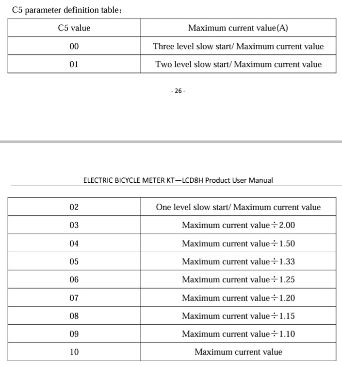

I'm pretty sure that it doesn't measure cadence.
It just applies power differently if you are moving or not.
The power can be turned down to apply gradually when you start from a stop.
I chose C5=3 to turn my power down to half. (to use less power and increase my range.)
C5=0, 1, or 2 allow for slow start power levels.
I might try C5=0 to see what happens. I don't have to use full power, at least not all the time.
I think I tried it once, but it didn't work because I don't have my cadence sensor hooked up?
I can't remember?
