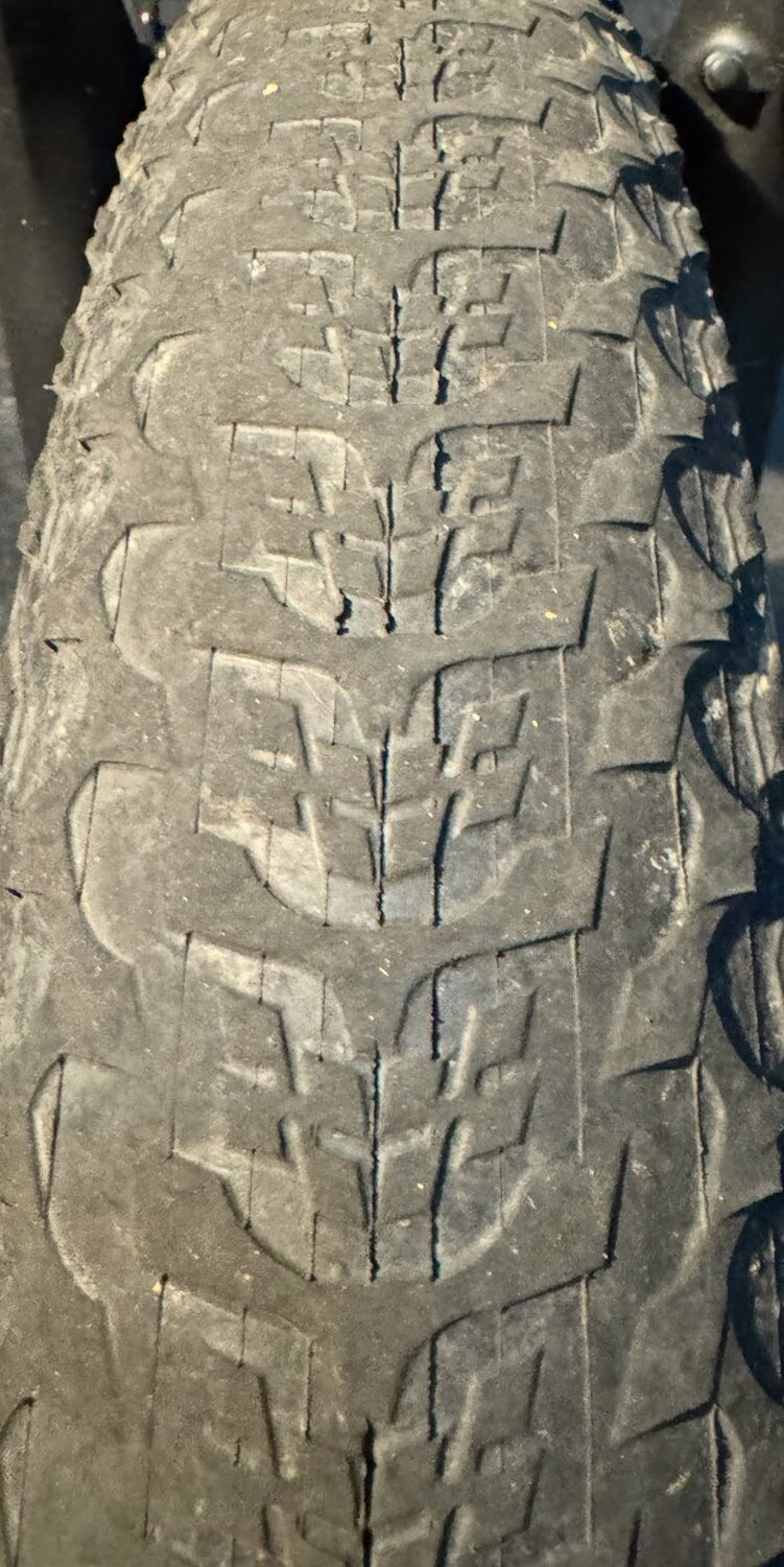

Hi everyone, I'm the Original Poster (OP) resurrecting this thread, thank you for all the responses thus far.
My mid-drive ebike has motor inhibitor switches in the brakes, but not a shift sensor, thus I use the front brake as a 'clutch' to ensure the motor is fully disengaged when switching gears, to ensure minimal wear on mechanical components.
The 26x4 street-type tires have gone around 1,700 miles on this 86 pound ebike, and the front is showing much more wear than the rear tire nowadays.
As mentioned in the original post, coming from a hub-drive ebike previously, where the rear tire wore out much quicker than the front, I this opposite scenario quite surprising.
Does anyone have any thoughts?
