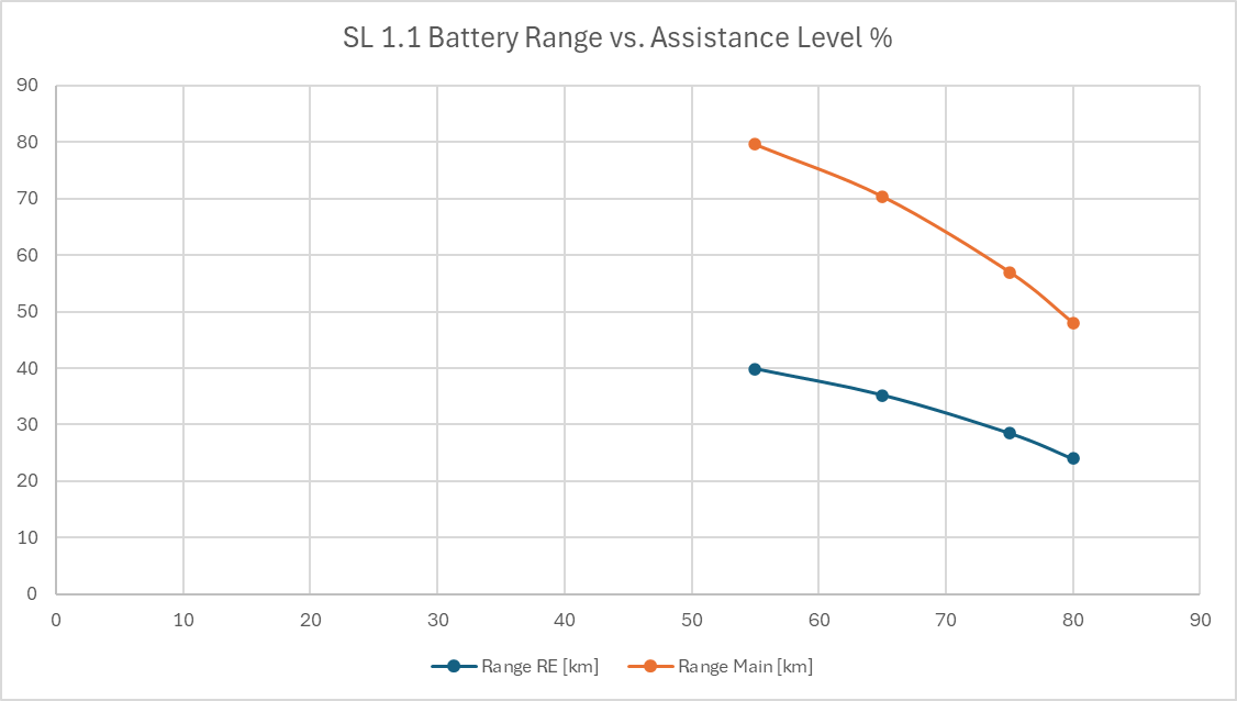

The real world range on the main battery with 55/55% assistance is 77 km (around 46 mi) in a flat area, regular warm conditions. This level of assistance means a good punch to the leg power. A similar range is achieved at 30/80% assistance. This setting makes it easy to ride hills.
Any assistance above 60/60% will eat the battery charge at an alarming rate.
Assistance of 40/40% and below ensures a tremendous range.
The numbers below refer to exactly your e-bike model.
This is the range I got on a single Range Extender yesterday, cold weather (4-8 C), 55/55% SL assistance, flat terrain:
24.7 miles.
The main SL battery is equivalent to two Range Extenders. (The actual range may depend on many other parameters).
The Range Extender battery range at SL 65/65% assistance:
The main battery would be good for 70 km, or 43 miles.

More data:
  • 75/75% assistance. Range Extender lasted for 28.5 km, so the main batery would last for 57 km.
  • 80/80% assistance. RE was good for 24 km, so the main battery range would have lasted for 48 km.
Vado SL, a 105 kg rider+clothes+cargo, reference temperature 10 C, flat area, paved surfaces, very rare stops, light winds. E-bike restricted at 25 km/h.
Assistance %Range Range Extender [km]Range Main Battery [km]
55/55​
40​
80​
65/65​
35​
70​
75/75​
28.5​
57​
80/80​
24​
48​

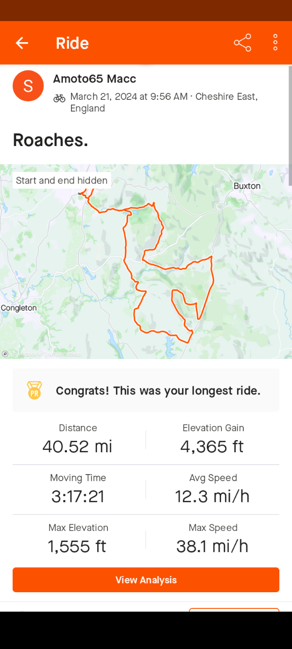

It all depends on how you ride the Vado SL, assist levels, your own weight and fitness, wind conditions, road condition (good tarmac or slow draggy tarmac that the UK is full of, or cycle paths & gravel roads etc) and hills - how long how steep? For example I did 42 miles the other day with 25% of battery left after 3585ft of climbing. I might have used less, but with the weather being so rubbish last few months, I'm not that fit and so even though the day was gorgeous I was tired heading for home and used more assist in the last 10 miles.
But those figures are also misleading because I tend to ride as much as possible without any assist. Around 50% of that ride was without assist, 35% in eco and 15% in sport & turbo. I use the motor for hills, headwinds and to get me home when tired. After 3 years of playing around with assist levels etc and using it like this, I now know 30 miles is fine on the battery alone, and bear in mind its very hilly around here, up to 45 miles I need to be careful with route planning and assist usage and beyond that - when I'm fit enough - I use the range extender. Of course when I get fit enough to do 50 miles plus I'm also fitter and so use less assist so that helps as well.
