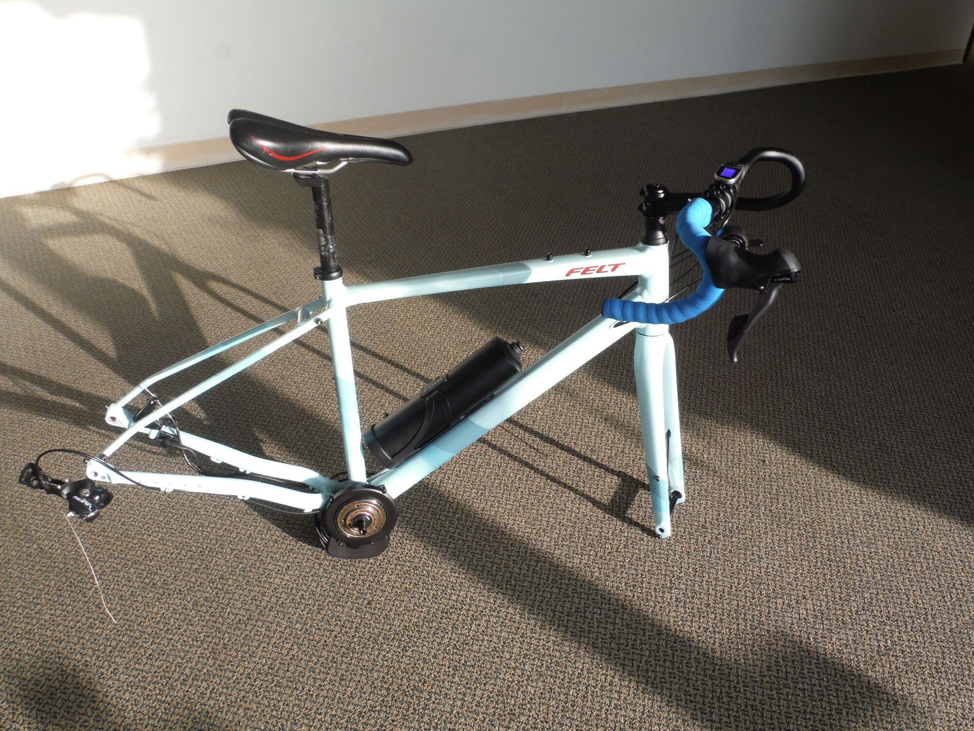

You need a mid-drive. It will pull chain through the shiftable gears. All it takes are a gravel/adventure bike, a motor, and a battery.
@jabberwocky, @Chargeride and @PedalUma are all correct. Gears are used to make the bike easier to pedal up a hill, and with a motor in the drivetrain, they benefit the motor the same way they do your legs. Anyone can test this on any bike by leaving it in one gear - say a 16T cog in back to be comparable to a typical hub motor - and try and go up one of those 6-12% grades without shifting. Easy lesson to learn.

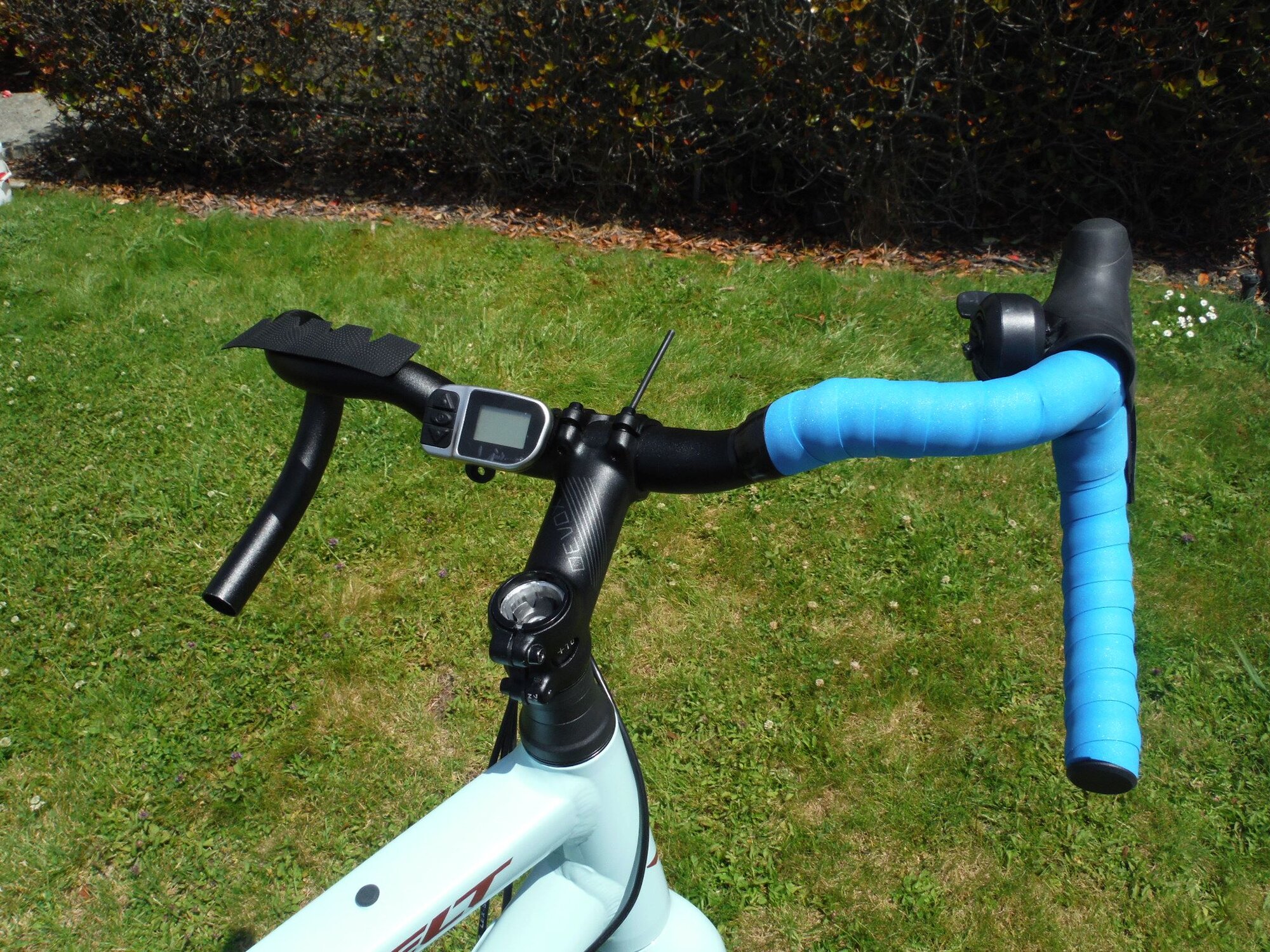

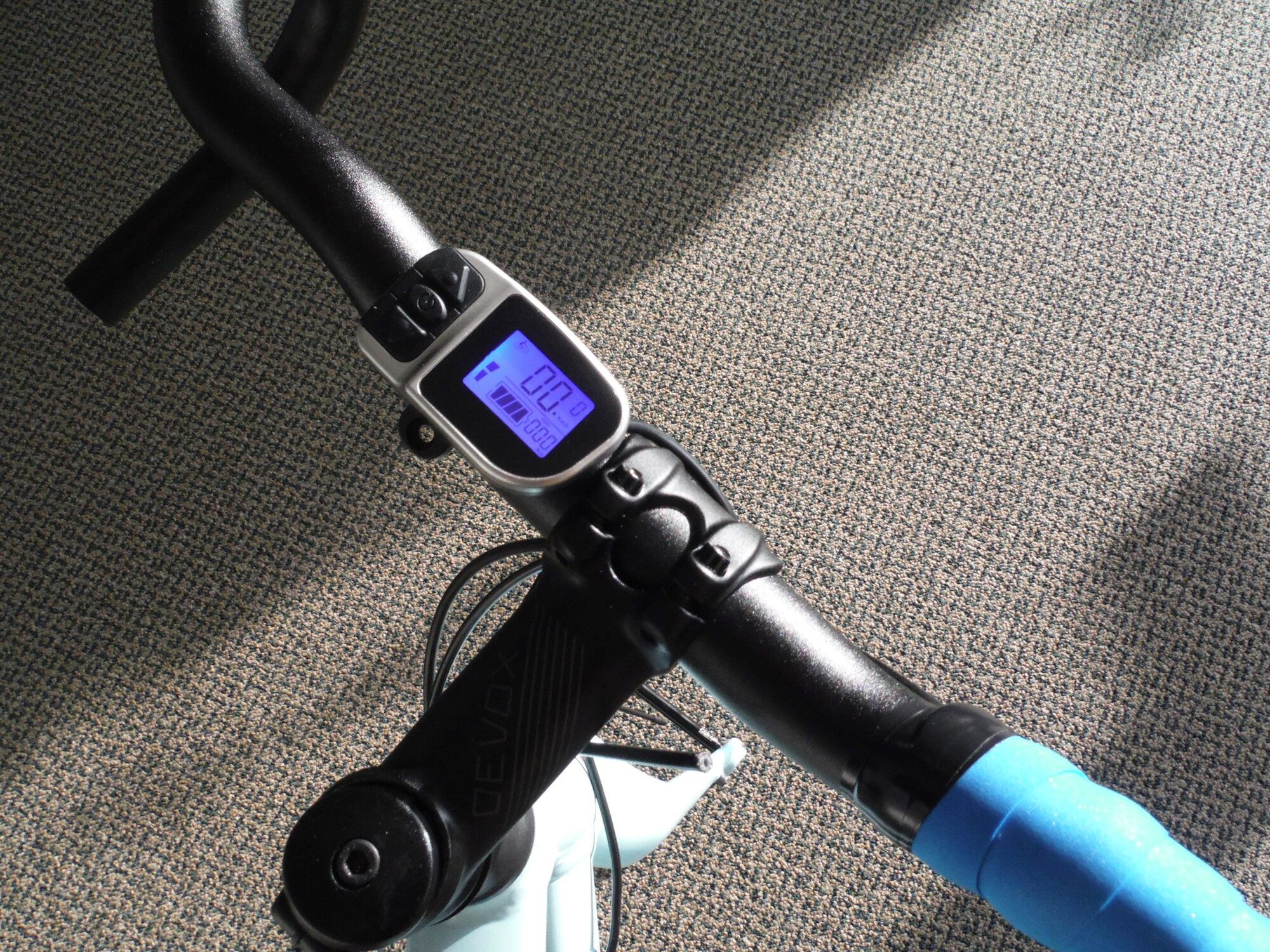

That drop bar Felt gravel adventure is the only one I have heard of that is all through frame and has a torque sensor with a throttle. Normally throttle bikes have bulky wires and as many connectors as a farm dog with fleas. I put the thumb throttle on the inboard side of the lever hood. Who ever smelt it, Felt it.
