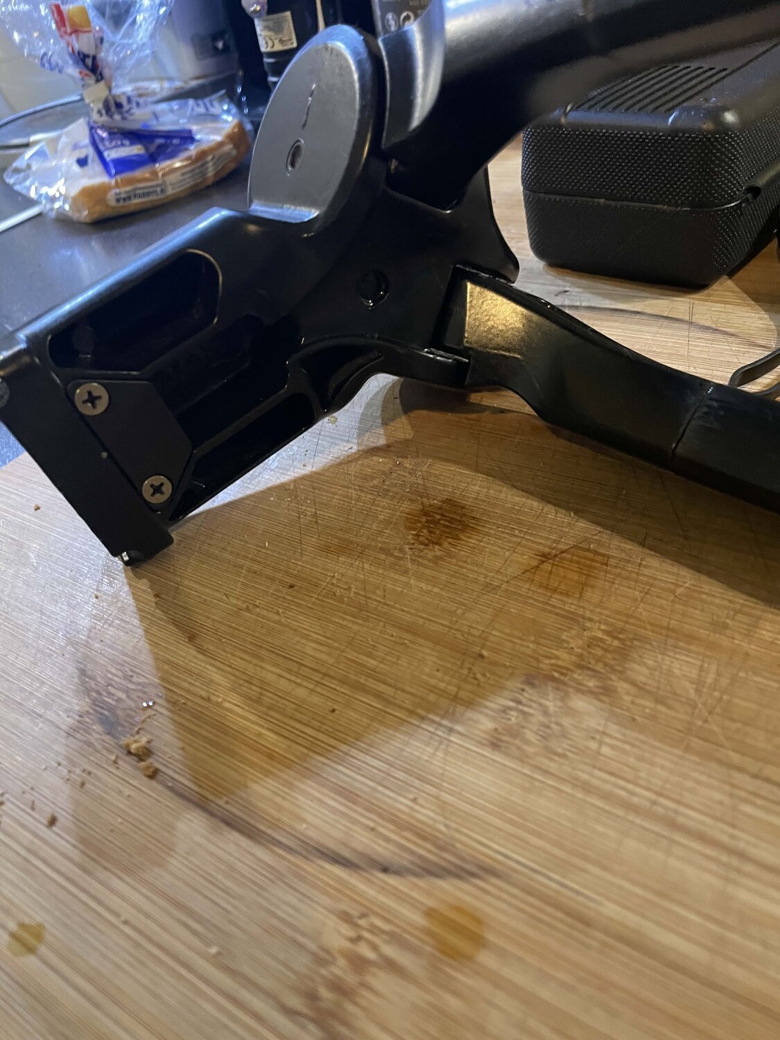

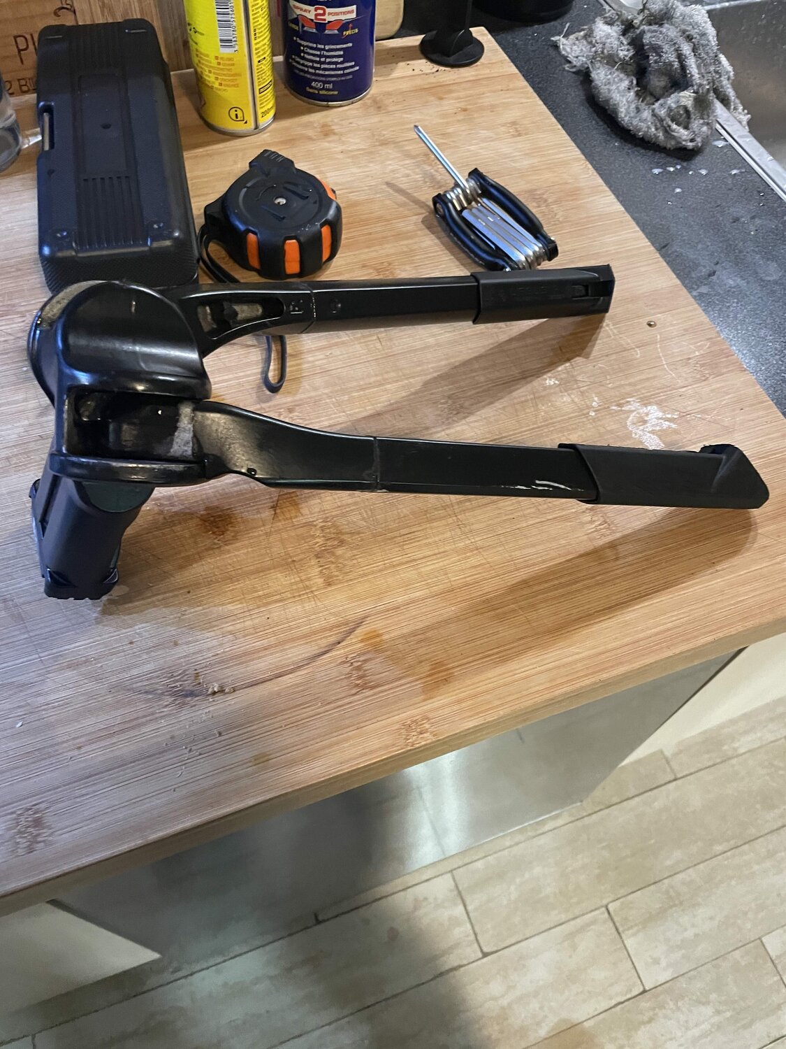

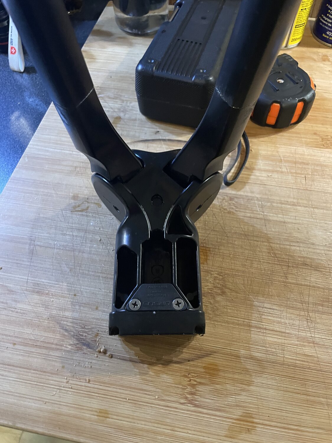

My Ursus kickstand on my 2021 multi charger mixte (with derailleur as it seems is important...) is broken. It doesn't open anymore (it blocks halfway) and I can't find a way to fix it (cleaned/degreased with no luck and it seems there's no way to dissasemble this).
I know from a previous post that r&m sells the whole kickstand kit under the VBK0363 reference but it's not in stock in my local bike shops (and I don't need all the mounting accessories that I still have).
I wonder if someone could confirm the exact model and size of the Ursus kickstand.

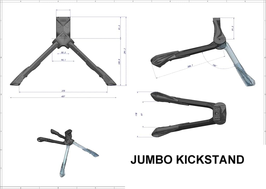

Model seems to be a Ursus Jumbo Evo (https://www.ursus.it/products/jumbo-evo) but it comes in 2 sizes and I'm not sure which one will fit. Of course I can't find any reference number on the part itself...
thanks in advance for your precious help
David

Hello
Thanks. I got a timely answer from RM support which confirmed that the correct one is the short one (275mm) if that’s helpful for someone else as well:)
