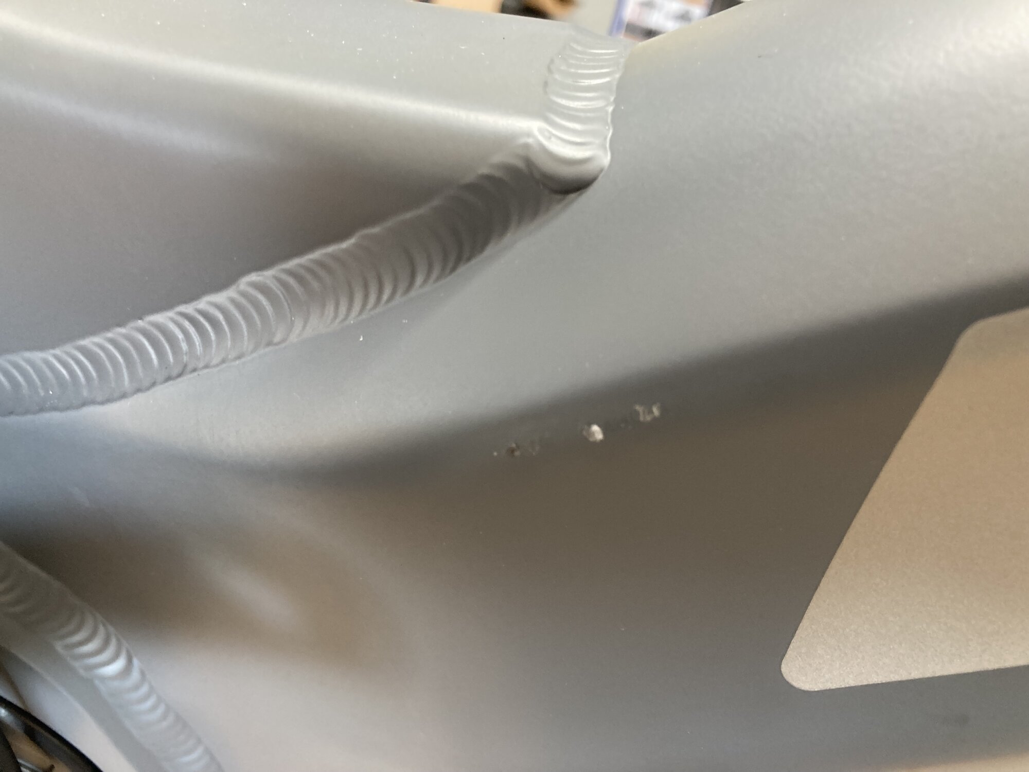

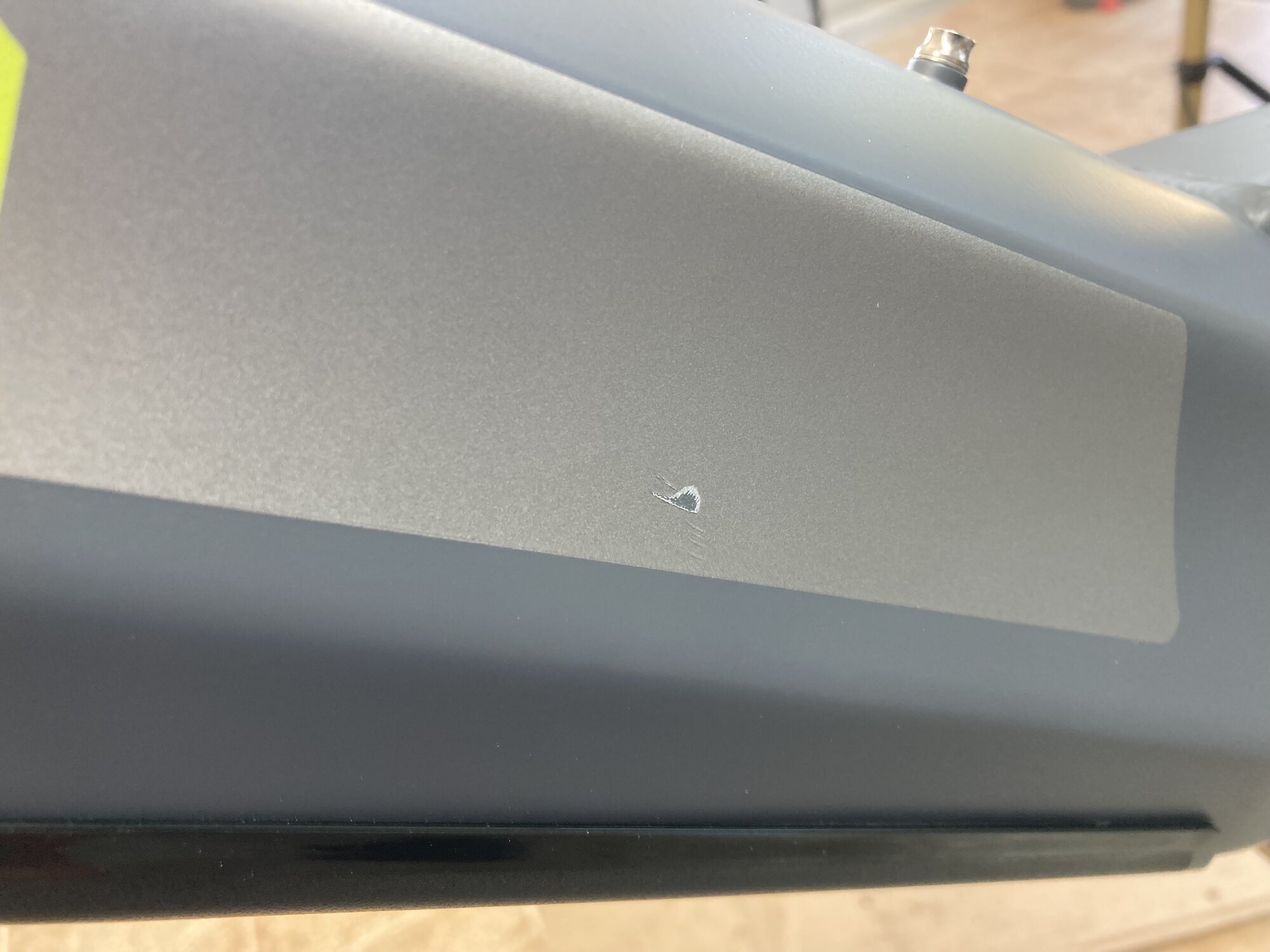

When my wife's first Photon arrived damaged I took some photos of the damage.
A couple of the photos were of chips in the paint. Here's a photo of the frame. I have the same coating on my Watt Wagons Hydra mountain bike.

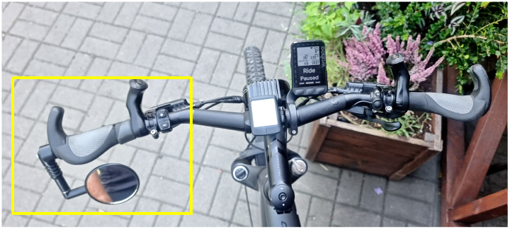

@gladiataar, do you have a mirror on your Photon?
I do. I researched the handle-bar-clamp style mirrors suggested in a few posts here on EBR, but for various reasons, ended up going with the kind that mount inside the handle bar tube ends instead. To do that, you'll need to pick up and install a set of these (or other brand equivalent) first:
Once that's done, you'll be able to insert mirror mounts inside the ends of the handle grips.
A more "bump-resistant" mirror choice would be this:
However, if you're looking for something more compact, you could try this, but I found the advantage of having fold-away capability was not worth the extra hassle of having to frequently re-adjust the mirror during my rides:
