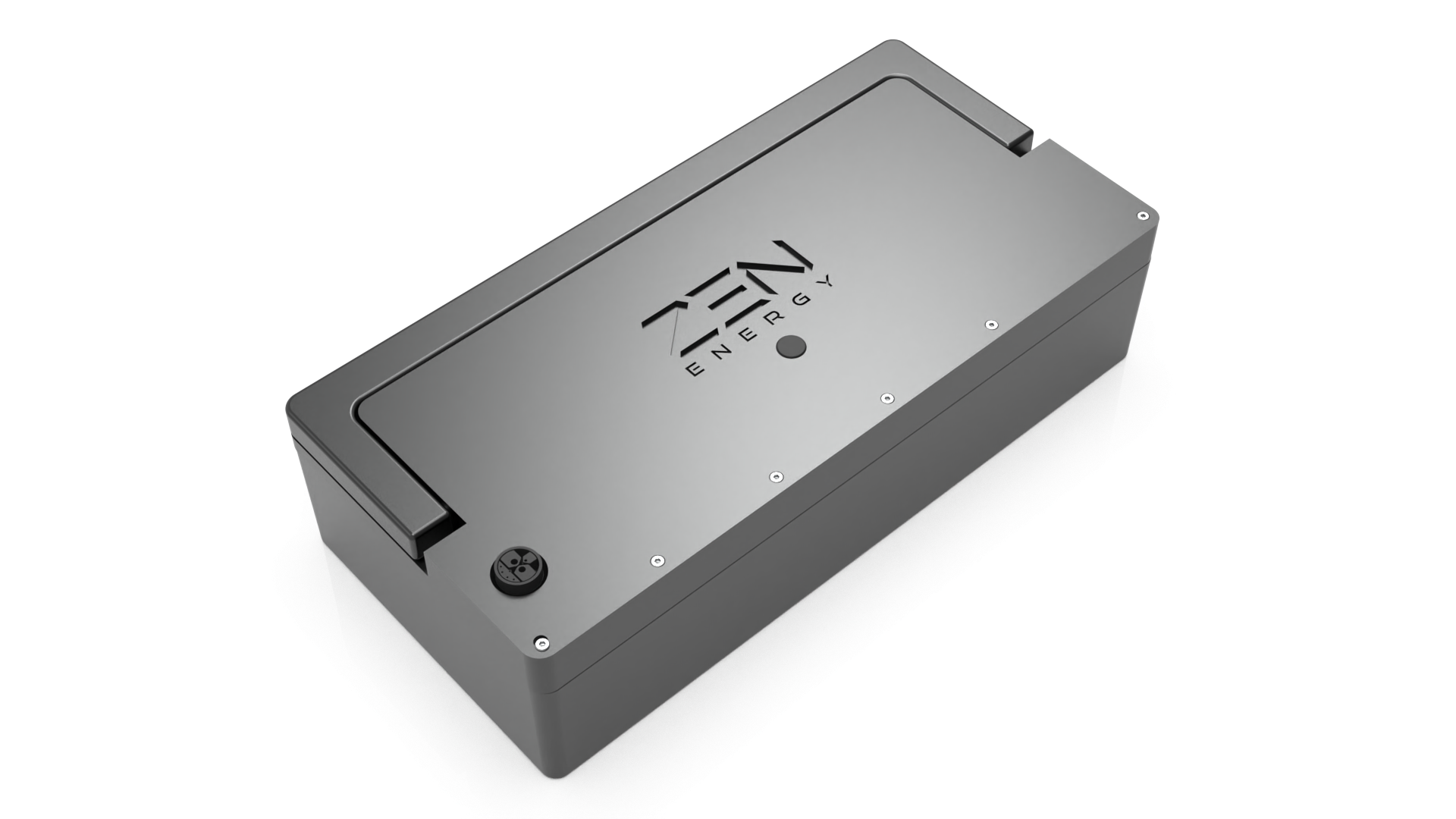

It's essential to focus on battery health and maintenance. Our approach includes engineering long-lasting, wire-bonded battery packs with advanced battery management systems. The Zen Photon, featuring a 500W motor and 1040 Wh battery, exemplifies this, ensuring extended range and efficiency. Proper battery care, like regular calibration, is crucial for optimal performance and longevity.
