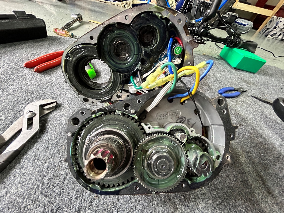

I did mine first at 500 miles, found it had very little grease in it. Then just to see what it looked like I opened it at 2,300 miles. It had lots of corn head grease. I added a bit more. I will do mine once a year or every 2,500 miles.
Before:
After 2,300 miles of Corn Head grease

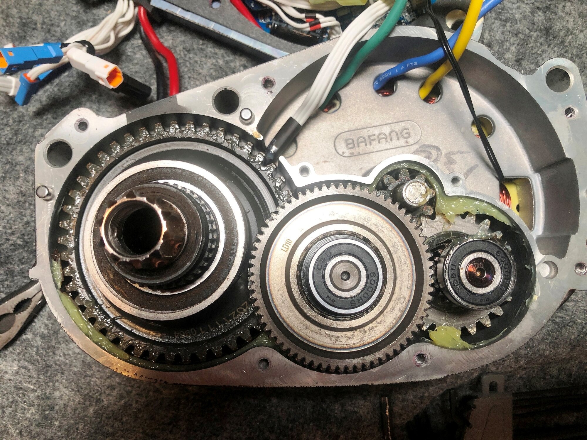

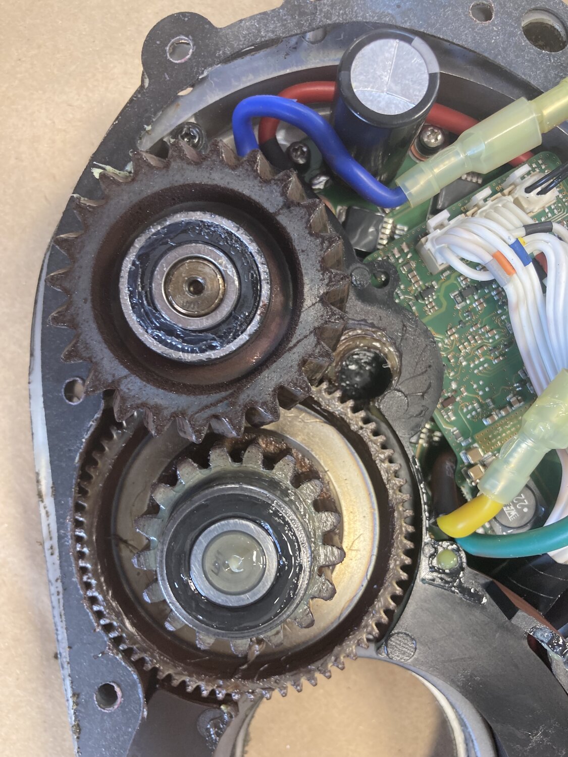

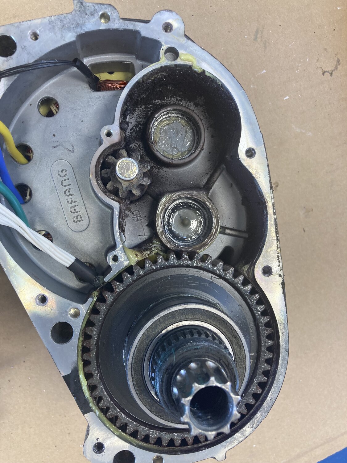

I picked up the Head Corn grease a week ago and the new gaskets came today. Turns out the old gasket was in really good shape, but I'll replace it anyways.
Below is three photos of the motor apart. This is all new to me, but it doesn't look like there's much grease.
What do you guys think?
Also, look at the shavings in the case. What the heck is going on with that? Have you guys seen this before?
Any idea where the shavings came from? the gears don't look to be damage.
One last thing.....having trouble getting the gears out. Should it just pull out? I twisted and pulled, but the one gear only came out part way. I'm not sure how much force I should use.
Thanks
Ron
Yikes! The second gear looks very worn. The tooth profile has worn down to a triangle. The sides of the teeth should be curved like the gear beside it. I imagine the center section of the first gear is worn out too. You're looking at a new rotor (the first gear is pressed on) and a new second gear.

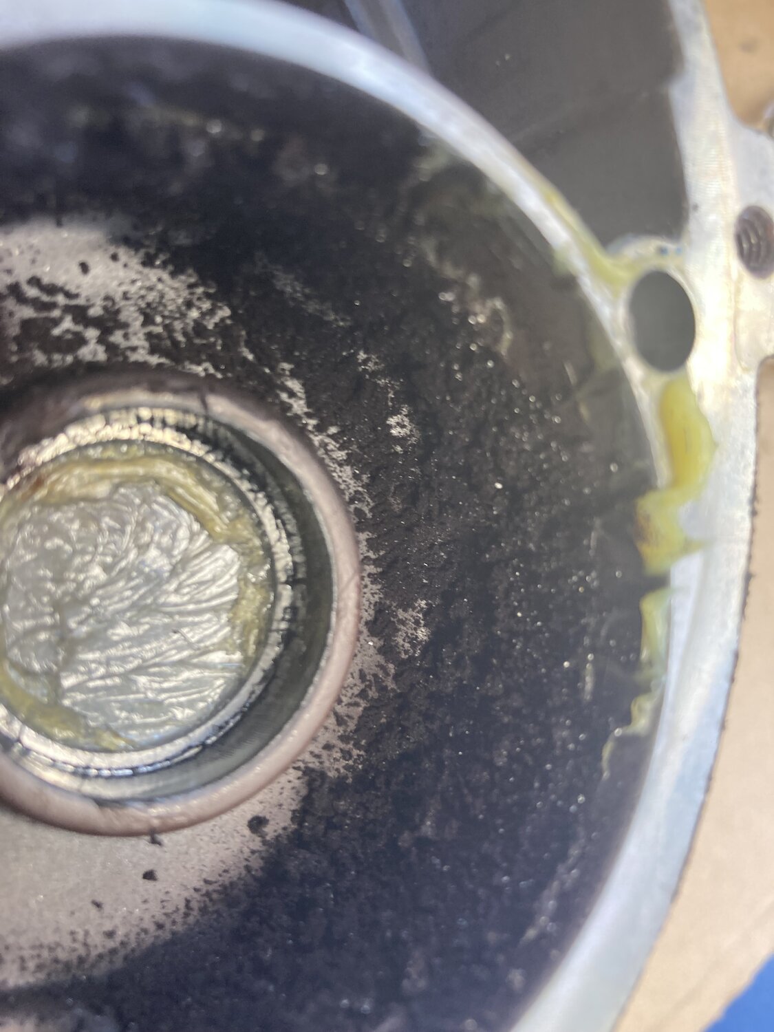

I turned the case upside down and the gears fell out and I'm wondering the heck the black stuff is. Wear from the gears?
