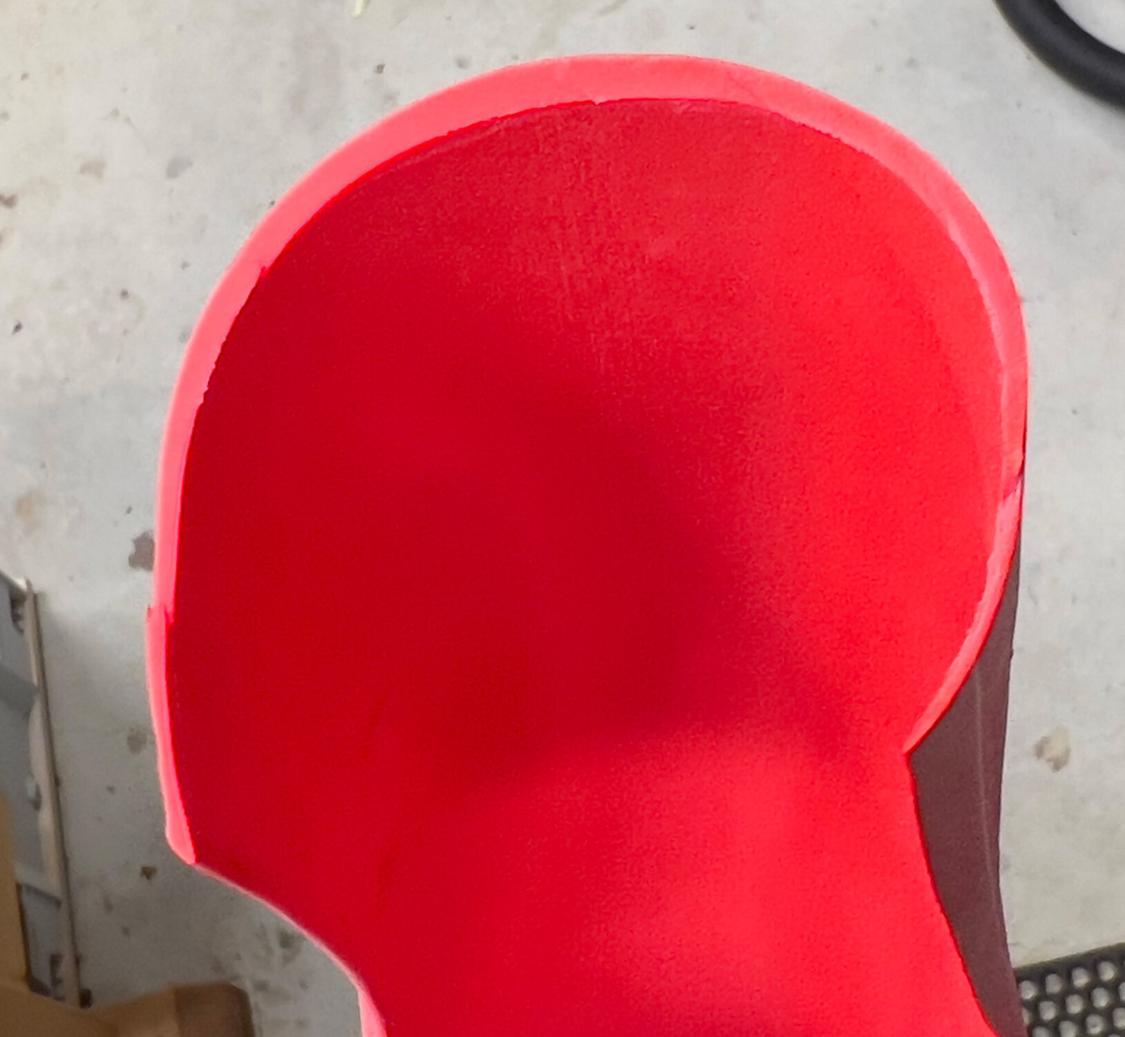

I'm torn on what to do. Looking at the Tannus Armours now, they have compressed and so they're not adding near the protection they were at first, maybe 4mm thick now? I'll try to remember to measure their current thickness later.
Which means the "run flat" for a little bit benefit is totally gone.
And the compression means that the inner tube was expanded beyond its original size, which isn't good, either.
I now feel like I either got lucky with the Armours, or didn't need the Armours.
Here's a cross section of my 2.75 year old/2100 mile Tannus Armour:
About 4.75mm at the thickest part
