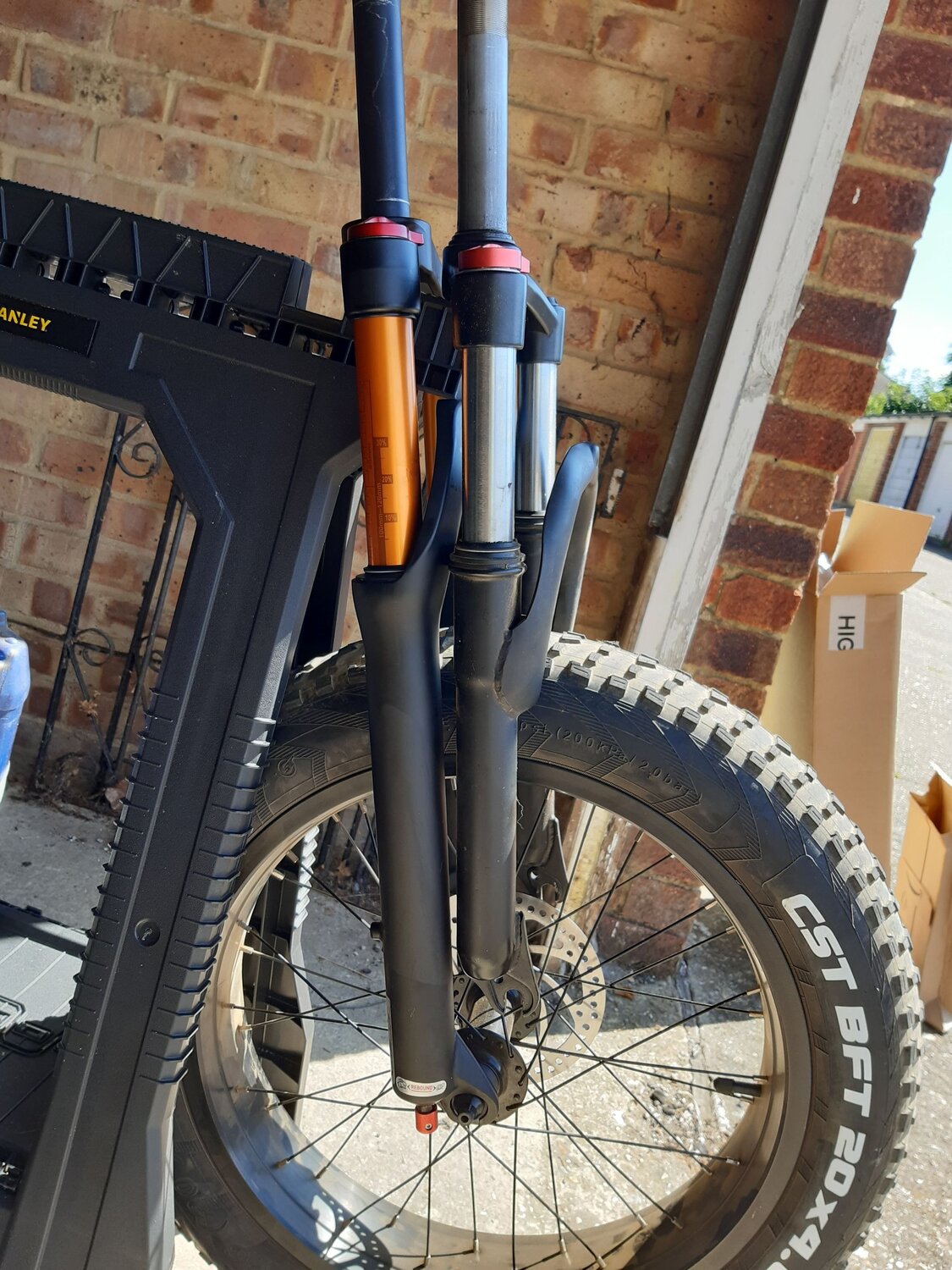

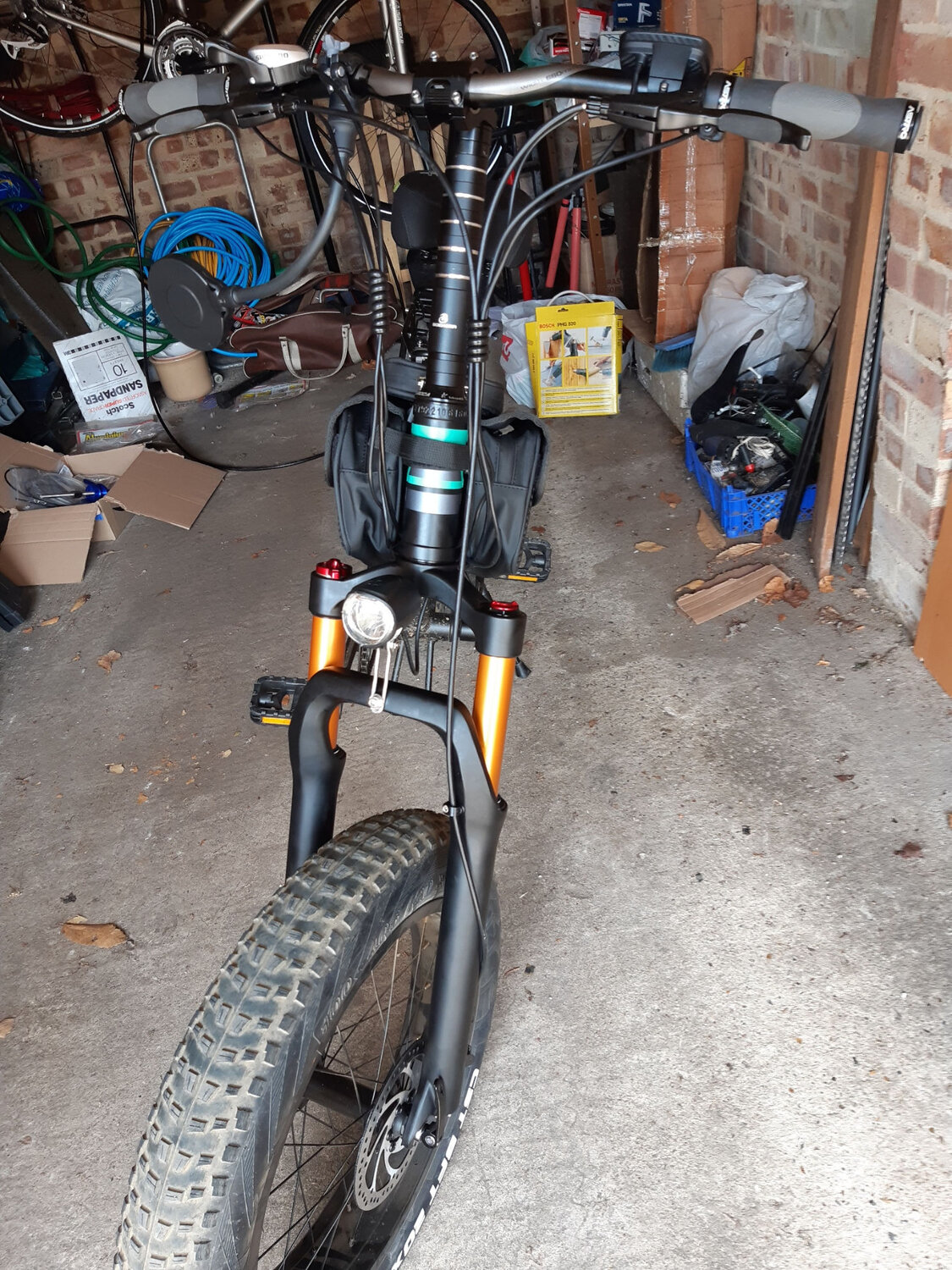

The new fork is a very cheap 26" 120mm Air fork with rebound.
It's replacing the Fiido '20 x 4' 50mm?? sprung fork.
The new fork (orange stantions) adds at least 100mm height to the front end!
...and is half the weight of the original fork.
I'm used to road and hybrid bikes and not seeing the top of a 700c tire far in front is still bit disconcerting, hoping a slacker angle might engender more confidence.

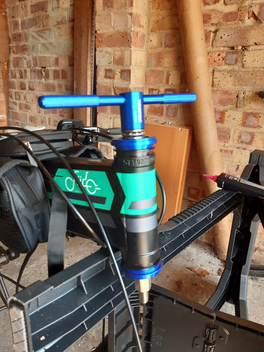

That's also means going from threaded to threadless and sealed bearings.
Just a cheap headset from Amazon, 44mm cups. for the straight 1 and 1/8 steerer.

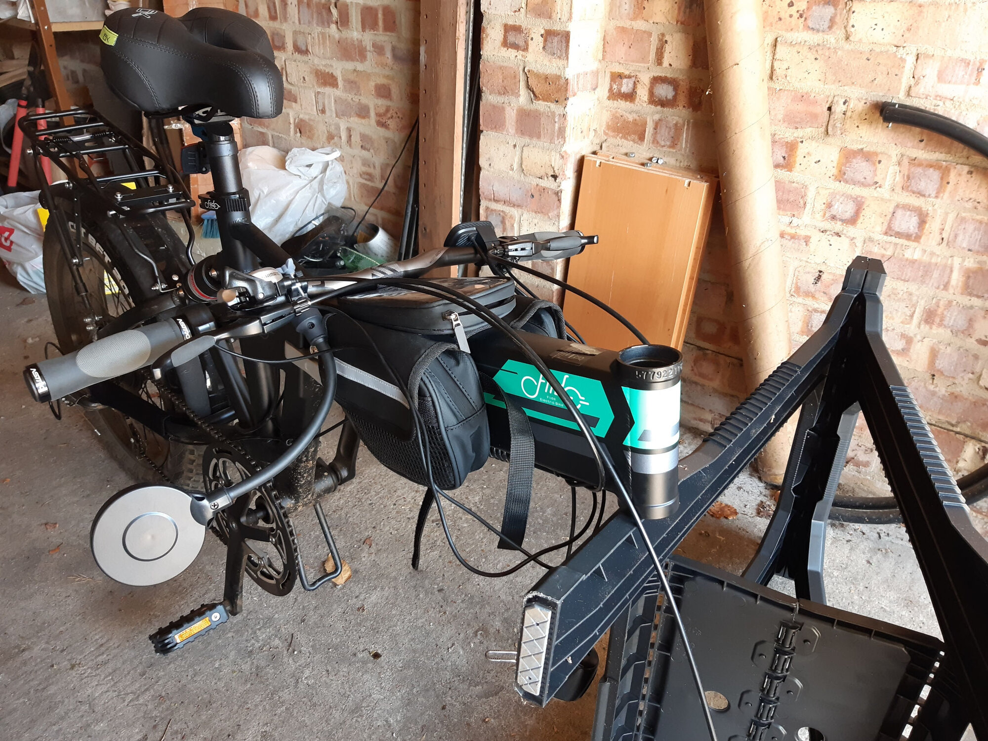

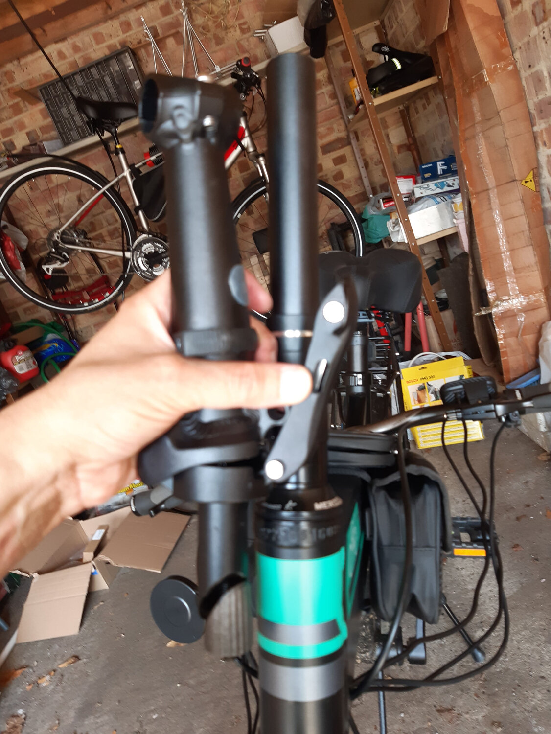

I could not find a new folding stem they were all quill fitting, like the original is.
So I'm forgetting about folding and just going with a steerer extension (and another 50mm in height!)

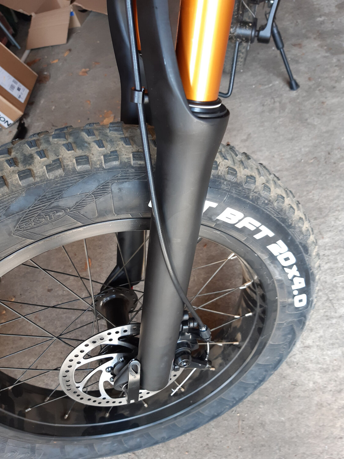

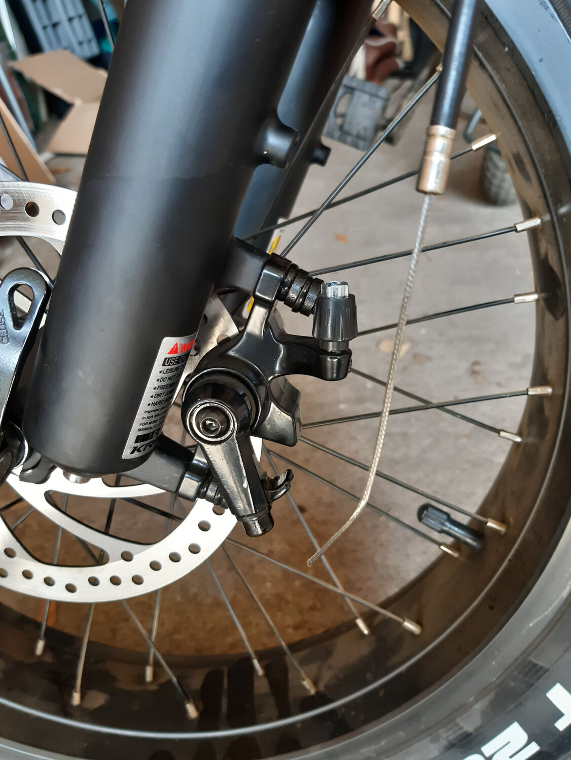

All that height meant the front brake cable needed to be longer.
and it is now routed in front of the fork.

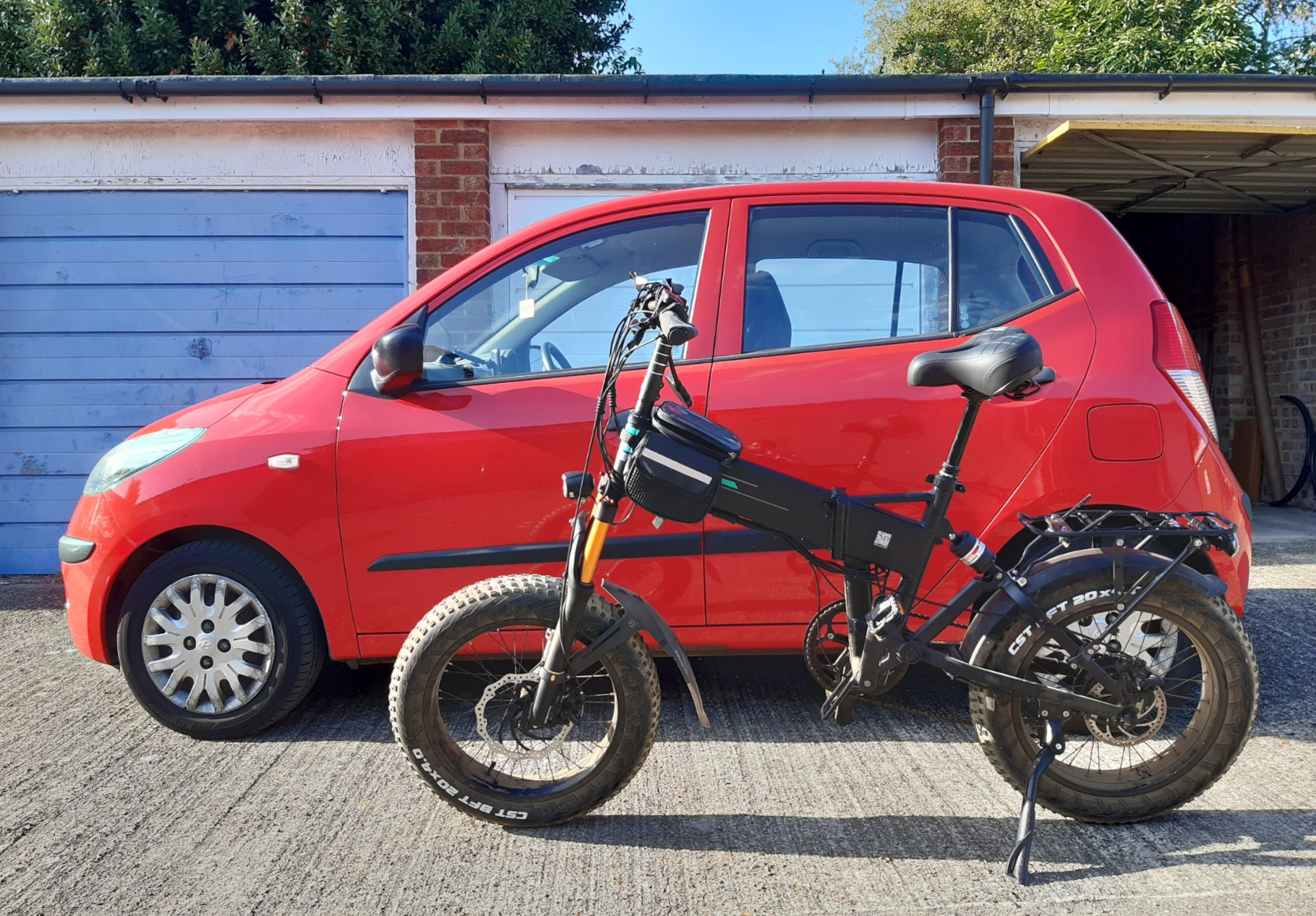

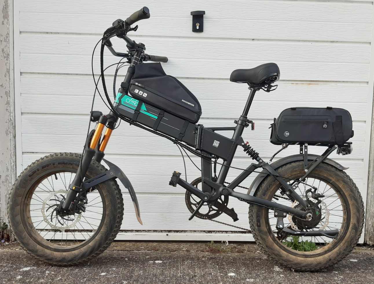

This is the result.
next project: a dropper post maybe?

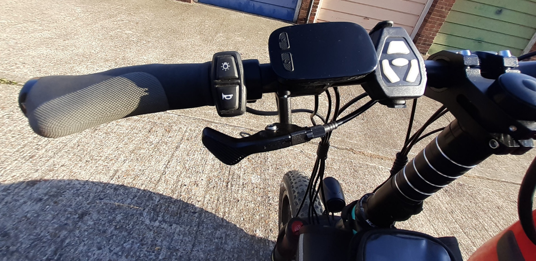

The lever fits conveniently on the left.

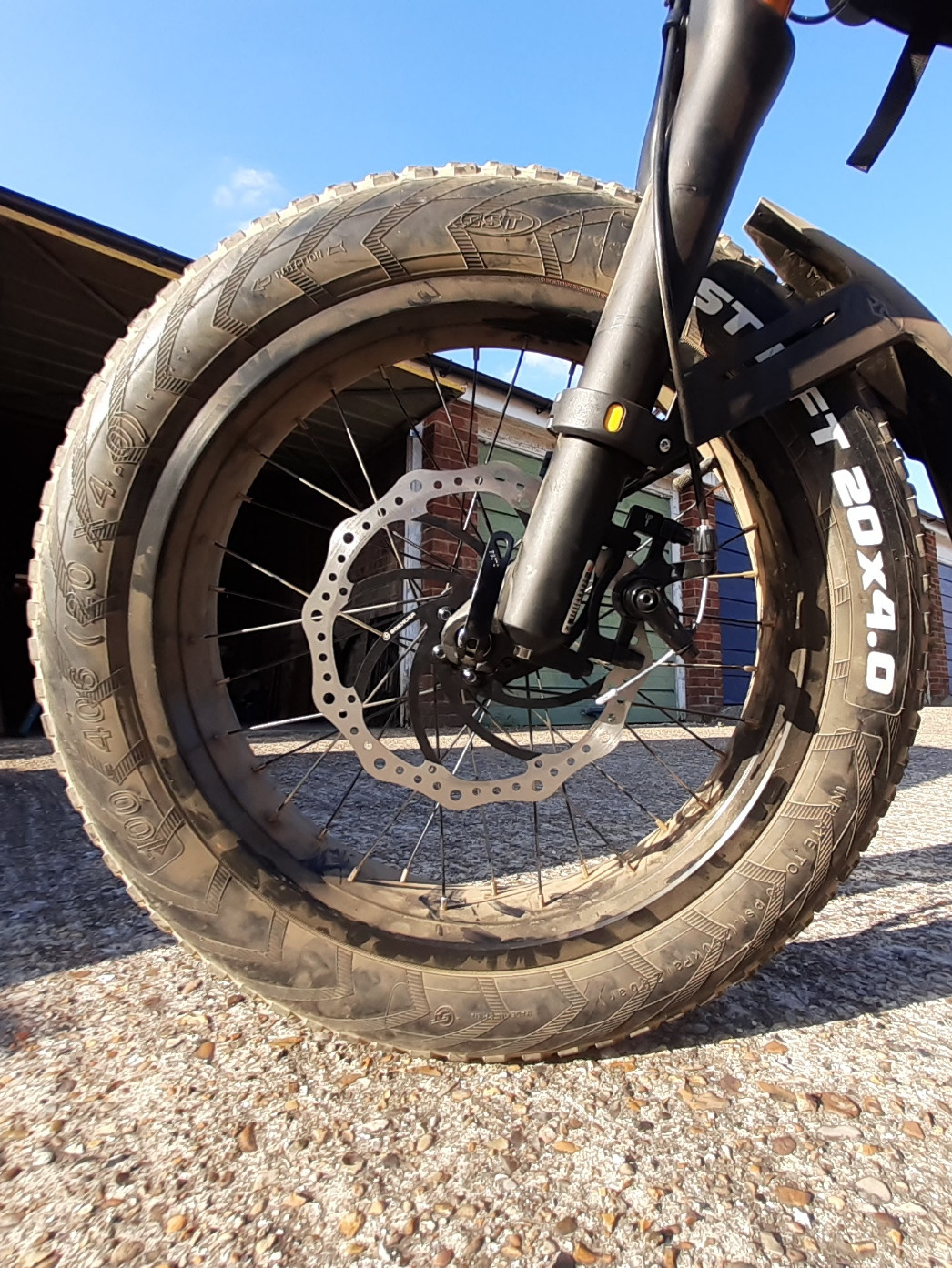

Went from a 160mm to a 203mm rotor on the front. Left the rear at 160mm.
Is there a danger of the fork snapping at the crown??!!??!? 🤔
