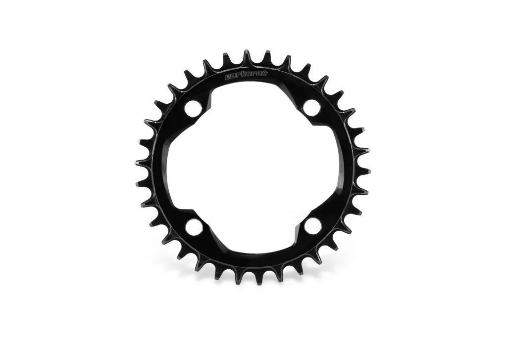

Joe, you could try looking up such a chainring from Garbaruk:
Garbaruk is a world famous manufacturer of top-end drivetrain components (I use a 42T Garbaruk chainring on my Vado, and can highly recommend the brand).
If you are looking for a cheaper alternative, Deckas is another relevant brand.
In any case, you will not be able to reuse your chainguard. Also, the Praxis ring is conveniently mounted with the bolts screwed from the outside (no nut) as the Praxis ring comes with threaded bolt sockets. Any other chainring requires using "1x MTB chainring bolts, 8x8 mm". These come from Woolftooth, Truvativ, Rocride, Origin8... These bolts are sold in packs of five (I think one of them is a spare). The bolts are equipped with a nut.
Now, installing the chainring with the bolt & nut is a little bit tricky on a Vado as there is a very tight clearance between the chainring and the frame/motor cover. I was replacing the Vado chainring twice (to 38T and then to 42T) and the thing is doable. Even if a dedicated wrench is required to keep the nut stationary, it has turned out it is enough to hold the nut with a finger for the initial phase of tightening, and the nut wrench was not necessary. Especially, as the tightening torque is just 5 Nm! (I recommend using a threadlocker such as Loctite Blue to make the bolt & nut vibration resistant!)

Awesome stuff, @Stefan Mikes - thank you very much for the details! I ran across the Deckas in my cursory search, wasn't aware of Garbaruk. And I wouldn't have ordered the nuts/bolts to hold them, so I appreciate this very much. (And I always use Blue Loctite after removing & cleaning my existing chainring, so all good there)

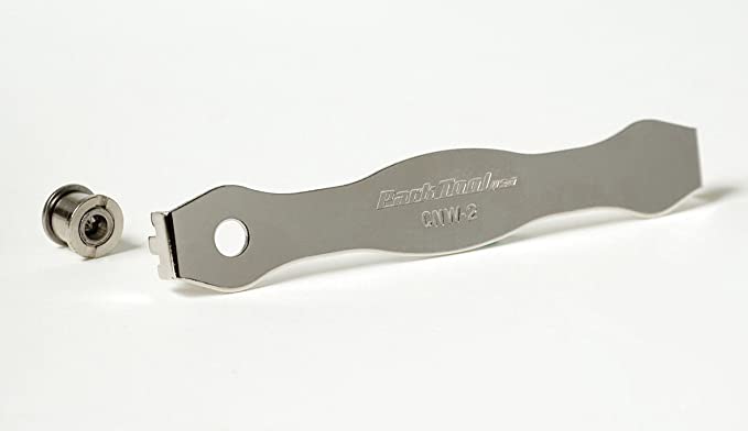

This is the tool I use to hold the nut....works great!
Park Tool CNW-2, about $8 US.

Exactly the thing, @Rider777! However, it is not as easy as it sounds.
The clearance between the chainring and the frame/motor is as tight (at least on my Vado) as I found it impossible to insert the tool end into the gap! With bigger a chainring, it is just a single bolt of four that is not totally obscured by the motor cover (you need to rotate the ring to be able to work on the next bolt in sequence). With a small chainring, I actually had to remove the motor cover to get some access to the nut! Fortunately, the steel RocRide bolts I could buy at that time (in a bigger quantity) were almost self-tightening. That is, I pushed the nut into the hole from the rear, and was just holding it with my fingertip while tightening the bolt from the front of the chainring. Then the nut (like) grabbed onto the ring and I could eventually tighten each of the bolts to 5 Nm (the cross-wise way).
Way later, the Specialized shop had to re-assemble my Vado using a new bare frame to satisfy the lifetime warranty claim on a cracked frame. To keep it simple: they returned the newly rebuilt Vado with all original components that could be re-used. That included my ring and the bolts!
