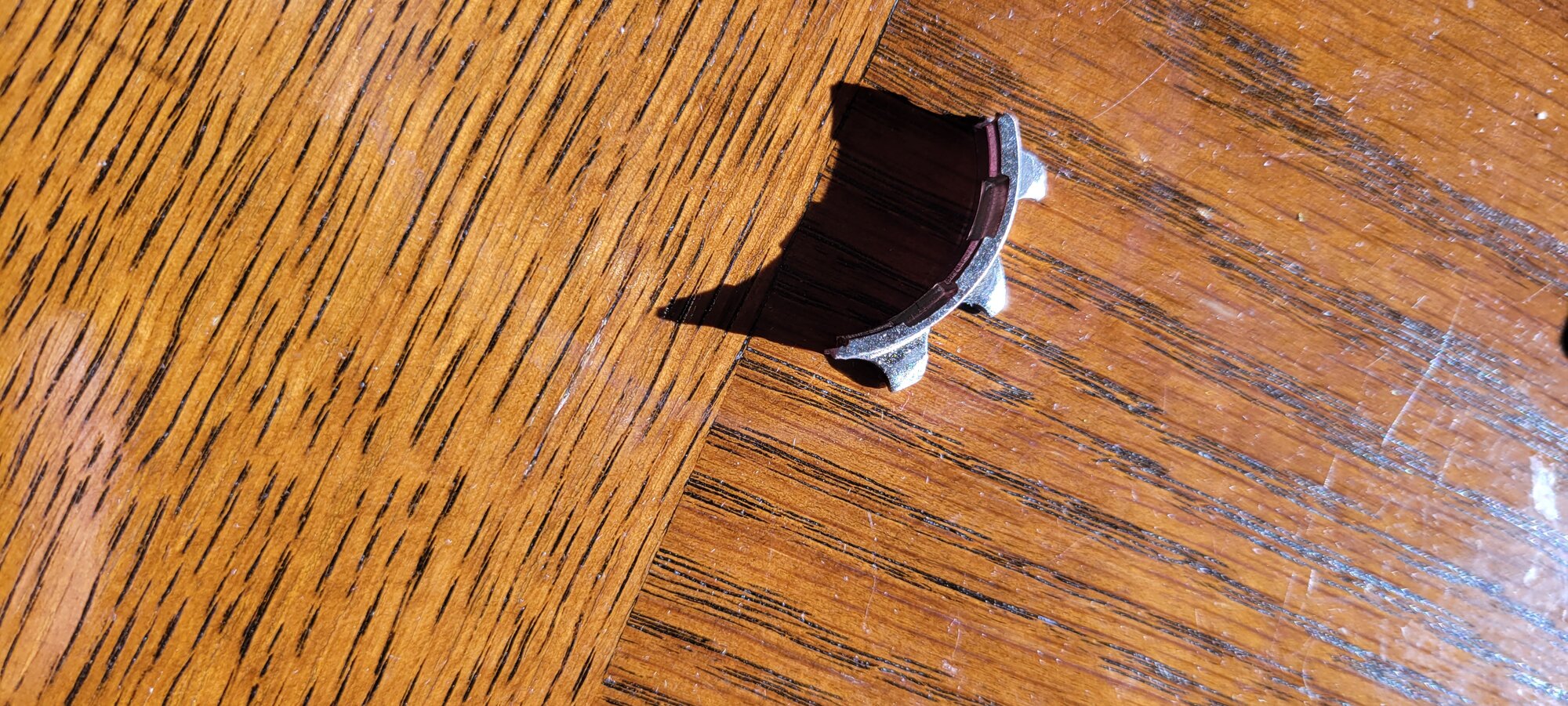

My city md broke 7th gear ring on cassette shifts hard going up steep hill because of hesitation causing loss of momentum. 45klms on it!
Salty, straight talk. Not trying to be harsh. That motor is capable of huge torque. When that torque is applied to those smaller gears in the cluster in a harsh manner, the load is spread out on just a few teeth as compared to when you are running in lower/larger gears. THAT's what broke that gear.
I get the hesitation you're talking about. Very familiar with it. Though you do need to pause a bit while shifting gears for a smooth shift, pretty sure you can do that manually. Also pretty sure it's possible to disconnect the shift detector if you like, though I don't recommend it. Note that if you are going to get along with this bike, those shifts are going to need to be clean. Every one of them. They will simply not tolerate anything less. Trying to run with the derailleur out of adjustment can be another cause for harsh shifting.
Rather than being down for weeks getting a free replacement under warranty, I would suggest you have a shop or somebody that knows what they are doing, check out the part you need, then purchase it from somebody like Amazon. There are dozens available, some with very subtle differences, and if you want to get the right one the first time, be very careful which you order. The MD is new, so I can't be of any help there. I don't know what they are using. New cluster about 25 bucks American.
Best of luck! -Al
Best of luck! -Al
