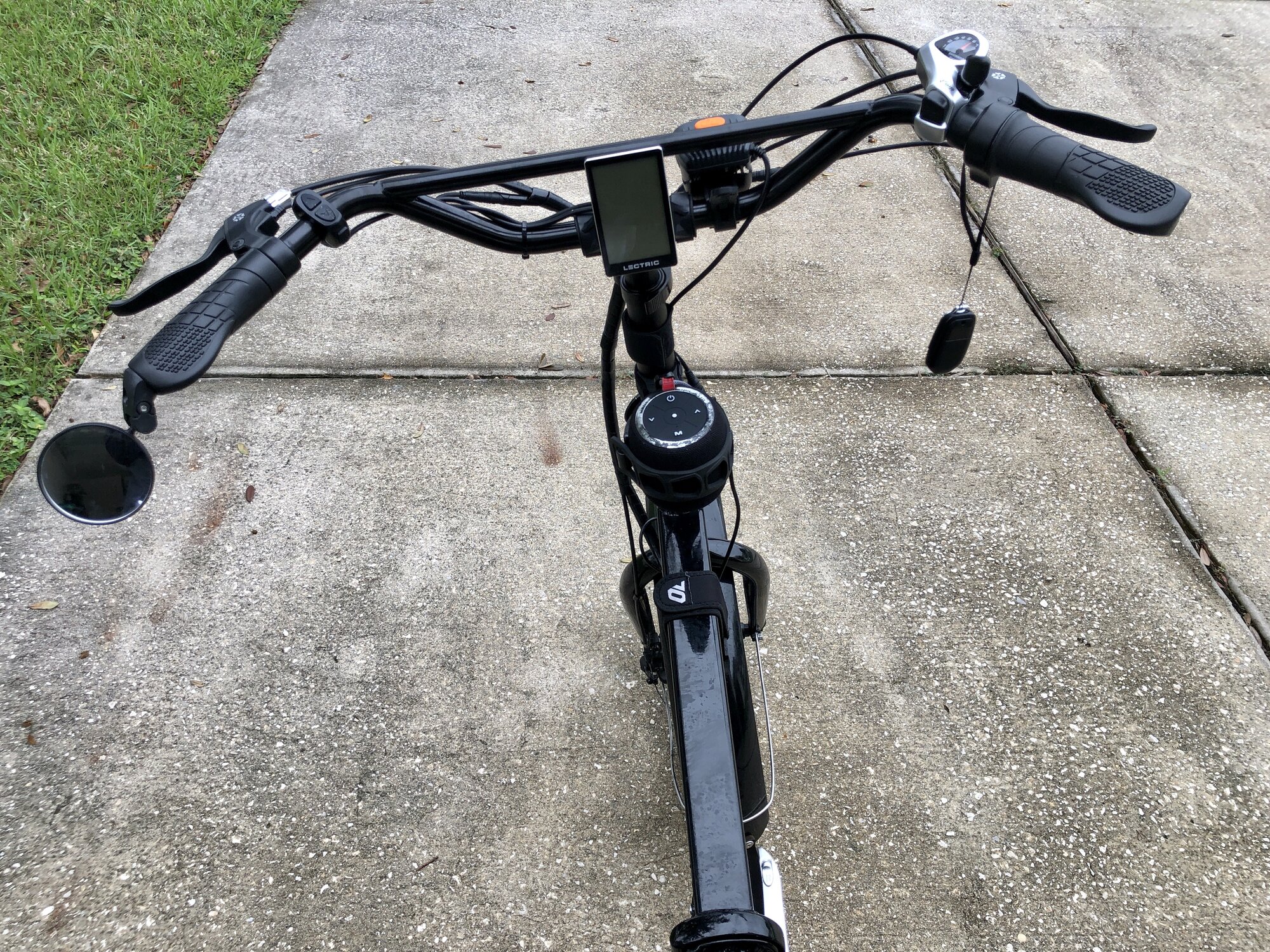

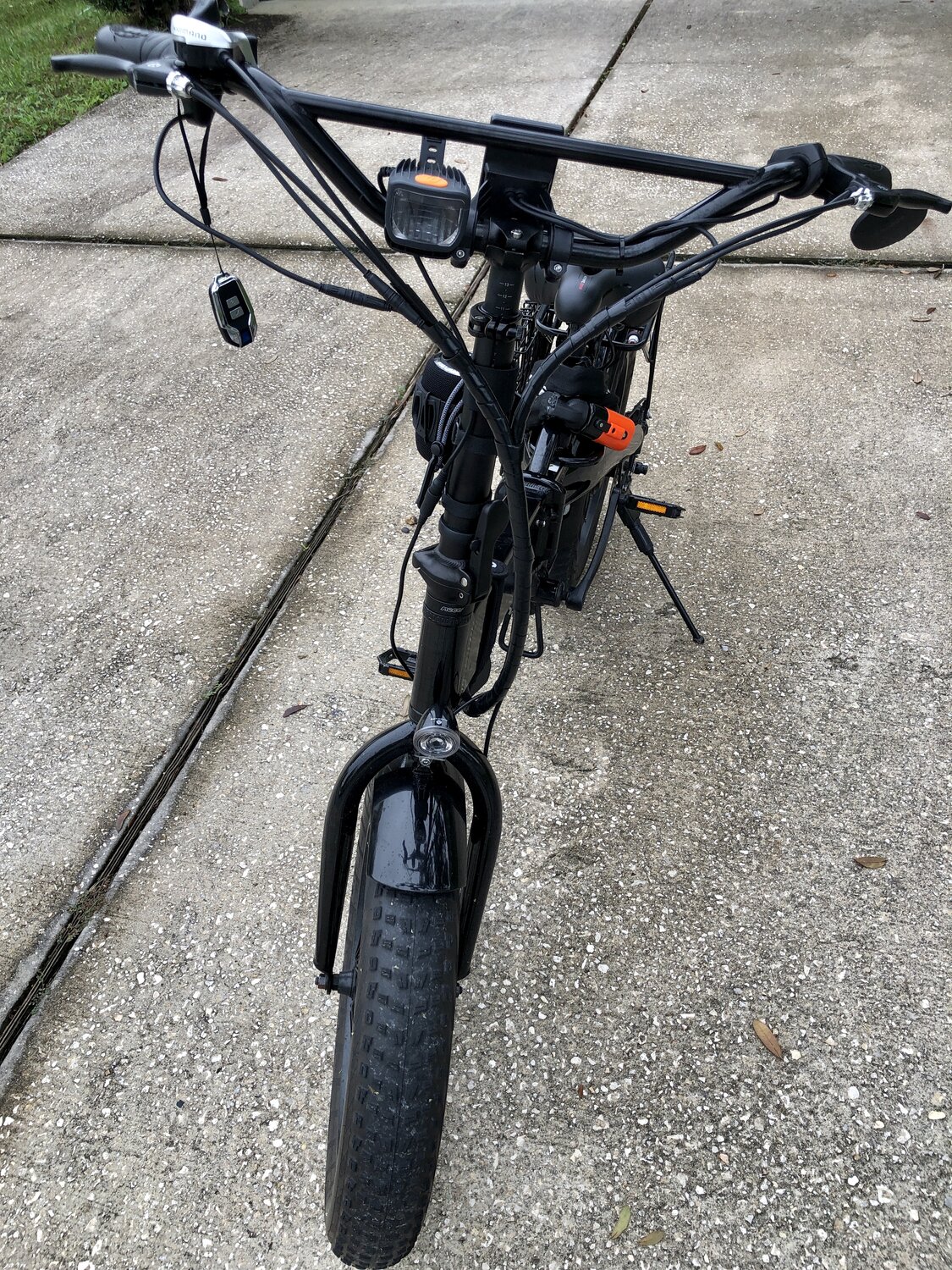

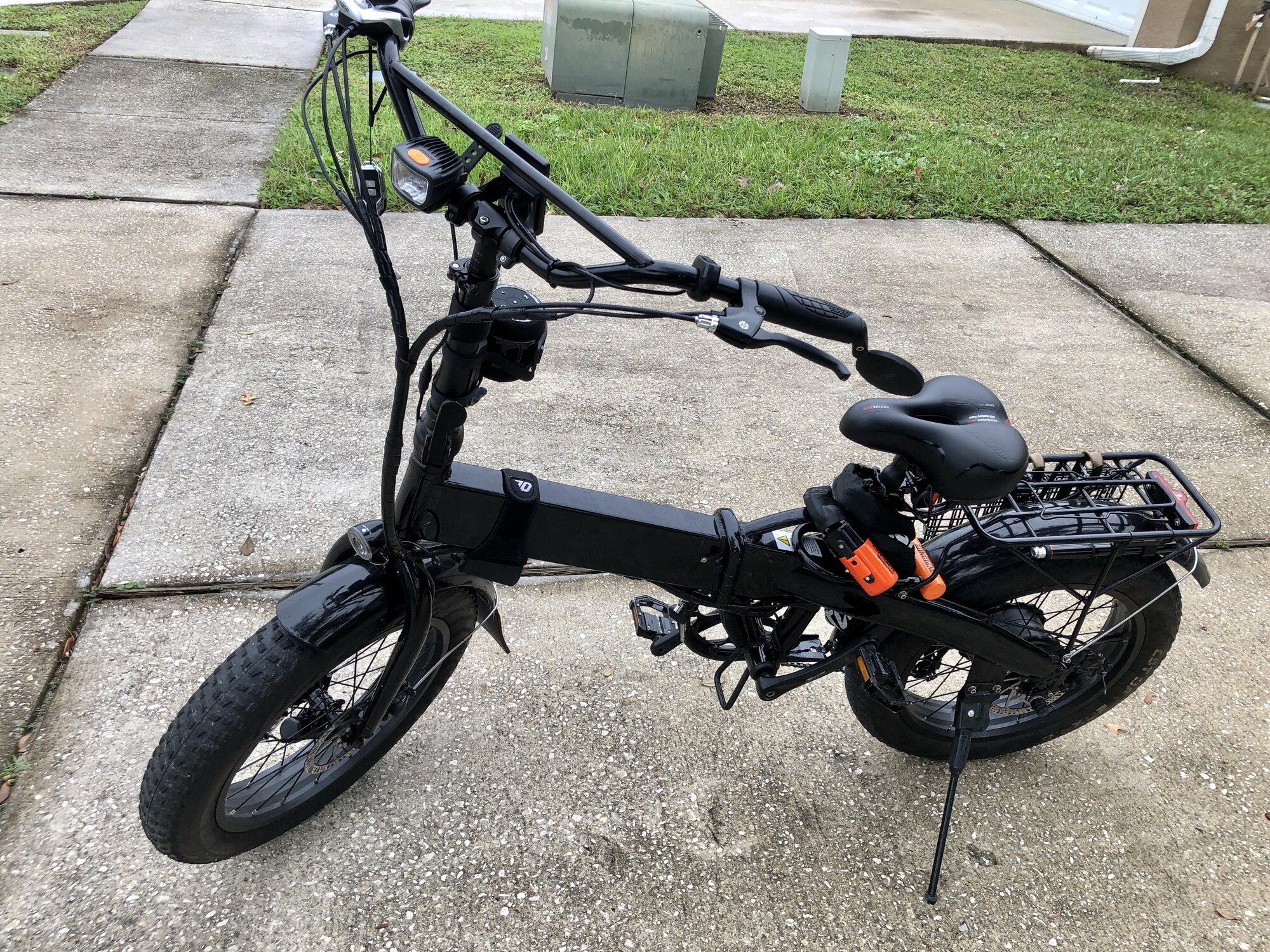

I went with this bar https://amzn.to/3ne89Aw
The width of the stock bars was fine for me so I just wanted a slightly longer bar so I could fit more accessories on it but not too wide because it'll be harder and slightly more dangerous to get through doorways, stairways, areas with lots of trees or people or cars, etc. hitting your handlebar against anything while riding sucks and I already bump by bar ends all the time as it is so I didn't want to make it much wider.... And I went with a flat bar to gain back some of the real estate you lose with the center bends on the stock bar, since you basically lose that area due to the bends.
With the new bar I've been able to add bar ends, flash light mount, one leftside rear view mirror, and cell phone holder with a small amount of room to spare. I can't think of anything else I need to add to the handlebar so I think I'm set for now.
And I think the position of my hands is pretty much the same since I just raised the stem to make up for the flat bar with no rise.

Hello @ki11a I just saw this post and saw your bike. Looks great! Can you tell me what mirror you have? What size it is and if it would fit the factory handlebars? Thank you.
