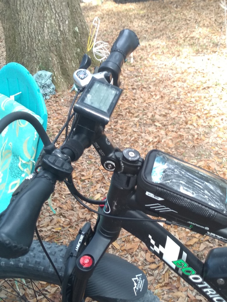

Hi Gypsy. Sounds like you got a great deal. What brand/model stem extender does your bike have? I'm 6'5" and it looks like the handlebars need to be raised if I am going to be comfortable on this bike. Thanks!
Actually that stem extender did not work out. I ended up with a unit that allowed for multiple angles on the rotating headset. I am going to experiment with sweep back bars next. When we changed out forks it was mentioned those long extenders can put pressure on the lower race. I would not opt to use that extender again. That said, I'm like 5'9 :)stem.jpg
Actually that stem extender did not work out. I ended up with a unit that allowed for multiple angles on the rotating headset. I am going to experiment with sweep back bars next. When we changed out forks it was mentioned those long extenders can put pressure on the lower race. I would not opt to use that extender again. That said, I'm like 5'9 :)View attachment 46447
Thank you for your response, Gypsy! 2-3 inches of height would probably do the trick for me, so a rotating headset might work. Do you know the diameters needed? 1-1/8 for the stem and 1-1/4 for the handlebars?
Raised Handlebars for an Ecotric 26" Fat Tire Ebike
Just ordered two new Ecotric 26" fat tire bikes. I'm 6'5" tall, so I think I'll need to do something to raise the handlebars. Stem risers seem to be problematic, so I am considering a new set of raised handlebars. Does anybody know of a drop-in replacement for the existing straight bars? Also, does anybody have suggestions for getting the leather hand grips off? Thanks!
I believe the bars and headset are std size found on most lower end mtb's. That's what I ordered and they fit. Remember to leave room for throttle if you order new grips ( pretty sure you will. I use to use compressed air but these grips seem to ridged). If it matters, I plan on replacing my bars with ones that have more rise and sweep. Anticipating what will probably be your next inquiry....yes....the forks are a major improvement. You find them on Amazon...they are generic, appearing under several brand names, and run around $140-150. Make sure they are spring/air with lock-out. They will totally save your shoulders from the jarring the ridged forks provide. I looked at seatposts and opted to go with a Brooks sprung seat. As a much younger rider I had Brooks seats on my MtB and Road bikes. Broken in they are really comfortable, although the $15 split center I have on there is not bad. Foam tech has come a long way.
I missed that commentary on the stem risers. I've raised a couple of bikes 1 " to 2" with them. Also used 2" to 4" riser bars in conjunction with them. It's basically style that keeps me from going much higher with the extenders. The spacers are kind of ugly.
Threaded steerer parts are almost always 1 1/8". There are a few older bikes running 1" threaded, but not common at all I believe that the handlebars are either 25.4mm or 31.8mm in the center. The Ecotric 26" fat tire bike is probably 25.4mm or 1". You can easiy tell, because handlebar accessories like grips, throttles, levers, shifters are around 7/8", and if the center bulges big time, then it's 31.8mm.
For the grips, I jam a screwdriver between them and the bars, and squirt some WD-40 down the seam. Wiggle a bit and they come loose.
Thanks, Harry, this information is very helpful. I will let everybody know what I try and how it works out. Being tall sucks when buying parts for a bike!
One more question, Gypsy, if I may... What headset did you buy? From Amazon? I's still having trouble establishing the handlebar diameter for this bike. Thanks!
