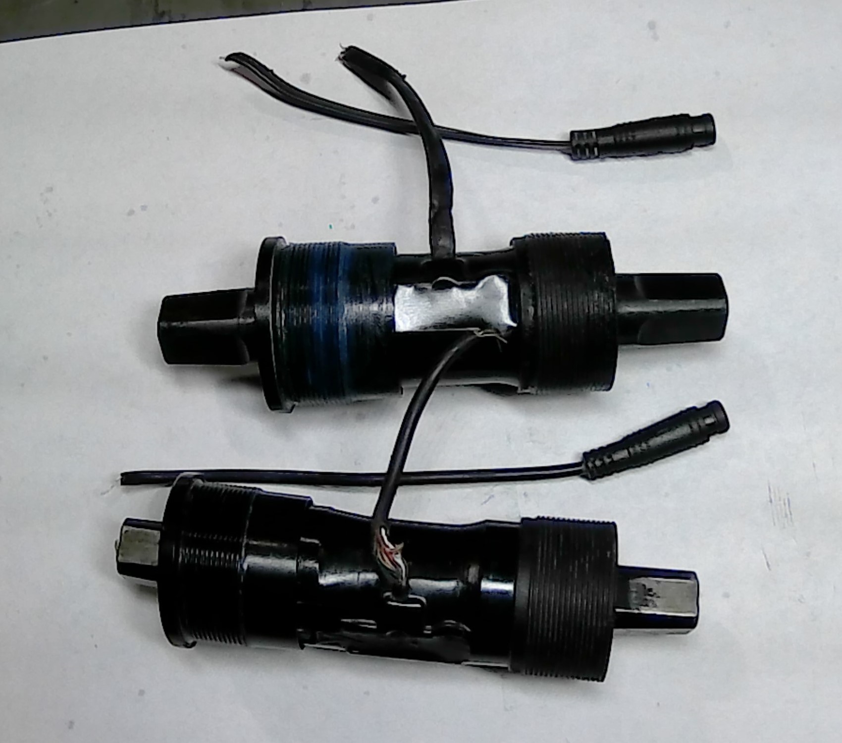

So, after 30 emails, it was decided that BikTrix would send me a replacement torque sensor bottom bracket. And, it was done. When it arrived, I looked it over and, fortunately, discovered the “special purpose” of this type unit AND the very specific/ precise method of its' installation. A piece of cake-- now that I knew its little secrets. By the way, it is possible to install it backwards. That means it will only function when you back-pedal. Then, time for a complete dis-assembly /re-assemble. No fun at all.
So, first, I remove the black control box cover (located on the seat tube) to gain access to the connector. I trace the wire from the bottom bracket torque sensor only to discover that it is completely severed inside the black box. s*it Fire. Now I know why the SWIFT has been acting in “stupid” mode since mile #1.. I disconnect the useless wire. Then, I get out my special crankset/bottom bracket removal tools and commence the operation. Out comes the torque sensor bottom bracket gadget. No problemo. However, to my surprise the wire connection at the bottom bracket is also frayed-- a round 6-wire unit that has been flattened with multiple wires exposed (see the photo at the end of this posting)... So much for “quality control”. The replacement unit uses a flat 6-wire connector-- common sense, fer sure..
But, now that I know who the “e”culprit is (“Quality Control” at BikTrix), I go about installing the new unit. Patience is a virtue (hell yes). Everything goes according to plan.
I re-install the black cover over the control box wiring, etc. I install the ebike 48v battery and spin the crankset.. NOTHING.. Holy s*it-fire. Now what? I remove the black cover and there it is-- the new wire was completely severed. Though I was careful to re-insert all of the VERY MANY wires back inside the cover, I neglected to allow for the fact that the bottom opening (where all the wires exit the box) was not all that wide/deep and also that the base plate had a very sharp edge. If you ever need to open that black cover (Lordy help you if you do), run your fingers along that base plate. See how frigging sharp that edge is-- not razor sharp, but definitely QC “negligent” sharp.
Anyway, the very first thing I do is get my little saw and cut out the entire bottom section of the black cover. Won't ever be having wire decapitation occurring again (I can always use duct tape across the bottom). After completing that task, I removed the replacement bottom bracket unit. I didn't even get 1 wheel revolution out of it. Un-frigging-believeable.
I'm pretty good at dealing with bike maintenance stuff (I've been dinking with bikes since 1983), but this scenario had blown me completely away. Not only was BikTrix guilty of incompetence/negligence/ irresponsibility by specifying this type of sensor on a basic one thousand seven hundred dollar recreational ebike, but, by default, so was I.
I should have caught the deviation (torque vs cadence) when I first perused their website when considering the purchase of this one thousand seven hundred dollar ebike. But, then again, who would have factored in such a “trivial” item??
Now, onto the internet to email BikTrix in regards to my latest adventure. After explaining my debacle and pointing out their unacceptable “quality control” system (also referenced in post #1 and #2), I received the following reply:

FILE0005.JPGIn regards to the photo: the unit at the bottom is the original installation. Magnify the photo and examine bottom bracket/wire juncture. See the flattened/frayed wires? Also, notice that both wires have been cut at exactly the same length (going into the black controller box). BikTrix “Quality Control” at work..

View attachment 75683In regards to the photo: the unit at the bottom is the original installation. Magnify the photo and examine bottom bracket/wire juncture. See the flattened/frayed wires? Also, notice that both wires have been cut at exactly the same length (going into the black controller box). BikTrix “Quality Control” at work..
HAPPY HOLIDAYS
The wiring harness looks like a simple solder and shrink wrap repair.... Are the wires not color coded well enough?
Its a very simple repair and I could do it but am hesitant that they may not function if they have been back fed voltage. I can repair them and you only pay if they work for you. You cover shipping and $50 if they both work.
We have the M2S Scout and it has been a solid bike from unpacking to now . I also Have the Eunorau E-Torque and it has torque sensing instead of cadence and it has been a great bike from the git go . My wife loves it . I have a Eunorau AWD fat bike which after I figured a small problem out has been a great bike and three BBSHD built bikes that have all been great . I have an Ultra FS bike also . So as you can read , I have an ebike problem . I'm looking to either sell one or buy another cause I hate uneven numbers !! lol

6. You also post pictures of 2 torque sensors - both with freyed wires.
We have sold 10s of 1000s of bikes with this torque sensor (Swift and Stunner LT). Of these, we have had less than 0.5% issues with the bikes which include torque sensor issues. The freying you've seen can easily be duplicated on more sensors, if the sensor was uninstalled improperly from the bike. There is exactly 1 way to install and uninstall the torque sensor on these bikes due to the limited room in the bottom bracket and if not done properly, the wires will get freyed or even cut.
From my answers above, you'll see that the initial issues that you were having weren't really torque sensor related issues. It could have been fixed by tweaking the torque sensor parameters like sensitivity etc.
I would not recommend going with alternate torque sensors as we cannot guarantee that they will work for you.

[[[ Oct 27, 2020
Hi,
Here are some of the items I'm dealing with in regards to my 2020
SWIFT at mileage 2,000+:
1). On level ground and cruising (not pedaling), occasionally the
power suddenly kicks in for 1 or 2 seconds. This is rather unnerving
since I am not anticipating same (hand off handlebar to click + or -,
etc).
2). Going up an incline (equivalent to a highway overpass as far as
gradient) and shifting rear derailleur from 3rd to 2nd or 1st, the
power cuts out (feels dead) but everything is still “on” . The only
way for me to get added boost is to press and hold the thumb throttle
for the duration. This takes ALOT of battery consumption. Increasing
PAS from 5of9 to higher does nothing.
3). When transitioning from sitting to standing while pedaling,
sometimes the power cuts out for a few seconds. This is dangerous in
the sense that I can be thrown forward (over the bars) if I'm not
alert.
4). I need to use PAS 5 of 9 on smooth level terrain. Any “climb”
requires 8of9, or even 9of9. I ride at weight of 200 pounds. Shouldn't
I be able to use lower settings PAS 2 or 3of9, etc? My speed is
usually at/below 15mph-- I'm just a cruiser and I seldom use/need the
thumb throttle..
5). (See photo's) I currently have a white crankset installed on my
SWIFT. I notice that the original black crankset has the rippled
silver ring at the axle hole. Is this ring part of the “torque sensor”
system?? If so, is it possible for me to get just that rippled ring,
or do I have to use only that original black crankset in order to have
a working/ trusted torque sensing setup?
Also, do I have the option of being able to install a normal
ebikes magnetic ring/electronic pickup (flashing red light) system at
the bottom bracket axle, if I choose to do so. I know that cadence
sensors have this setup.. Just wondering..
I own many ebikes and use many custom items (like the white
crankset) on them. Flexibility is the name of the game for me..
That's all for now.
Xxxxx ]]]

Email from BikTrix to me on Dec 1, 2020
Ricky, Dec 1, 2020, 10:34 CST
>> Hi XXX,
>> Apologies for the delay.
>> We can provide you with a new torque sensor if that is what you mean by the
> bottom bracket. Please confirm.
>> The cost for the torque sensor will be $200. If you cover 50% ($100) we can
> send it to you free of extra shipping fees right away. Let me know if that
> works for you and I will send you the invoice.
>> Have a great day!
>> Warmest regards,
>> Ricky
So, let's see, it has now been 52 days since I sent BikTrix that $100.00 and I am still waiting for the sensor. Roshan: a true Canadian “professional businessman”. And a joke, for sure.
