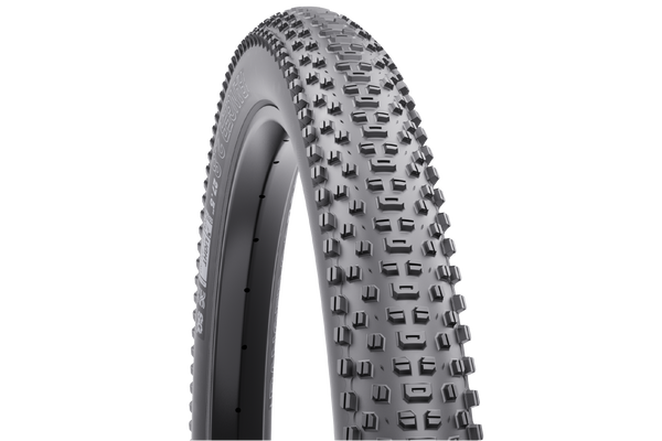

Ranger 2.8/3.0
Searching for the ultimate do-all tire to satisfy your plus-size needs? Meet the Ranger…you’re welcome. Limitless traction, increased confidence and multiple usages make the plus-size Ranger ready for any challenge.

My reasoning for doing this is to create a more nimble and agile bike. I am not expecting to turn this into a hardcore off-road mountain bike, but rather something that I would take on gravel, very light trails, and Jeep paths. I am not looking to take this over roots or boulders.
My ultimate outcome is a bike that is simply more nimble, easier to dart in and out of cars, and ride around town or commute. I hope to end up with something easier to navigate.
