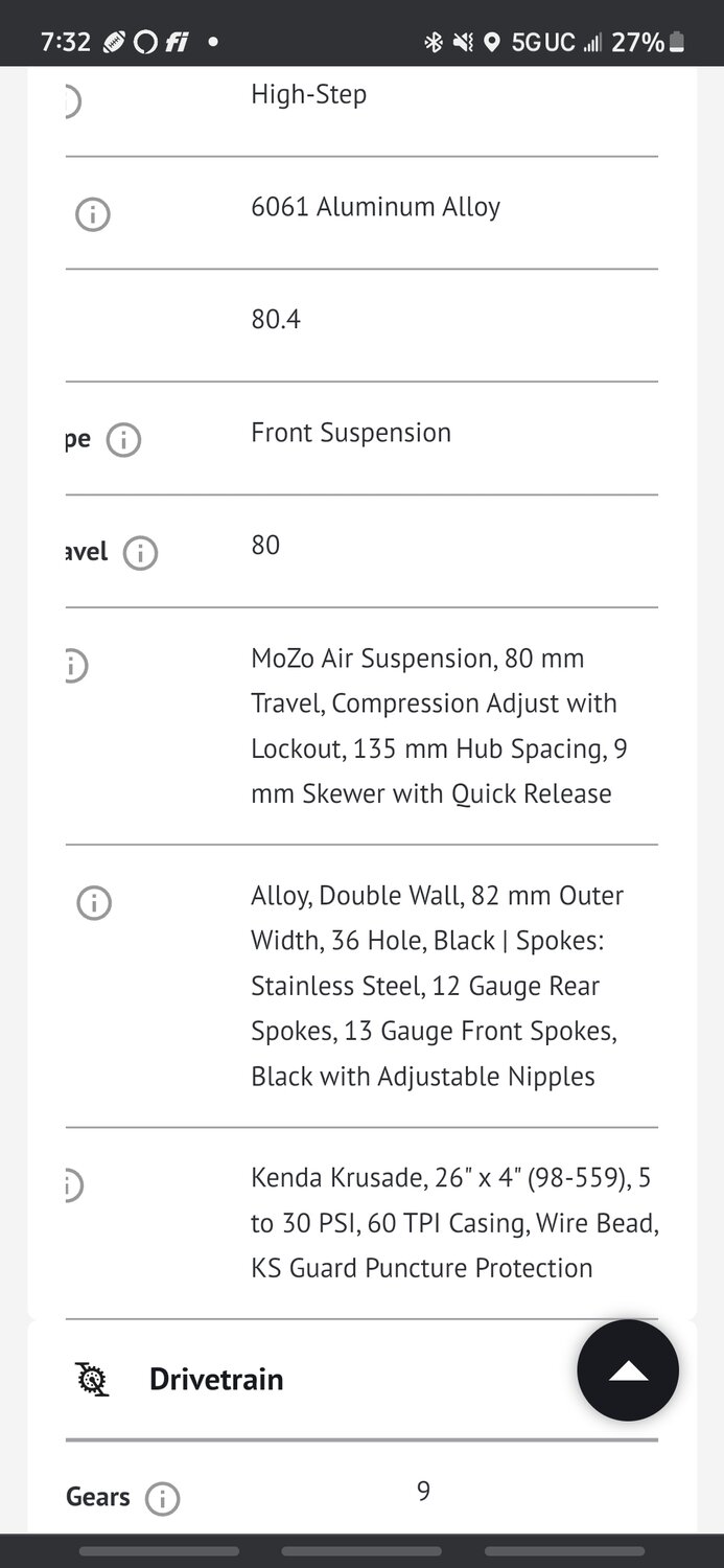

I'm looking for advice regarding the wheel size conversion for a Juice Rip Current S that I recently purchased.
As you can see in the photos and pictures below, the bike comes standard with 26x4 wheels. I would like to convert the bike to 3-inch wide tires while keeping the bike's original geometry as close as possible to stock (bottom bracket clearance, set height). I do not want to modify anything other than the wheel, and I understand that this will require rebuilding the wheels.
My thought was 27.5 x 3
Here is something I found that seems promising (would this work?)

My reasoning for doing this is to create a more nimble and agile bike. I am not expecting to turn this into a hardcore off-road mountain bike, but rather something that I would take on gravel, very light trails, and Jeep paths. I am not looking to take this over roots or boulders.
My ultimate outcome is a bike that is simply more nimble, easier to dart in and out of cars, and ride around town or commute. I hope to end up with something easier to navigate.
I would appreciate any suggestions or advice you may have.

Thanks for the reply, so it sounds like you have a mid Drive Fat Tire ebike, I have a hub Drive so I'm trying to figure out if I'm going to be able to build the rear wheel of a 27.5x3 rim with the Juiced rip current s1000 watt motor. The rim that comes with the bike is 83 mm internal so I want to make sure that the 27 by 3 in Rim is going to be able to support the Hub motor
