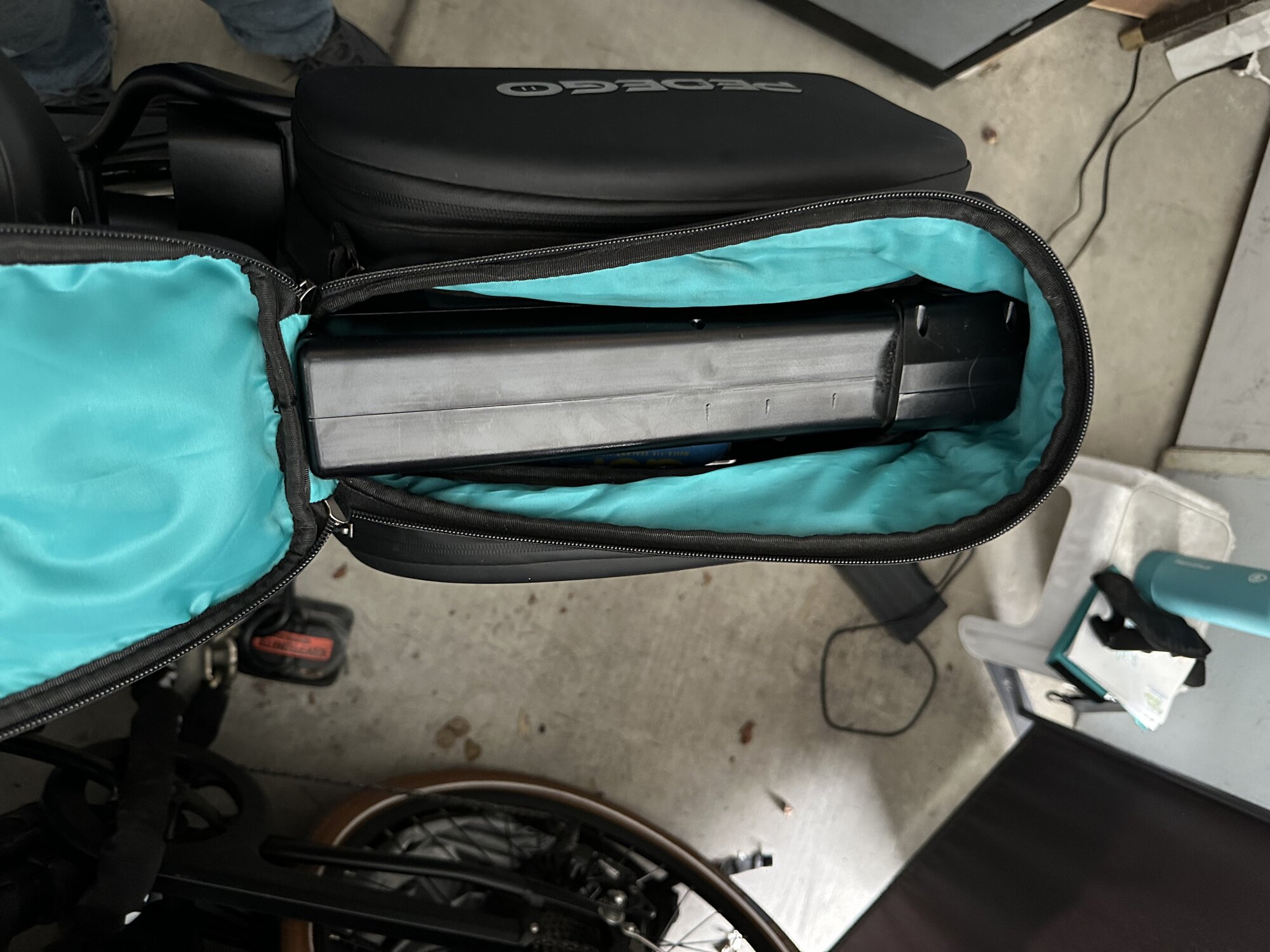

This is an old thread but I came across it when searching and discovered that I was able to put a spare battery in the convertible bag. https://pedegoelectricbikes.com/product/pedego-convertible-bag/
I had to expand the top (zippered expansion) and was able to put the battery in sideways. It definitely added weight and I felt it slightly while riding, but the added peace of mind on a longer ride was worth it!

My wife has that Pedego bag. It's been around for a few years now and it is a quality made product. It's one of the few available that are wide enough to fit the Pedego rack. Since I frequently swap my bags between bikes, my only complaint is, it isn't quick attach, and requires messing around with the Velcro straps. My wife leaves hers attached to her bike though, and she likes the bag very much.
There are several bags on the market that will accept a spare Pedego battery which are quick attach. Unfortunately, they require an adapter to fit the Pedego rack. I also prefer to carry the weight of a spare battery down lower on the frame, usually in panniers. The deployable panniers on all the bags I've tried, including the Pedego, will not carry the weight of a spare battery. It requires the use of separate, heavier duty, panniers.
Thanks for posting! There may be other Pedego owners who aren't aware this wider bag exists.
LOVE that bag. The velcro are a PITA if you try to snag them between the battery and the rack, but they are long enough to go all the way around the battery. I don't do that- it feels more secure looping around the rack. I didn't put it down the side because I wanted the weight centered, but it does make the bike a little "tippy" on the kickstand.
I'm only going to do this for trips that might exceed 25 miles. My battery is 2 years old and I often get home after a 20-25 mile ride with 1 bar so it's really for my "range anxiety"
My alternative solution was going to be to bring the charger and plan on a Starbucks break ... but I like this solution better!
