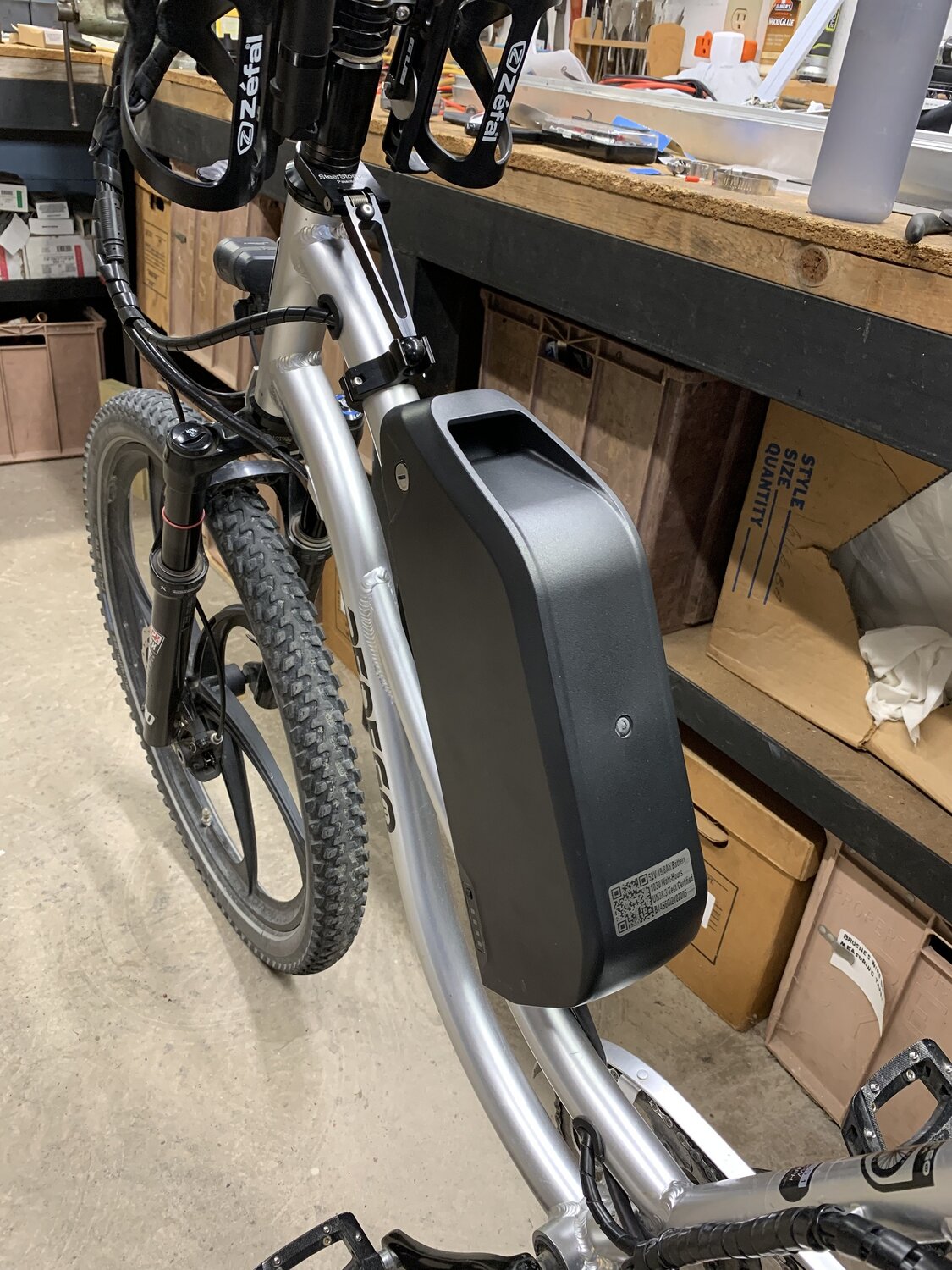

Originally, I did the same thing and only carried the spare battery on longer trips. I have since added a down tube battery and just switch between the two as needed.

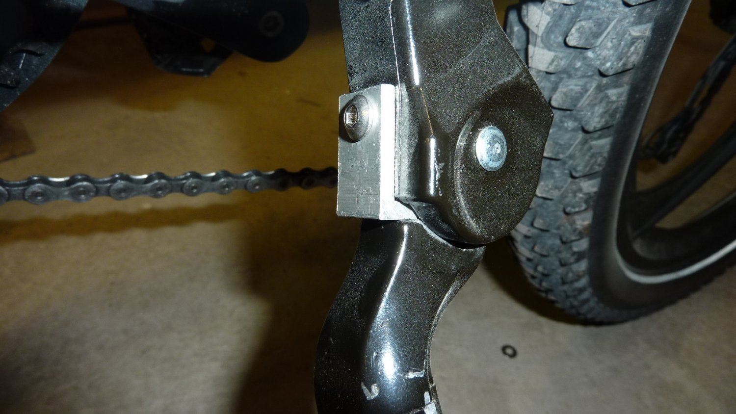

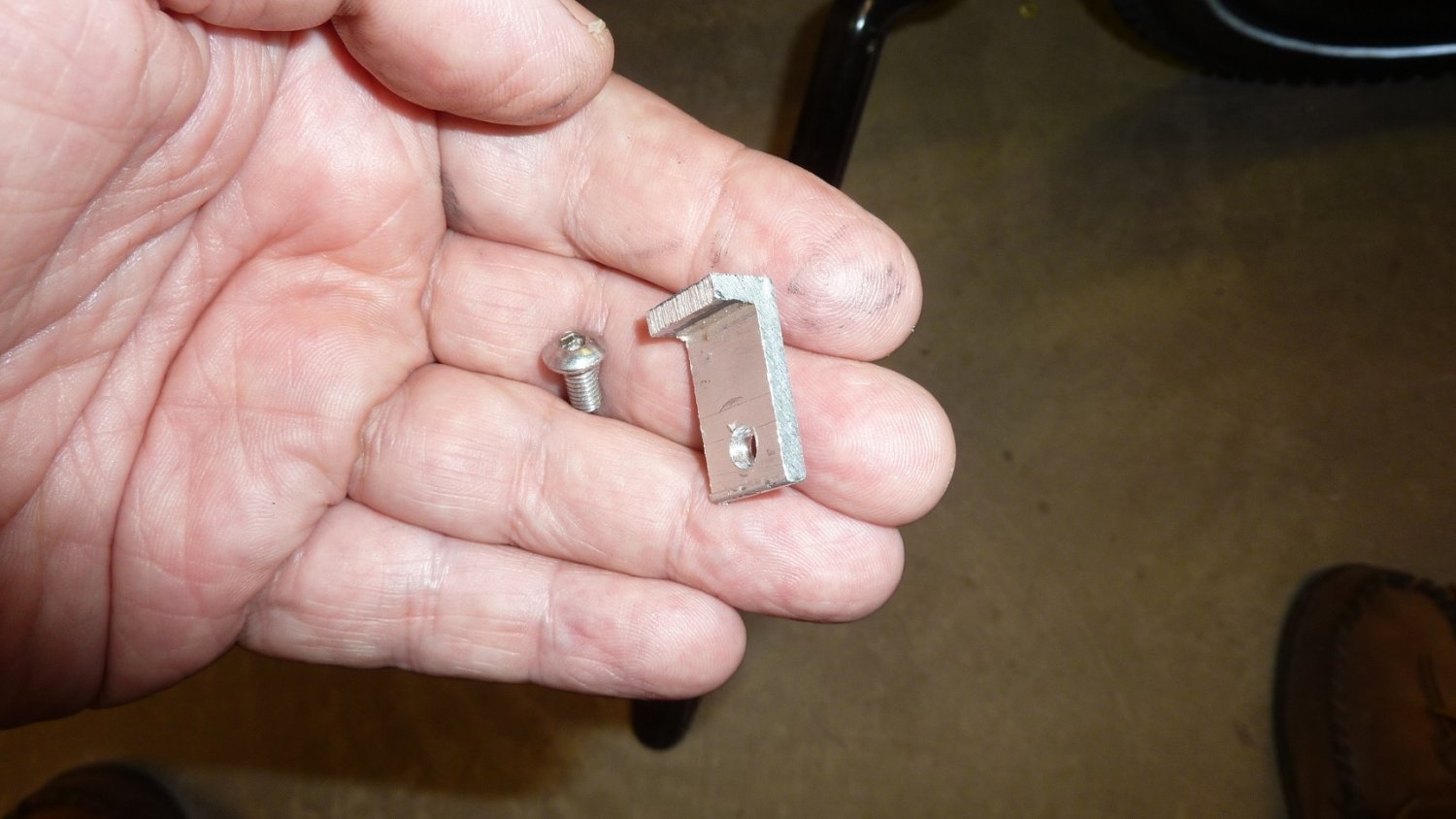

A cheap and simple fix is to add a shim in the kickstand mechanism
I screwed mine on, but a little gorilla glue will work just as well.

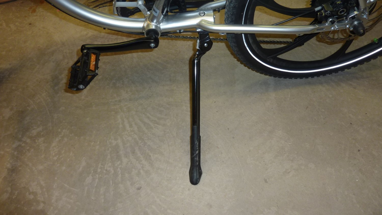

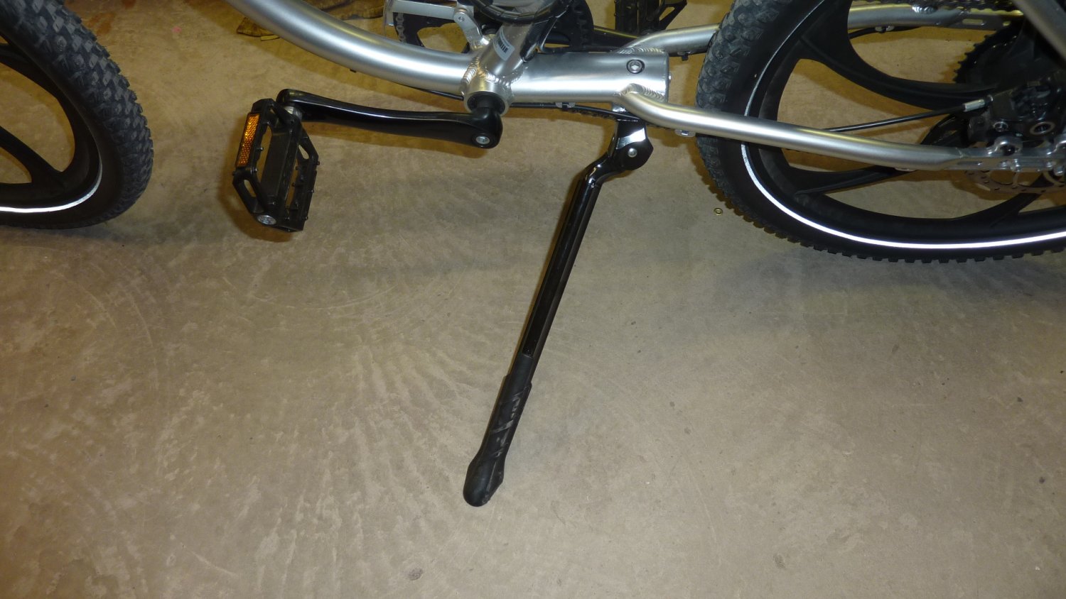

The shim moves the point where the kickstand touches the ground 4" to the rear. This makes the bike much more stable.
There is also a length adjustment screw on the plastic kickstand foot which helps as well.
