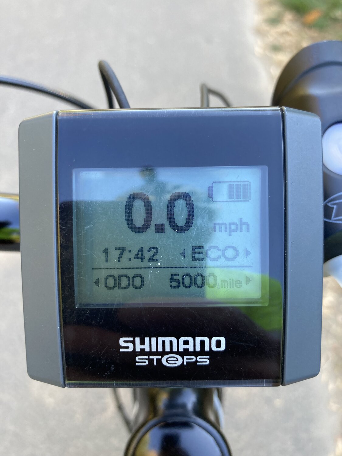

5 year update!
I didn’t ride at the same rate during the pandemic (no commute!) but am back commuting and recently hit 5000 miles on this bike!!!
Everything thing has continued working great.
Tires - surprisingly still on the original tires. I did rotate them as the rear tire was starting to get flat in the middle, probably as the result of my weight, battery and two full panniers with 2 u-locks, a cable, some bike tools/spare tube, laptop, lunch and a change of clothes. I can’t recall any flats in quite sometime. I think I had bad luck early on regardless of tire.
Brake pads seem to need changing every 500-1000 miles.
I did replace both brake discs with the same as stock.
I have some long, winding down hills (I gain/lose 2000ft of elevation on each 24ish mile commute)
I’m just now about to change my chain for the first time.
My riding with pedal assist level has for sometime now about 60% Eco, 40% Norm. I basically never use High mode.
I’ve noticed no changes to battery life or charge time. I do always keep the battery inside. Only consistent is the battery is used up a little bit more when it is cold (30s) vs when 50F+.
Battery life after my commute as described is 2 and sometimes 3 bars left during warmer weather and 2 bars normally I’m the winter/colder weather.
This may be one of the best purchases I’ve ever made.
