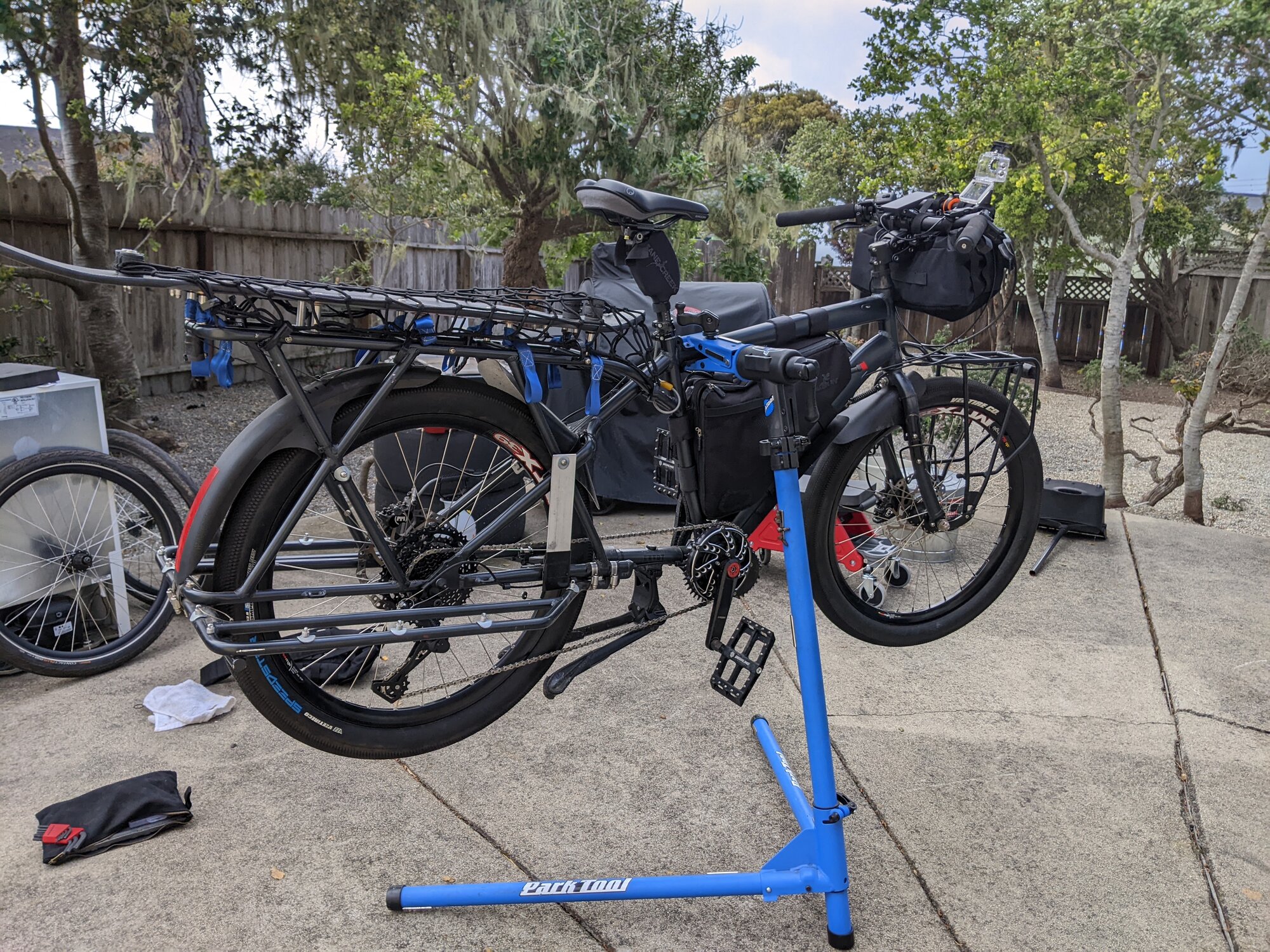

My midtail is the one I use in steep hills in the Monterey Bay area, and I blow past Rad Wagon riders on the uphill (there are rentals here as well as local riders), who I can see are not doing so good pedaling uphill. I recently upgraded to a Microshift Advent 11-46T rear drivetrain so I could get better chain alignment on a bigger cluster. Formerly had a Shimano HG-400 that maxed out at 32T. I can almost pedal without effort if I want to hammer it and peak at around 12-15 mph up steep hills, loaded.

It is a Mongoose Envoy where I essentially used the bike as a frame donor and replaced everything but frame, headset and fork. I did a full writeup on the build in the link below. One page on that series is dedicated to low cost build configs. Something not on that web site is my addition of the Kinekt suspension stem, which is pretty awesome. Couple that to the Thudbuster LT seatpost, the 30 psi 2.8" Speedster tires and the Ergon ST Core Prime saddle and you have a super comfy ride.What cargo bike is that and does it have a throttle?
Believe it or not you don't want full suspension. A cargo bike gets loaded with a LOT of heavy stuff as its job. All that does is compress the suspension to its max while the bike is parked. If you supersize the suspension to account for that, you end up with stability issues, as a loaded cargo bike is a bit of a balancing act as it is, and if you add in a suspension that moves you make a bad situation worse. A mitigating factor is that longtails and bakfiets are ... long. And as such even a rigid frame has more give built into it than any normal bike. So they tend to be surprisingly comfy.I'd love a cargo with the setup and a full suspension.
Thanks, ya I wasn't real clear, I was meaning to say I'll take 2 bikes a FS and a cargo with that setup. I'll send you a message to get details on yours.It is a Mongoose Envoy where I essentially used the bike as a frame donor and replaced everything but frame, headset and fork. I did a full writeup on the build in the link below. One page on that series is dedicated to low cost build configs. Something not on that web site is my addition of the Kinekt suspension stem, which is pretty awesome. Couple that to the Thudbuster LT seatpost, the 30 psi 2.8" Speedster tires and the Ergon ST Core Prime saddle and you have a super comfy ride.

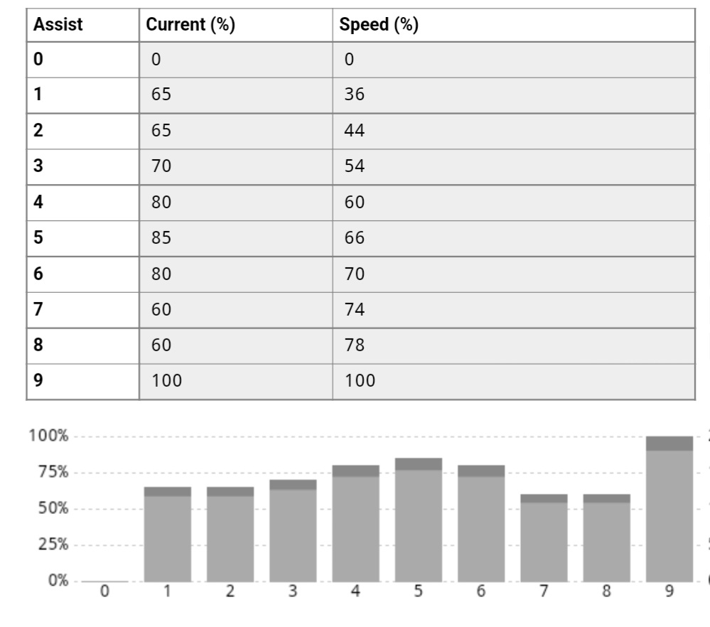

That’s pretty common with 1000W BBSHD motors. Clown pedaling with PAS.Does the bike go so fast that pedaling is ineffective after a certain speed?
That necessarily... does not need to be true.That’s pretty common with 1000W BBSHD motors. Clown pedaling with PAS.
