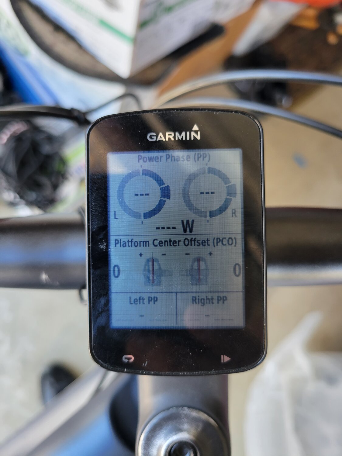

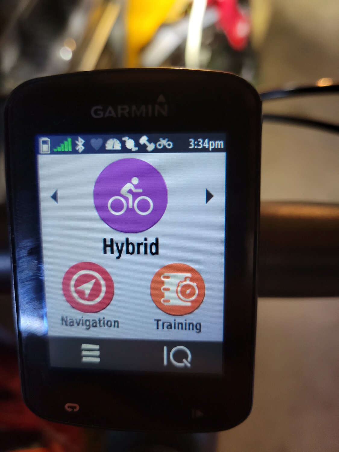

Hi guys I got everything to work on my Garmin 820 i see battery level & assist leve except the power page doesn't show any info can any one help me thanks

Yes all three sensors power cadiance and battrey are connected
I just removed all sensors and reconnected I also downloaded E-bike field from garmin IQ app

I don't think the power page has the right items to read power from the Vado. At least from what I can tell on your screen. You have to add a setting to a screen. 3s Power is the one.

thanks i will look for that in the setting under power i found it and add it hopefully it will work
i searched the garmin website and it mentions needing to have pedals that have sensors is that true?

if you want some of the detailed stats, yes. The bike has a built-in sensor that gives you some info, but probably not as much as a dedicated power sensor.

As Mogulman said, Specialized Turbo e-bikes share the leg power data with Garmin etc via ANT+. You absolutely should get the power data from the e-bike, as I am getting mine. Yes, that's the Power 3s data.
Garmin pedals would be redundant in your case.
