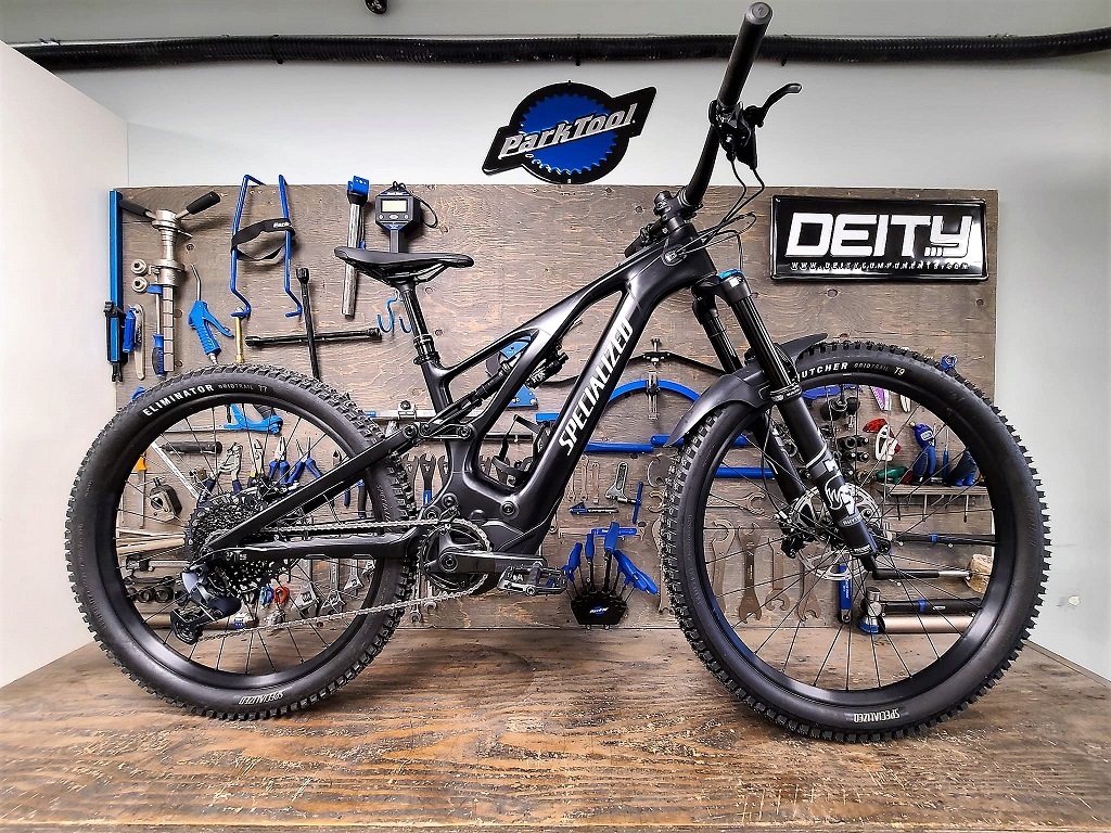

Owner of a Gen 3 Levo CC here. I don’t regret opting for a model with the larger battery as I do find myself in situations that require the added range. That being said, my reasons for acquiring the Levo with the bigger battery extend farther than just that.
Like Stefan, I also ride a Giant Trance and confess that the slacker Levo with the mullet setup, shorter chainstays and adjustable geometry appealed to me as a setup for more progressive riding. The alloy Trance in comparison is quite a bit heavier and nowhere near as nimble and maneuverable on tight twisty singles. On a single ride, I’ll do 35-40km of trails on varying terrain mostly blue and the odd black run and still have plenty of gas in the Levo’s tank. On a trip last year to Bragg Creek, a couple of buddies and I rode several DH runs and subsequently rode back up each time. One of them was riding a 2nd gen Levo with the bigger battery and was usually out front during most of the climbs. The other friend was riding the lighter Levo SL but was definitely feeling the burn on the rides up. I actually lent him the RE off of my Creo for that trip so that he would be able to finish. At least he could ride the more lightweight SL back if he depleted the battery. I didn’t have much juice left in the Trance’s battery by the time we completed the last run of the day and was wishing I had a bit more to alleviate any fear of having to crank that heavy beast back to base.
The range calculator doesn’t factor in variables such as trail conditions, extreme temps, rider position, etc…so it’s best to use it as a general guideline.
If you can spring for it, I say go for the comp as it will upgrade the spec’d groupset to GX as well as get you the larger battery. Take it from me, it’s always good to have backup when you need it the most.
