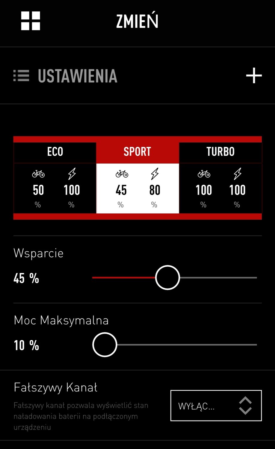

Your app is broken. Just look at the letters randomly thrown out here and there. Makes no sense :D ;)

English is actually my second language and, for example, my Windows is in English same as Microsoft Office etc. I keep Polish on my smartphone for a single reason: the car GPS navigation. It is the most safe if I vocalise my destination to the GPS app, such as "chrząszczyżewoszyce powiat łękołody" :D If the smartphone were in English, the app wouldn't understand what I was saying! :D
Unfortunately, it affects all Android apps. The MC is badly written. Not only the font is wrong but also automatic translations from English make me laugh... Yet, the MC works.
