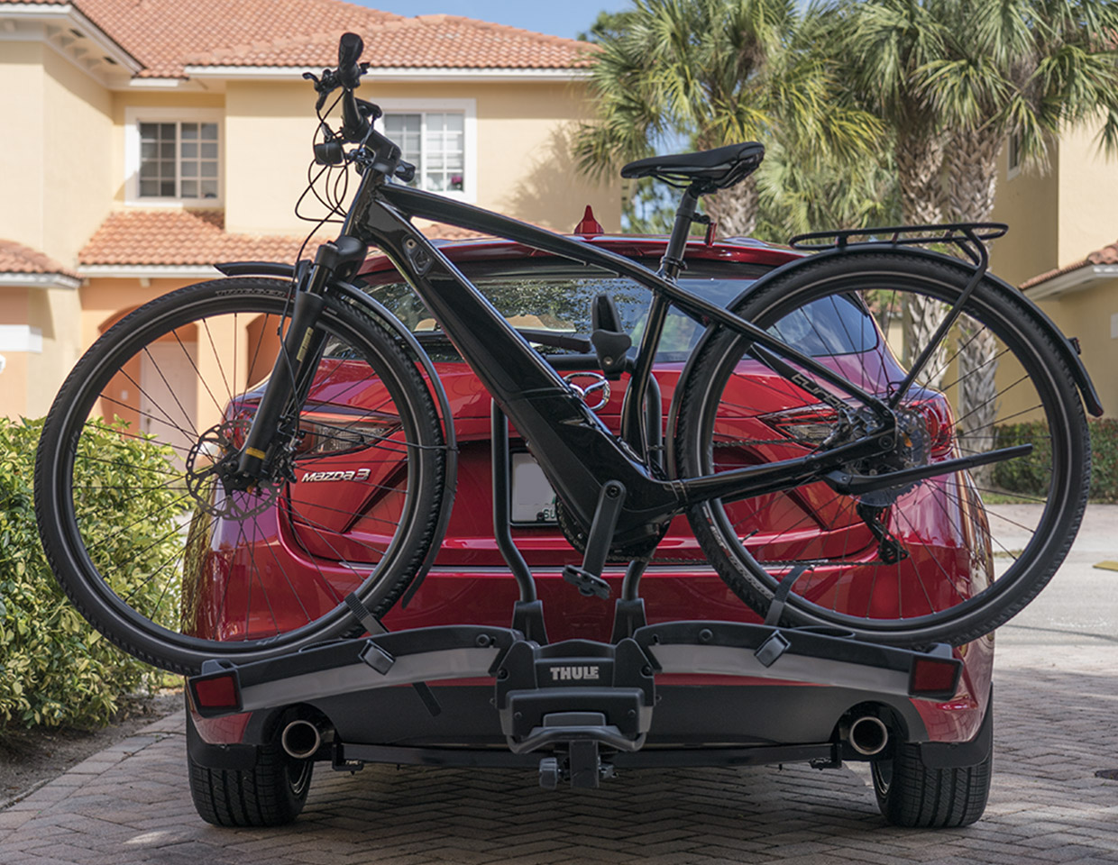

Speaking of racks....in early January 2020, I bought a Thule EasyFold XT 2 from an online retailer at 20% off the regular price of $749 U.S., the day before the regular price was hiked by $30. The Thule is heavy at around 45 lbs / 20 kg, but feels extremely sturdy. About the same time, I purchased a Draw-Tite Sportframe hitch tailored to fit my 2018 Mazda 3, which I installed myself. The hitch has a 200 lbs / 90.7 kg max weight capacity. The 2020 Vado 5.0, that I bought in mid-January 2020 and which is my first e-bike, fits securely on the Thule and the Thule into the hitch. I've only hauled the Vado on the Thule a few times and no more than 16 miles / 26 km, one way, to local bike shops and have had no problems, although adding all that additional weight on the back of my Mazda significantly lowers my mpg. I took the attached photo a few weeks ago in late January 2020, prior to making a few modifications to the Vado. The photo shows the Vado almost fully secured to the Thule, minus the Thule securing arm on the seat tube and a cable lock running through the wheels.
That's the rack that I was talking about in an earlier post, which we've been using for my wife's ebike (and my future Vado). By the way, what's holding the bike upright in the photo if the arm isn't clamped to the frame?
The bike was leaning against the U-shaped, upright support on the Thule. Plus, I had already attached one of the Thule's wheel securing straps around the Vado's front tire. The wiser way is to first attach the Thule's securing clamp to the bike's seat post. Then secure the bike's front and rear tires with the Thule's wheel straps.
As an engineer, I always appreciate products that show clever engineering such as Thule products in general and this rack in particular. I've found that in order to mount the 2nd bike on the rack, it's necessary to remove the clamp arm altogether and then pass it thru the frames of the bikes and reattach it, per the photo. Fortunately this is really easy to do. Once I get my Vado, I'll probably rig up some sort of "safety strap" so I can loosely tie the bikes to the upright as extra insurance in case the clamp should fail.
