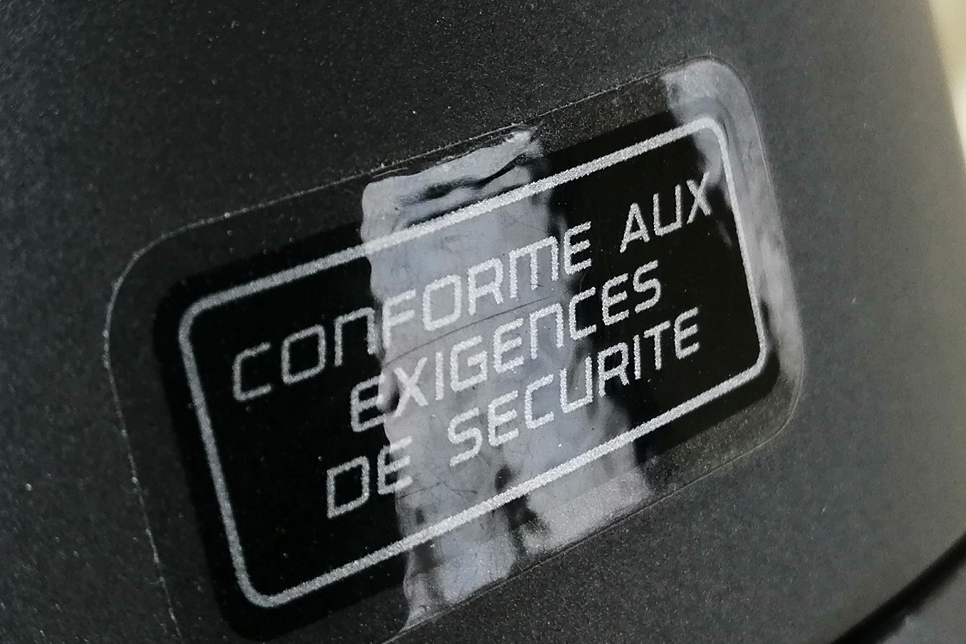

I'm currently on a ride with my Vado . A female driver almost caused an accident. She was signalling left turn while she drove ahead! I admire the quality of Vado's brakes. Be prepared!
P.S. A Canadian conformity label?

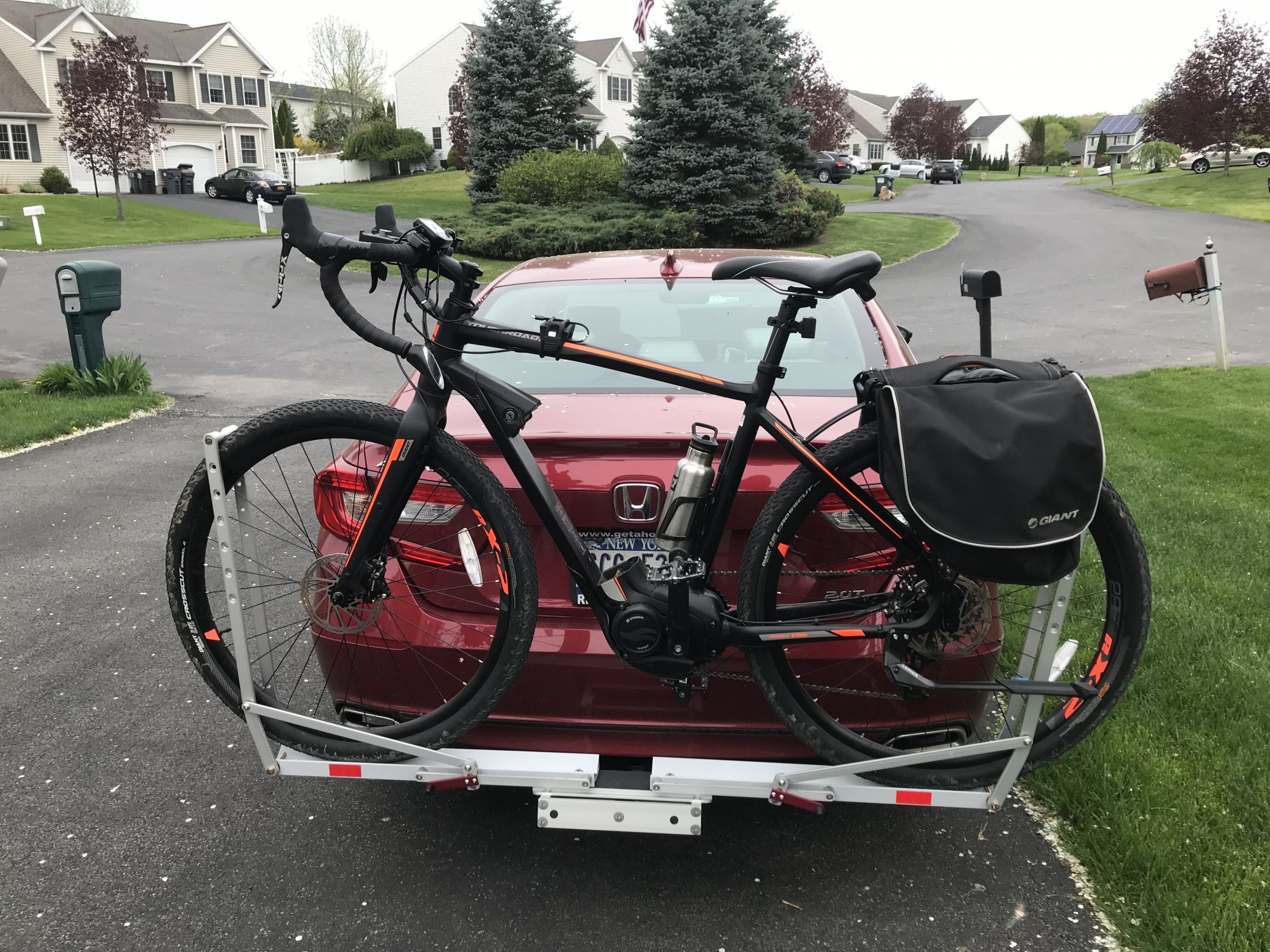

Looking at how far back that rack support structure goes, I have to back off the 1 Up. The support arms want to be a little more upright. You certainly don’t want anything happening to that nice bik
I've had both the Thule and Kuat Rack : And they are great Racks : But the 1Ups are super solid : This Picture is slightly deceptive If you are worried you can purchase for $15.00 a Rod that fits in those spacer holes that locks the Bike in place : They are meant as an additional Security feature> But also make teh Bike Impossible to fall out : Which it wouldn't as Pictured :
I actually have this rack and have loaded up to three Bikes : This rack locks into the tongue : I could stand on that rack pictured and jump up and down on it. That bike isn't going anywhere : Plus it's Got an adapter for Fenders : For that matter My Thule was plenty Good : I sold it on Ebay and Bought this 1up because My wife can pick it up : The Thule is Far Heavier : I am speaking from Experience : Not a Picture that doesn't reflect how stury that Bike is in there.
Plus you can lay those supports down and lift a Heavier Ebike Into place far easier then any rack I have used. Which is Several . As I am not always the One Driving to a Location :
On a Vado if you felt the need You could pull down on the Front end and slide that support up farther : Of course your shock would be compressed to that degree :

I am not looking at a picture and making a decision on car racks
we have four cars, 3 with racks on them full time, 2 of them 1up racks and I have owned approximately 9 different ebikes
after using the 1up racks I would not pick them for anything that has a long rear fender and a rack
it screws up the fender and scratches the rack if you run into it
One that holds on the frame is just easier for this type of bike

I have the fender cushions and they don’t do much, they also screw up the fenders if you tighten them down good
If you don’t tighten them down good and smash the fender then I suggest using wheel straps etc

I just looked at those pics and also would get a different car rack Than a 1up for this bike with the long fenders and rear rack

Speaking of racks....in early January 2020, I bought a Thule EasyFold XT 2 from an online retailer at 20% off the regular price of $749 U.S., the day before the regular price was hiked by $30. The Thule is heavy at around 45 lbs / 20 kg and feels extremely sturdy. About the same time, I purchased a class 1, 1-1/4 inch opening, Draw-Tite Sportframe hitch that is made to fit certain Mazda 3 model years, including my 2018 Mazda 3 hatchback. I installed the hitch myself, which was challenging but doable....in my case, about a 20 to 30 out of a possible 100 expletives job.
The hitch has a 200 lbs / 90.7 kg max weight capacity. The 2020 Vado 5.0, that I bought in mid-January 2020 and which is my first e-bike, fits securely on the Thule and the Thule into the hitch. I've only hauled the Vado on the Thule a few times and no more than 16 miles / 26 km, one way, to local bike shops and have had no problems, although adding the additional weight of the Thule and the Vado on the back of the Mazda noticeably lowers fuel economy. I took the attached photo showing the Vado on the Thule in late January 2020, prior to making a few modifications to the Vado. The photo shows the Vado almost fully secured to the Thule, minus the Thule securing clamp on the seat tube and a cable lock, as an added theft deterrent, running through the wheels. The other photos are from the day of the hitch install.
