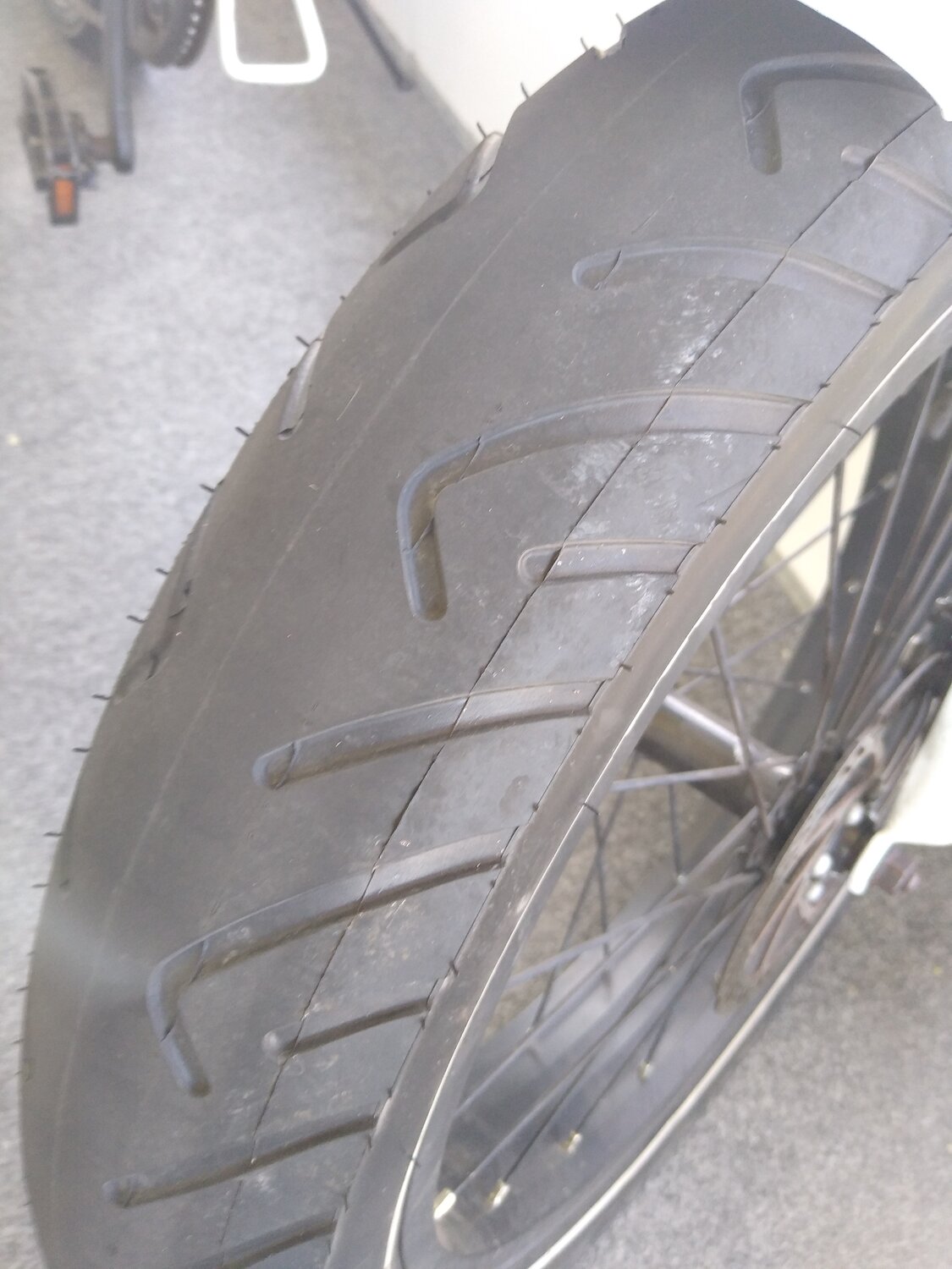

here's some slick ones i found on amazon

Hi Folks!
I use these Motorcycle tires on my 2021 OG XP 1.0 (The final batch) (AKA- Dual motor Racer-X signature series)... And they are awesome!
BoomChick is on the right track. They're very quiet.
I didn't need too much extra pressure to put them on either
As mentioned, I run the dual motor set up so the extra weight is no issue at all.
I had been running Tannus armor but they unbalanced my front hub motor so badly,
I had to keep my hands on the bars or the front end would shake horribly...
Now with the new tires...And the Tannus out, no hands is no problem and I have zero fear of flats.
They are rated for speeds beyond my bikes capabilities and should be the last set I need to buy for many years.
I also added tubes with threaded stems to hold them in place!.. Awesome!!
I ride paved bike paths, streets and dirt trails..
Cheers everyone!!

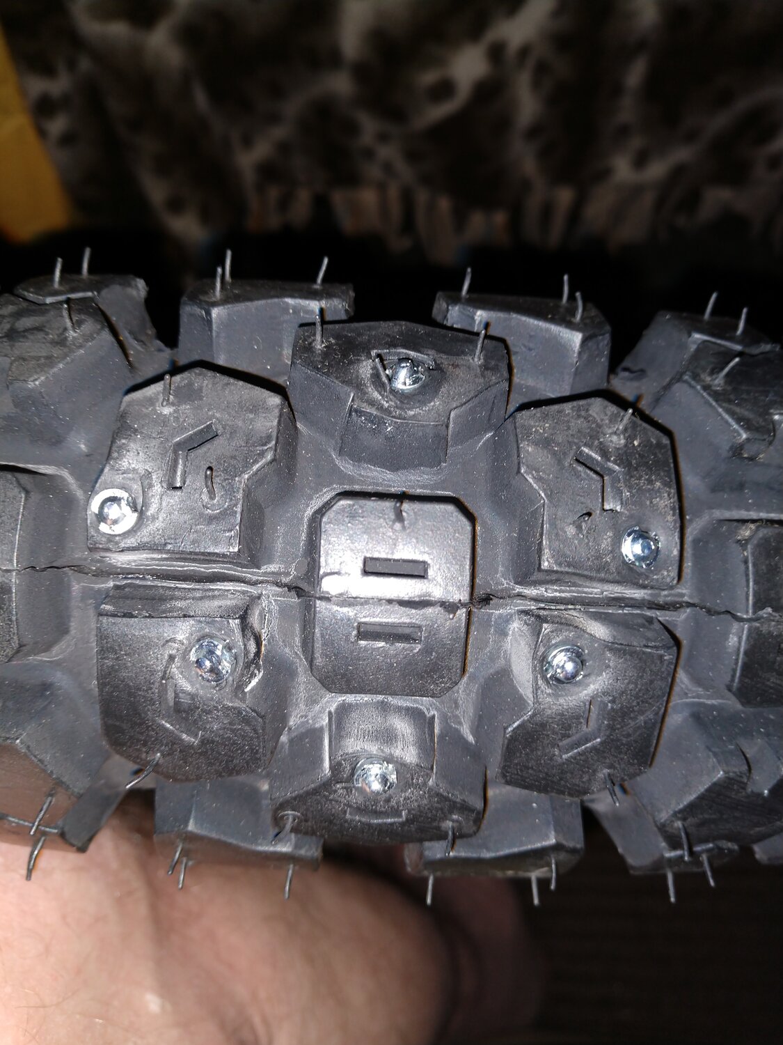

Studded my 3-16 motorcycle tire for Minnesota ice and snow
