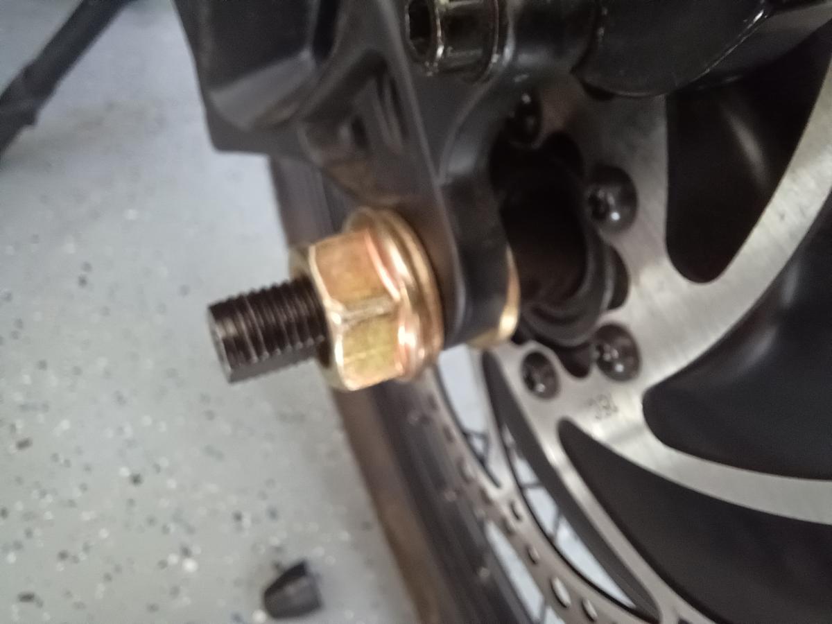

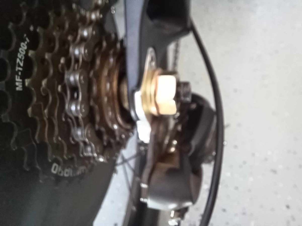

Do you still have the bike? I have seagull with rear wheel removed...but forgot to take washer pics on eith side of rear axle. Can you please send me pics on either side so I can assemble it back? Thanks in advance.
Yes but they are at our vaca home. I will be there this weekend and take pics
Just saw the pics aren't very clear. I can redo them them if you need
