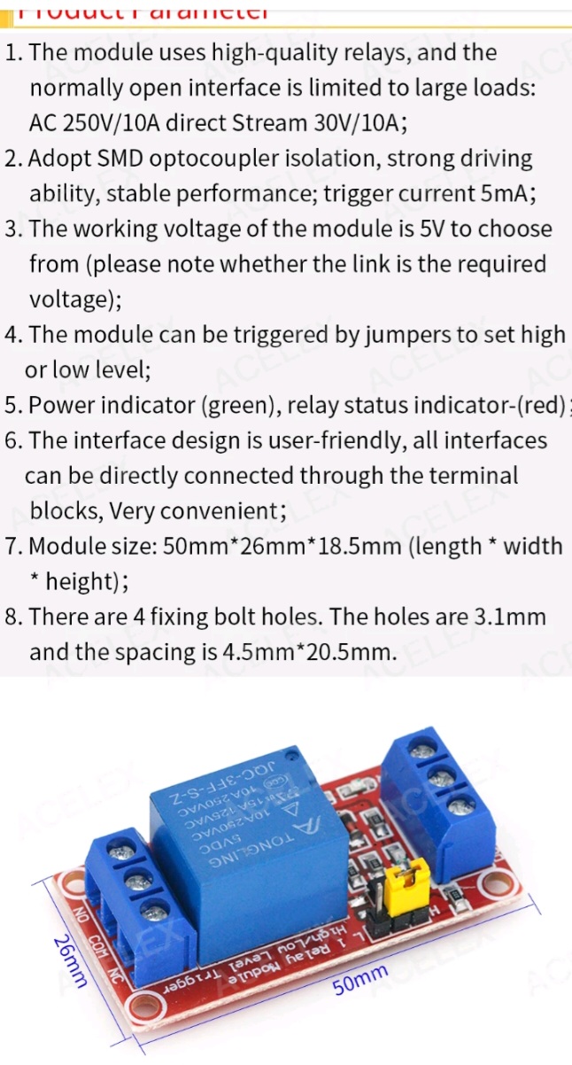

That splitter cable is operating at 5 volts or less with very little current available.

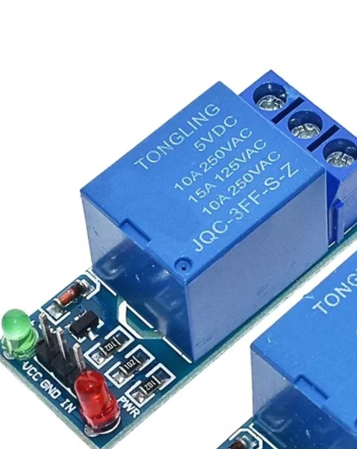

There is no way it could power a brake light, but it should have enough power to activate a relay.
The only way to connect a brake light is with a 5 Volt relay switching the 36V or 48V power feed on and off.
The trigger current if this relay is only 5 mA.
