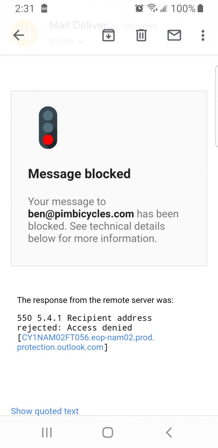

Today i learned they are discontinued and parts are not available, i need a battery after one year and 2000 miles my $1700 bike is worthless.
Not aware that PIM has gone under. Did you contact them directly? Second; the batteries are made up of cells so I am thinking that there are ways to rebuild them.
I talked to Ben the tech today, he told me i was SOL. They have my battery in Seattle. I dont even know if they will send it back to me, the tech blocked my email.42431
I talked to Ben the tech today, he told me i was SOL. They have my battery in Seattle. I dont even know if they will send it back to me, the tech blocked my email.View attachment 42431
If it is your battery you should demand that they return it even if it is not repairable by them. I would suggest that you volunteer to pay the return shipping to get the battery shell back. I believe you can find repair/rebuild battery shops that can replace the Lithium cells and other components. Please post your experiences so the rest of us can now what to expect.
They are currently trying to find one to replace mine with.
Pim bicycles has not gone under, they claim my bike is using 2014 technology and want to move forward.
