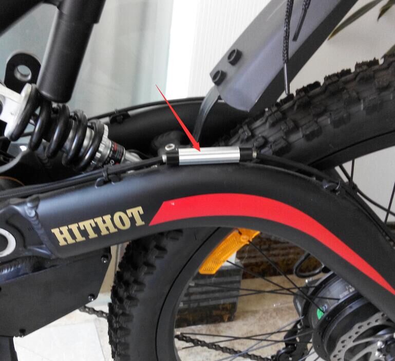

The "Error 25" issue is a well known problem and we are working on it to improve the mistake for future bikes. "Error 25" means a brake problem. When the brake is used, the controller will cut acceleration. That is probably why you do not get any response from the motor. It is actually easy to handle. Most of the time it is the sensor that is a little lose. You find it near the rear wheel, as you can see on the picture below.
Please try to fasten the sensor. The Error should not appear again. If nothing changes, please let us know, then we will give you more options.

Simple! Fixed and I can be out and about again.

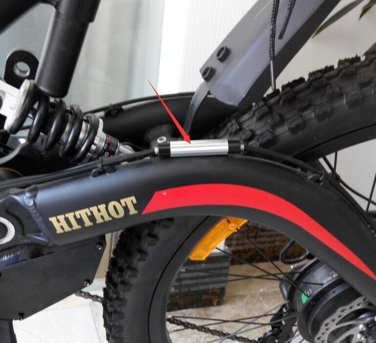

The sensor was not the problem it was the connections inside the black box. The wire loom around the sensors port faded off and I bet a drizzle of water touched it. Removed. Rewired, new harness connectors. Done. Ive taken electrical class's. Thanks again!
Thank you for your reply and your hint with the black box connections. Of course the Error 25 can have a lot of reasons, but the best known is that the sensor is lose. But we will pay attention on the one you told us from now on.
